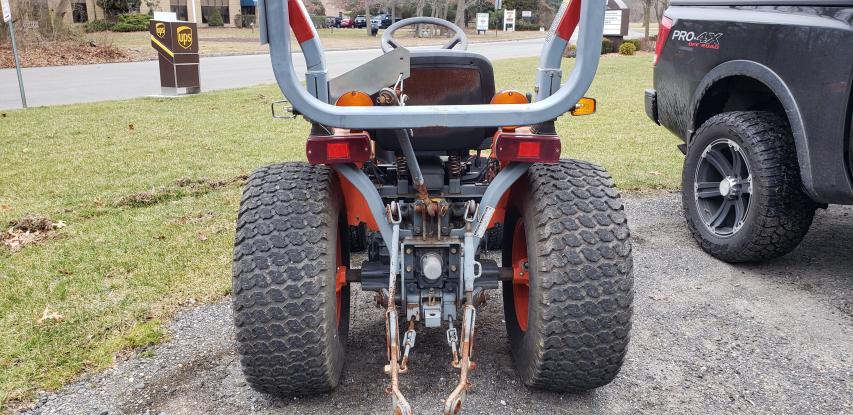

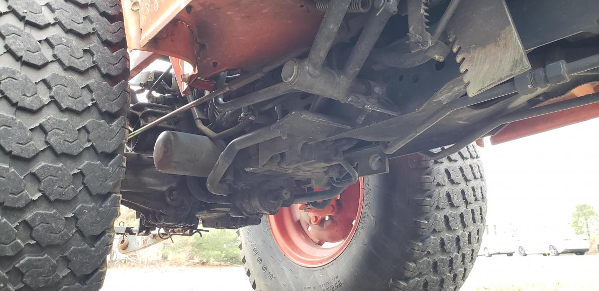

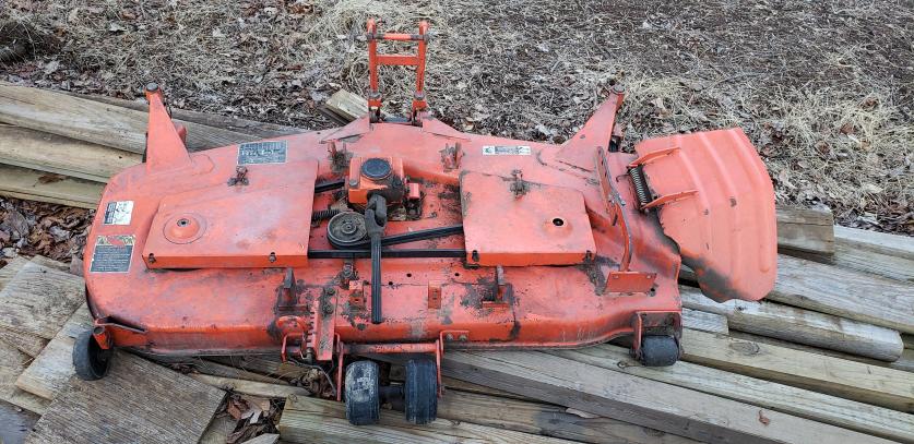

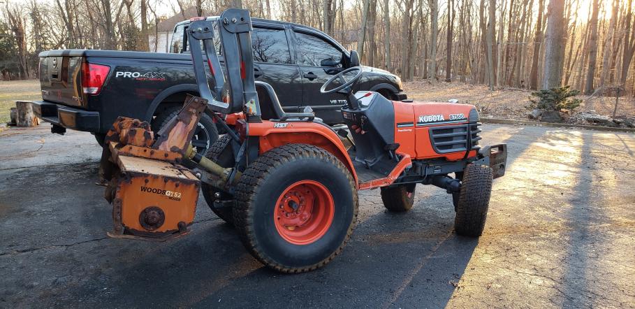

Hi All
I just purchased a used (640hrs) 2003 b7500 HST, Its my first real tractor and I intent to use it as a mower and general maintenance around my 5 acre property. This was my intention but I think I have bitten more than I can chew. I bought the machine very locally for a little over 5k. It was only used to tow around a aerator for a lawn company the PTO and hydraulics werent even used, so I initially thought I got a good deal. Fast forward a couple of weeks and after the purchase of a used Mower deck without tractor side hardware, a very used tiller and a totally fruitless search for a used loader I realize that it wont be so easy to outfit this little tractor to suit my needs. I came across this forum and decided to write in case a kind person can help out with a couple of questions and/or decisions.
First of all I need to ID the deck so I can look for the right mounting hardware. I will try to upload pictures for everything because you probably dont wanna read a thousand words!
Second I would like an opinion as to what to do next with this machine. Do I pay another $600-$800 to get the tractor side brackets to hook up the deck? do I keep looking for a loader or shell out 4k to the dealer for a new one? (LA302) or maybe sell this all together and buy a new one with a loader already in place? I would appreciate your help in Identifying the deck in the pictures and your opinion on what to do next. Thank you

I forgot to mention that the only sticker on the deck reads a number K5763-41191 which I think fits the 4 model decks listed below:
RCK54-24B (54" MOWER DECK)
RCK60-24B (MID-MOUNT FINISHING MOWER)
RCK60-27B(A) (60" MID-MOUNT MWR / B7800 / B3200)
RCK60-30B (MID-MOUNT FINISHING MOWER)

Welcome to the forum. Looks like you have a nice tractor. I did notice the hyd filter in the picture appears gray in color. If it is that indicates it's probably the original filter, and if so needs to be changed out with new hyd. oil. Be sure to purchase the correct oil, not some on sale stuff at the local tractor store.
spiro - My tractor is a 2003 B7500 HSD-R and my MMM is a RCK60-24B. I bought it new in 2003.
According to the Operator's Manual for the mower, the RCK60-24B, RCK54-24B and the RCK54-75B will all fit the B7500. Your MMM looks like my RCK60-24B. It does NOT look like a drawing in the manual of the RCK54-75B.
The total width of the RCK54-24B is 66.7". The total width of the RCK60-24B is 74". Measuring the total width of your MMM should be able to eliminate one of the 24Bs, but that will not positively ID the MMM, as Kubota MAY have other models that resemble the 24Bs. It looks like the 24Bs share the same mounting hardware.
Do you have the coupler half of the mid PTO shaft? I don't see it in your photo.

@Rusty46 good eye bout the shaft coupler! that f..n part which I dont have is $400.00! prob just as much of the rest of the hardware all together!
I will now walk through the damn snow and go measure the deck. I myself think it might be a rck60-30b cause the rck54 s have a plate in front which mine doesnt...see pic. I will let you know the measurements soon. BTW whats the second set of numbers anyway? 30b, 24b, 75b etc..

Ok deck measures aprox 63" by aprox 29". 63" is to the end of the deck, Not the flap.

Hmm...maybe I can answer my own question. Maybe the second set of numbers -xxb is the front to back measurement in inches, in which case I might have the -30b!

Your deck is a 60" version. It's a good deck but you are missing just about everything that you need to install it. Buying all of the needed parts to install it will be cost prohibitive and finding all of the parts used will be just about impossible.

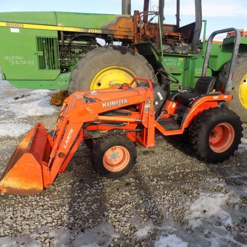

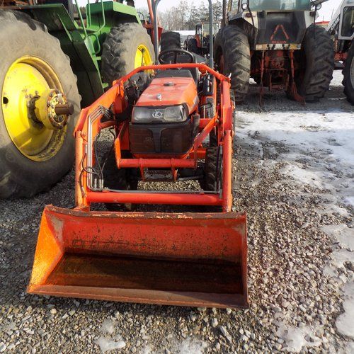

Ok I just thought I would update everyone on the recent developments in case anyone finds it useful.
I just bought the LA272 pictured below. It should be here in a week or so. I read up on it a little and it looks like its not much different than the LA302. 60lbs or so less capacity and no front grill. Looks like I could fabricate the grill if need be and maybe increase the pressure to match that of the LA302. Not sure if the loader is fully functional but I was told no pitted cylinders or leaks. Comes with everything needed to attach, even the hydraulic block. Paid 2200 all-in with shipping. Still no idea of what kind of MMM/deck I have. Confused by rusty46 measurements due to the fact that it looks like decks shorter than mine are bigger front to back??? I will have to re-check my measurements in case Im blind!.
@ DST ...I found the receipt for the hydraulic filter change two times at the dealer where it has been serviced since new. Not sure why it looks grey, haven't called them yet. I appreciate your advise but the tractor feels pretty tight and not abused. Also the deck is like you said most likely 60" but need to ID a model number in order to look for the mounting hardware.
@Russel King....I would love the pull behind mower but I have some hill spots and some trees I need to go around which would be harder to do with the recommended setup. If anything I would like to get a flail mower but will try for a little while to see if I can score some reasonably priced mounting hardware for my deck. Looked at a rear mount bucket but I'm not poor (just kidding) I am....and it looks like it could out perform the FEL in capacity but I found this FEL at a tractor salvage place and couldn't resist.
Thank you for your help and if any one can positively identify the deck I would appreciate it. Also any advise on installation of the loader would be very valuable.
I will post pictures when I get it installed.

1. Be careful when mounting and unhooking the loader. I had a B7500 for 10 years and the dealer told me that mine was one of the few he saw that didn't have a crease in the hood from the crossbar of the loader frame.

spiro - The dimensions published by Kubota are for the assembled MMM, including the front and rear wheels/rollers and the discharge chute in the down position. My RCK60-24B deck (sheet metal pan) bare is 63" wide by 32" long (front to back). Also, the "24B" portion of the model number does not represent any physical dimension, of which I know.

chim - My hat is off to you, Sir! I tried to dismount the loader on my B7500 ONCE without first putting the legs down, and I earned my "CREASE OF SHAME". I was old enough at the time to claim a "senior moment", however that crease is always right there in front of me, smiling at me as a reminder of my operator error.
