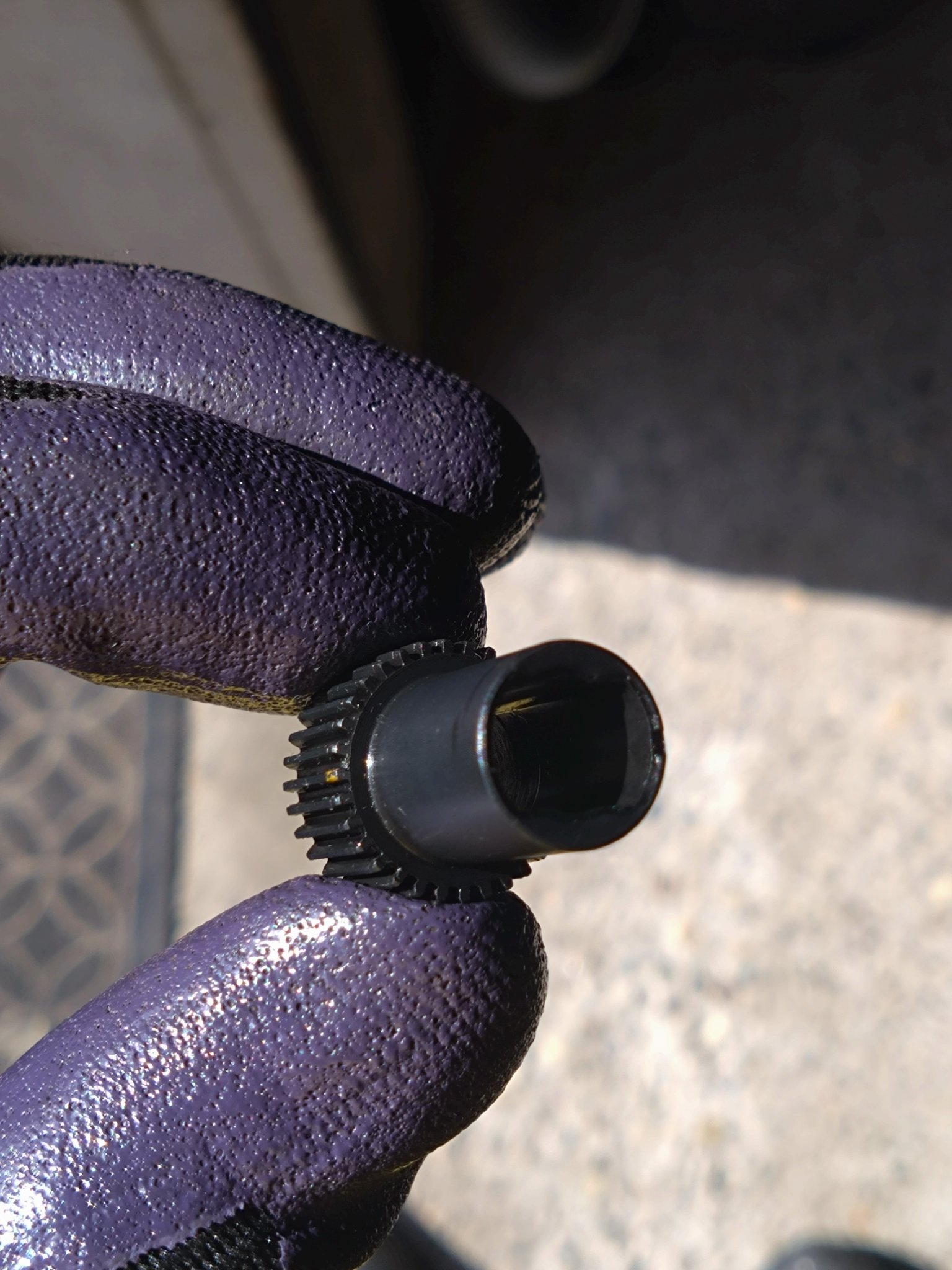

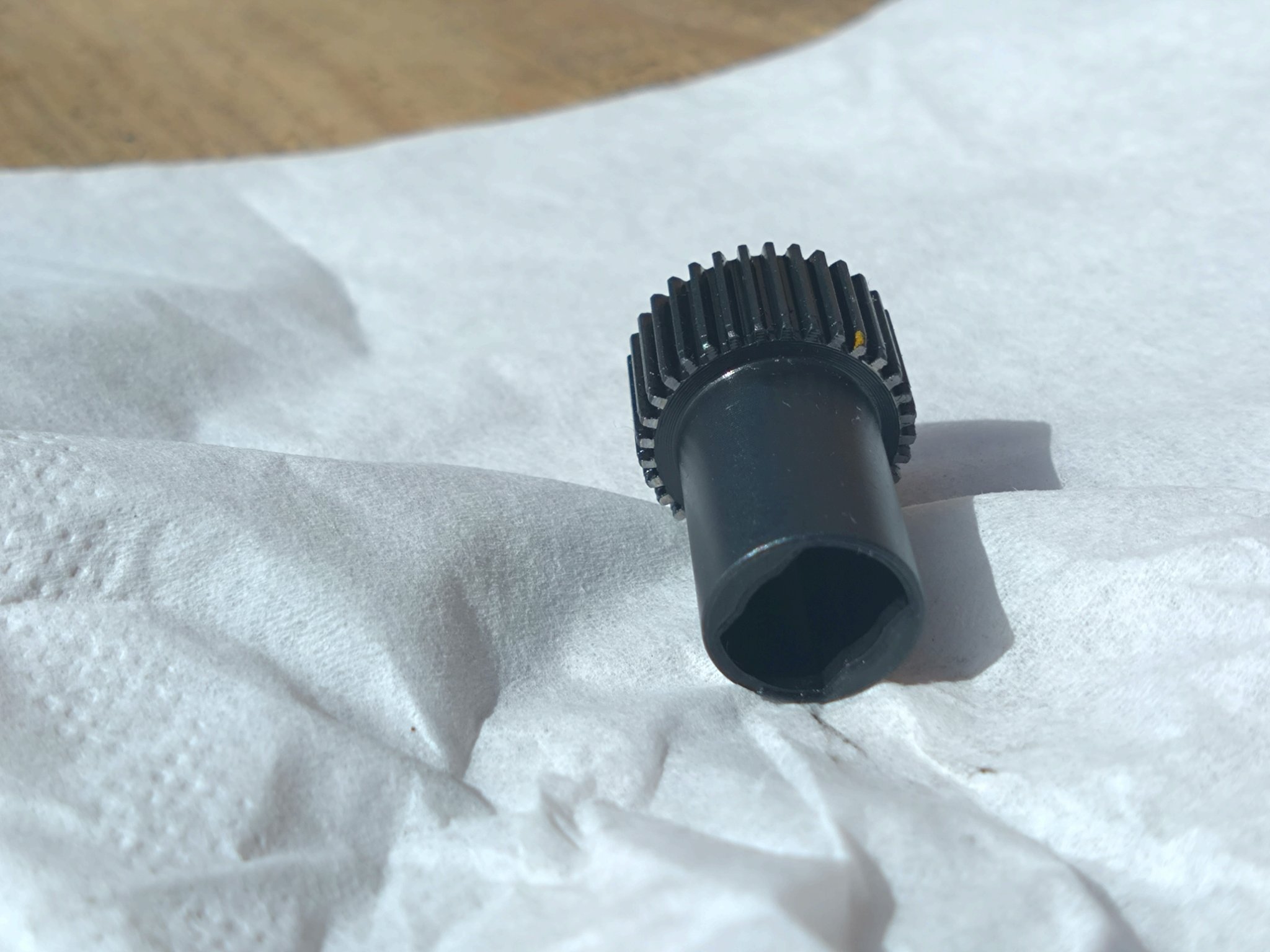

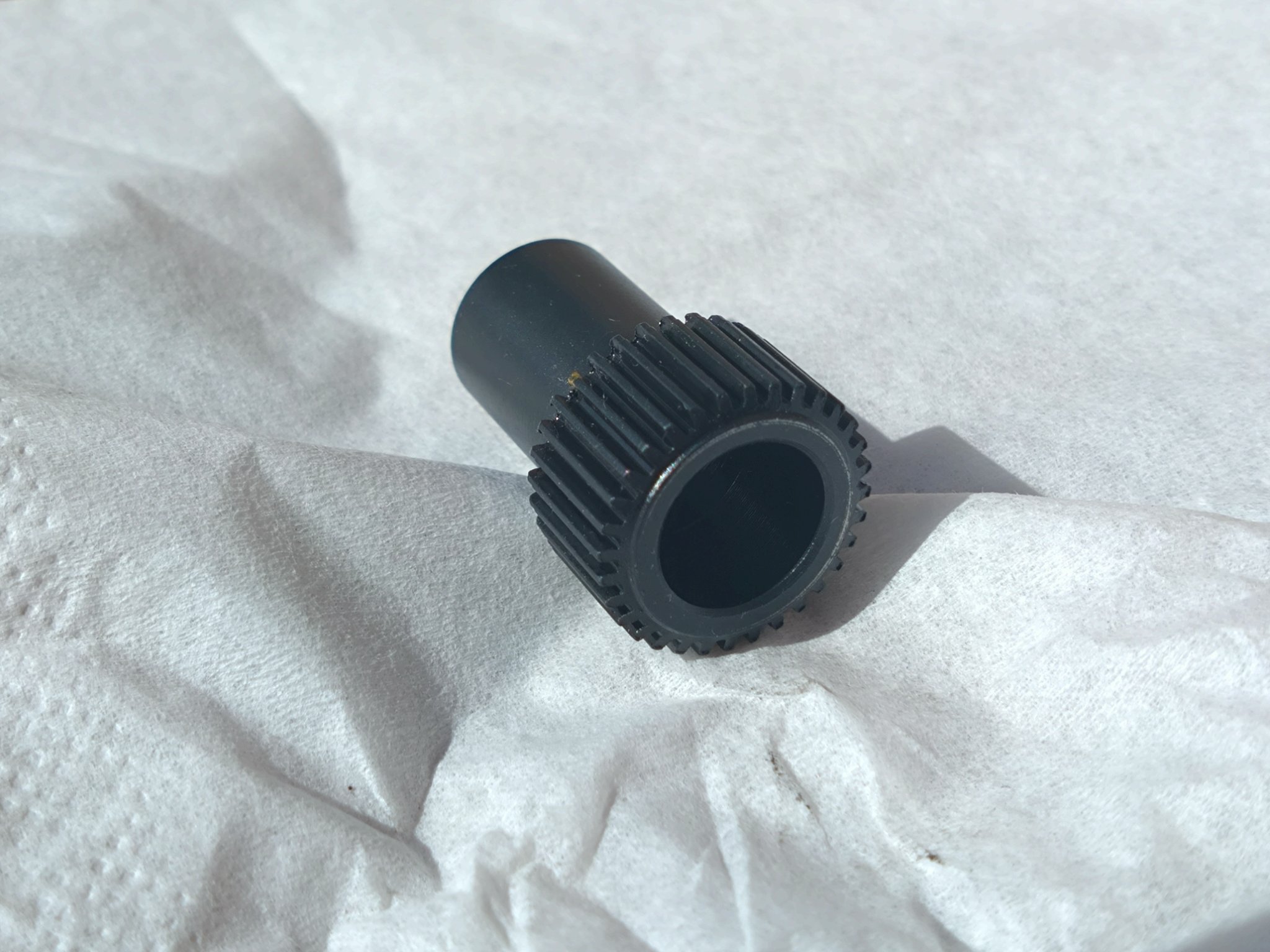

I will again revive this thread, now with a question. After waiting ages for parts to arrive I'm now finally rebuilding the pump. Upon reassembly I found that the punch mark on the control sleeve is missing. So I have no reference to align it with the control rack. Guess it has worn off.
Anyone any idea? Does it line up with the V notch with which you align the plunger? Not keen on finding the correct timing by trial and error as you may understand...
28,971
5,318
There has to be a mark on the gears or you can not align it.
Take some pictures of the top and bottom of the gears.
I've done quite a few of these pumps and have yet to see one without the marks.

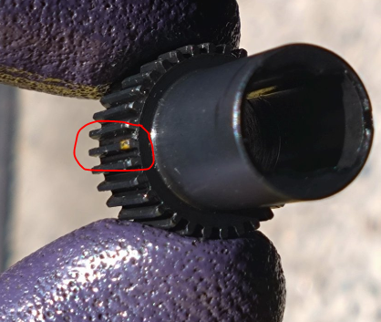

No mark visible on mine. But there is some kind of brown/yellow marking on one tooth of each gear. Thought it was maybe bit of rust but its on the same tooth on every gear, and directly opposite of the v notch for plunger alignment. Seems to not be a coincidence.
Photo of the yellow mark:
28,971
5,318
Yes that is the mark to align to the notch in the rack.
