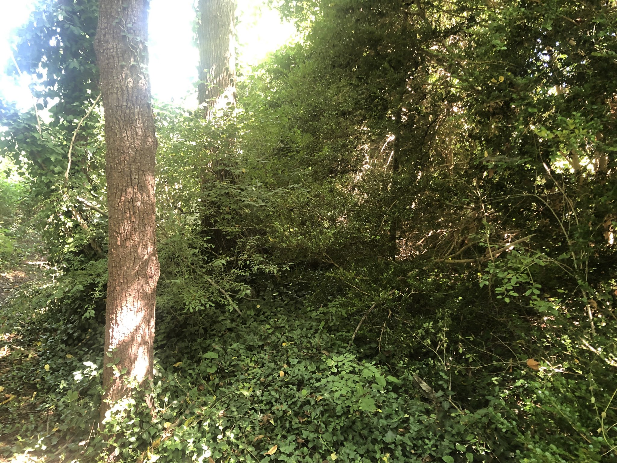

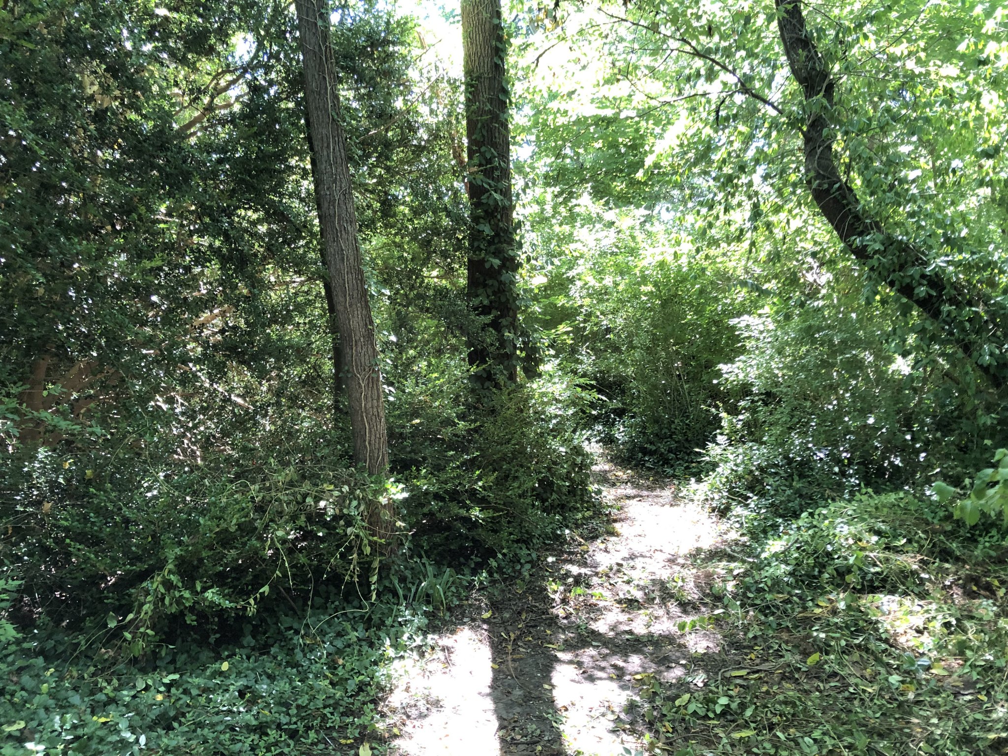

My wife and I are under contract on a property in town, we settle next week!
The property was abandoned for 40 years and is in major need of attention. There is an old 1800s farmhouse that we will be renovating over the next year +, while the contractor is out there working on the structure, I'd like to put some time into reclaiming the lot.
There are a lot of old-growth trees on the property we'd like to preserve: pawpaw, black walnut, persimmon, trifoliate orange, poplar, boxwoods (40+ feet tall!), dogwoods, redbuds, cedar, and many more I have yet to identify. The ivy and vines are strangling the trees though, and there are a lot of small saplings that should be removed as well. I'd like to cut a few trails through the back of the lot too.
I've been looking at the B2601 with the front end loader, rear finish mower, and a rotary cutter. I'd also consider a 3rd function and grapple, a box blade, and a land rake (this is all getting expensive haha)...
Is this tractor overkill for only 1.33 acres?? I am approaching information overload on YouTube, Reddit, Forums, etc. So many people just reference acreage when suggesting tractor models, "B2601 for 5-10 acres, BX for under 3 acres, etc..." - I'm assuming this means overall for fields, pasture, etc. 1 acre of woods can be more work for a tractor than 5 acres of fields, I'd imagine?
I'm going to a dealership next week to see the BX and B side by side. That might help me make a decision, but I would like some opinions to further overload my brain before I go!
The primary uses for the tractor:
Finish mowing the lawn (less than 1/4 acre)
Removing cut trees
Removing brush
Cutting trails
Hauling and spreading gravel for driveway
Occasional snow removal (we get a decent snow fall once every 5 years)
Hauling and spreading mulch
Hualing and spreading compost
Maintaining a vegetable garden
And of course, NOT pulling my nephew around in a wagon :)
Let me know what you think.
B2601?
BX2680?
Something entirely different??
Also worth noting, I visiting a John Deere and New Holland dealership already. I haven't fully ruled them out yet, but I'm leaning more towards the orange tractor now... I like the size of the B2601, and the BX for the value. I guess the test drive and dealer experience next week will be the deciding factor!
EDIT: adding photos to help visualize the property. It's hard to capture the extent of it, but there is a full acre of this level of growth...
