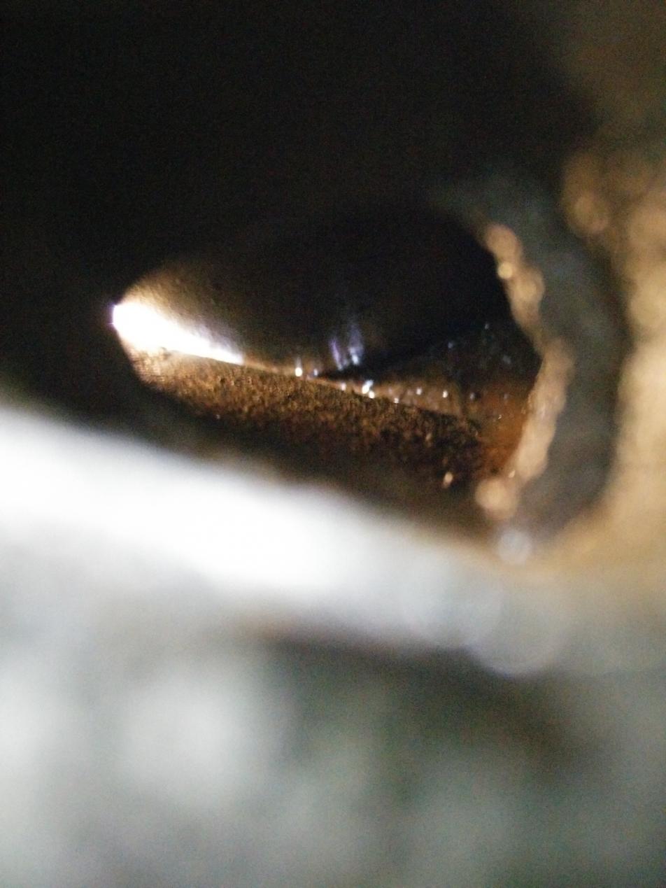

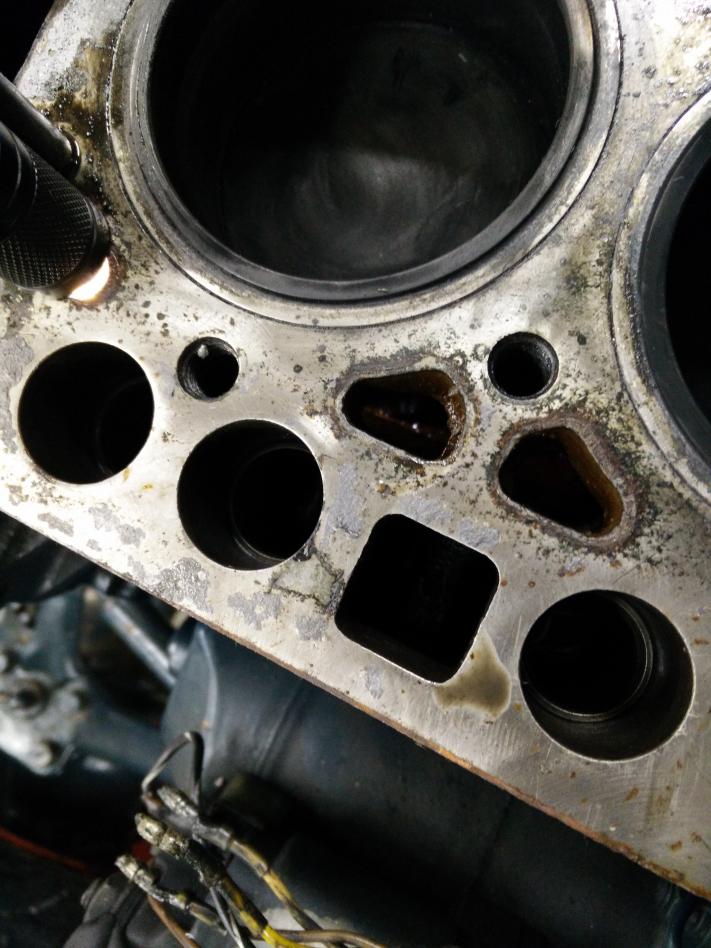

Indeed the liners are wet wet wet. There are several incorrect postings about the ZL600 liner construction. You can see in this photo as well. They don't get any wetter then this. They are just sealed with o-rings.
Since there were so many dry liner postings, I thought that maybe there was a dry sleeve version, but the parts list doesn't support that theory.
Wet wet wet, and easy to remove and replace.
