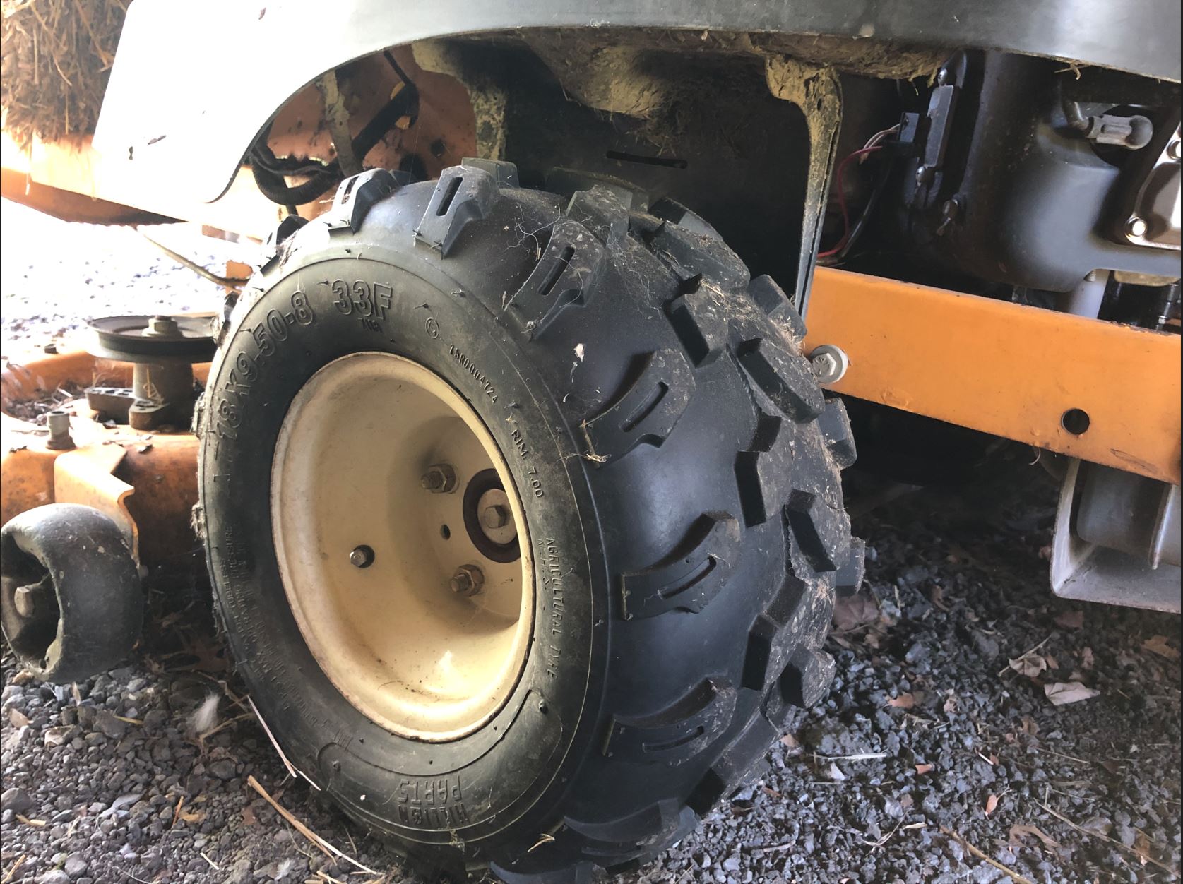

Did the same thing with my "beater" ZTR. I put ATV tires on it and it's damn near unstoppable when my property is wet. Just about any ATV tire will be better (traction wise) than lawn mower tires. You can also get them in heavier ply ratings.

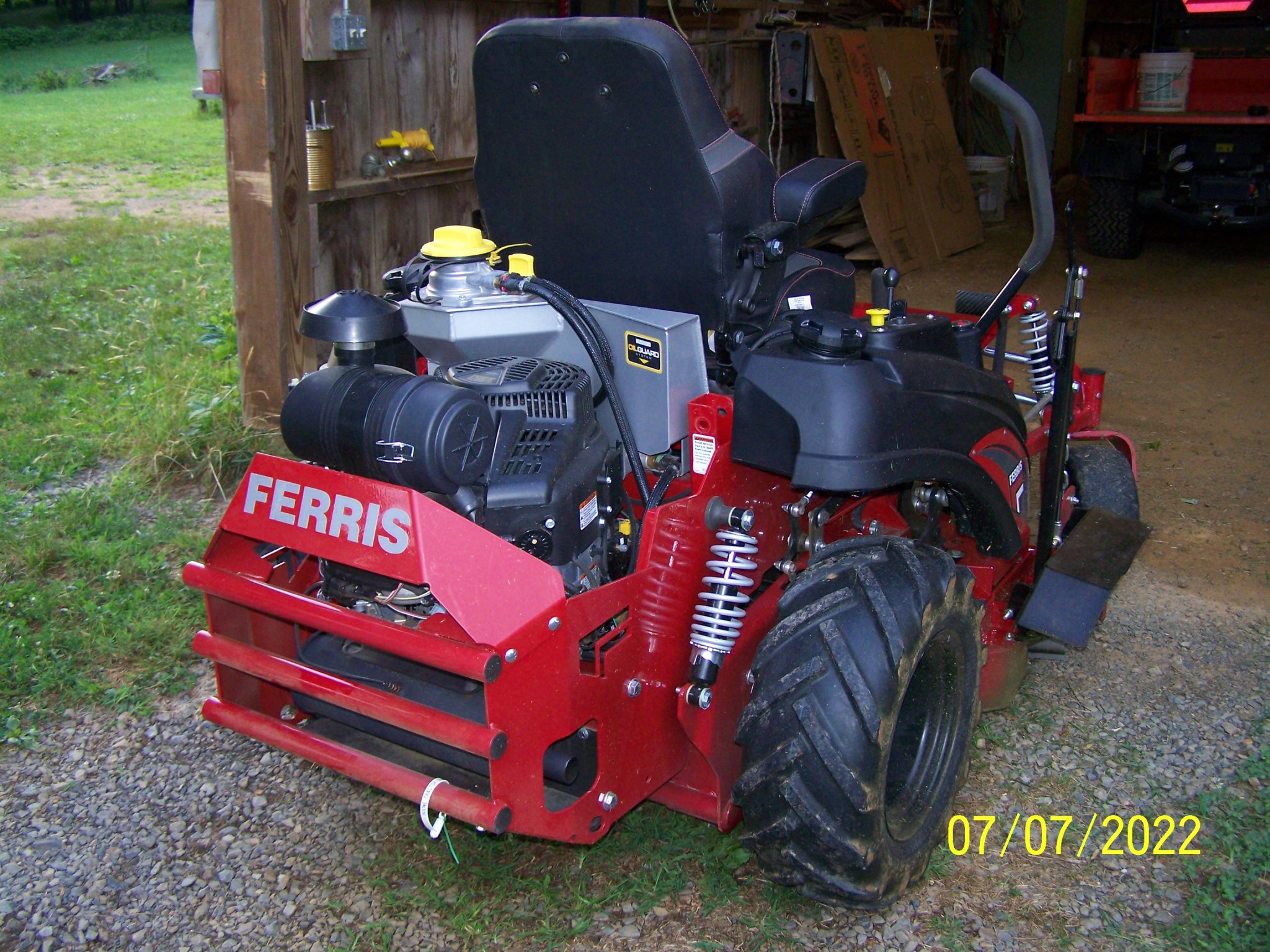

I recently purchased a new Ferris Z and went through the same tire selection problem. I ended up running chevron style tread, which is what I ran on my previous machine for 18 years. They work for me.
One thing I did learn is that the size printed on the tire is more like a rough guess.o_O I was told that tire measurements are taken at full operating pressure. I don't know if that's true but some tires I looked at varied in width and height measurements by 1 1/2 inches. Another thing to check is the load rating. Some ATV tires may have a rating around 400 lbs, while a similar size/ appearance tire may be rated for 1,300 lbs.
These are things you may want to keep in mind for clearance, cut height and safety. My machine weighs over 1,200 lbs.

Just so you know, I live in the country. My lawn used to be pasture, so I'm not as particular as someone with a manicured lawn.
I think the new tires were a big improvement over the supplied turfs. Side slopes that had been impossible with the turfs will sometimes suffer some damage with the new tires.
A short hill that I mow up and down could not be climbed with the turfs and going down used to be a slightly controlled skid. Now it's possible w/o skidding.
I read once that the advantage of four wheel drive was the ability to get stuck in more inaccessible places.
The places that I do some turf damage with my new tires are places that I couldn't even go with the turfs.
I can now mow close to my pond without sliding. I actually did damage with the turfs sliding sideways in the same spot. (That's what prompted my tire change. :eek::eek::eek:)
If you are careful and take reasonable turns you will be fine, if you really want to destroy your grass you can do that too. Just try a few power turns when the lawn is wet.:oops:
BTW, I sold my old mower (a Ferris 1000z, that has chevron tread tires) to my neighbor. He is happy with the tires and has no plains of changing to turfs.
