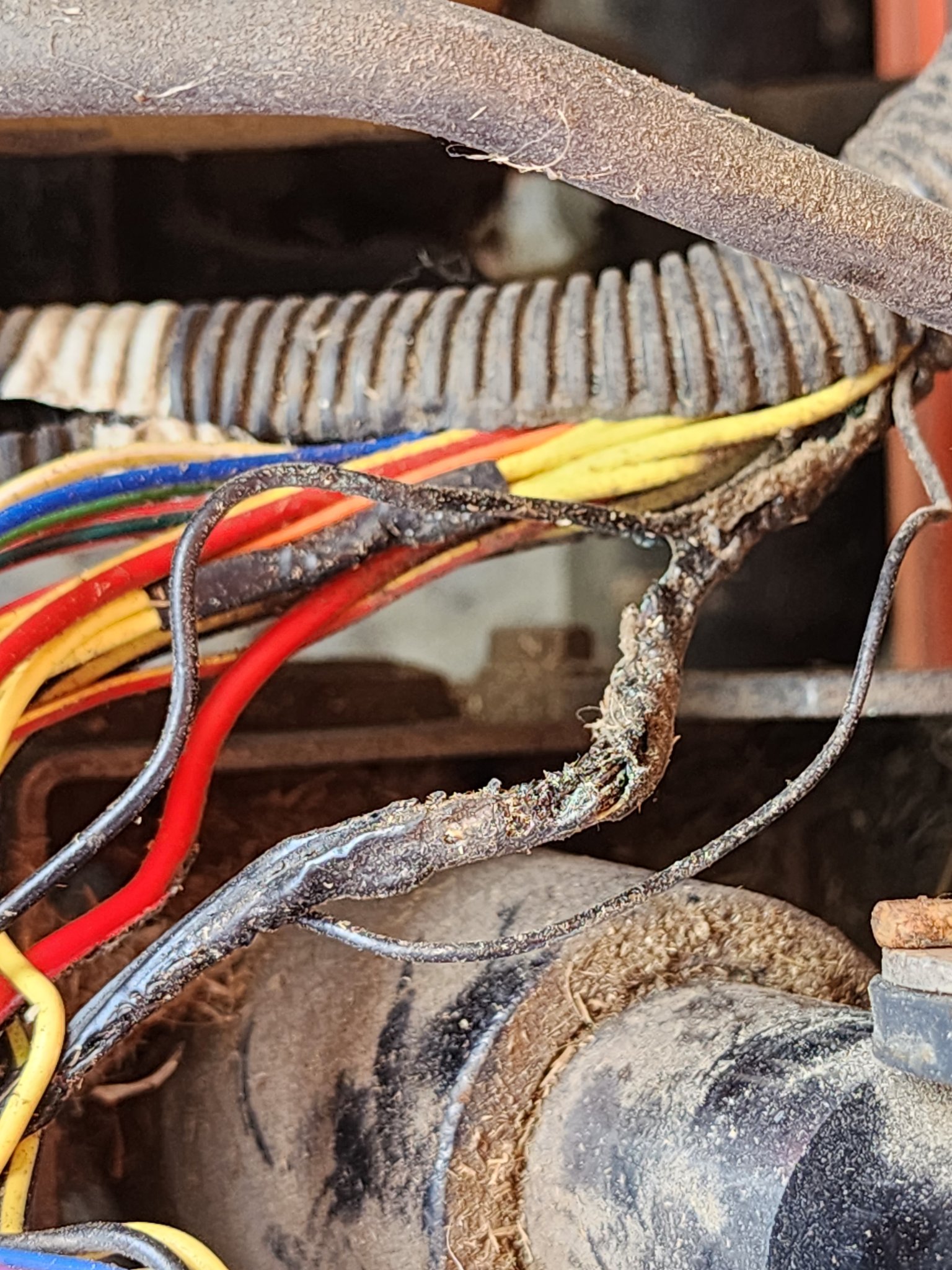

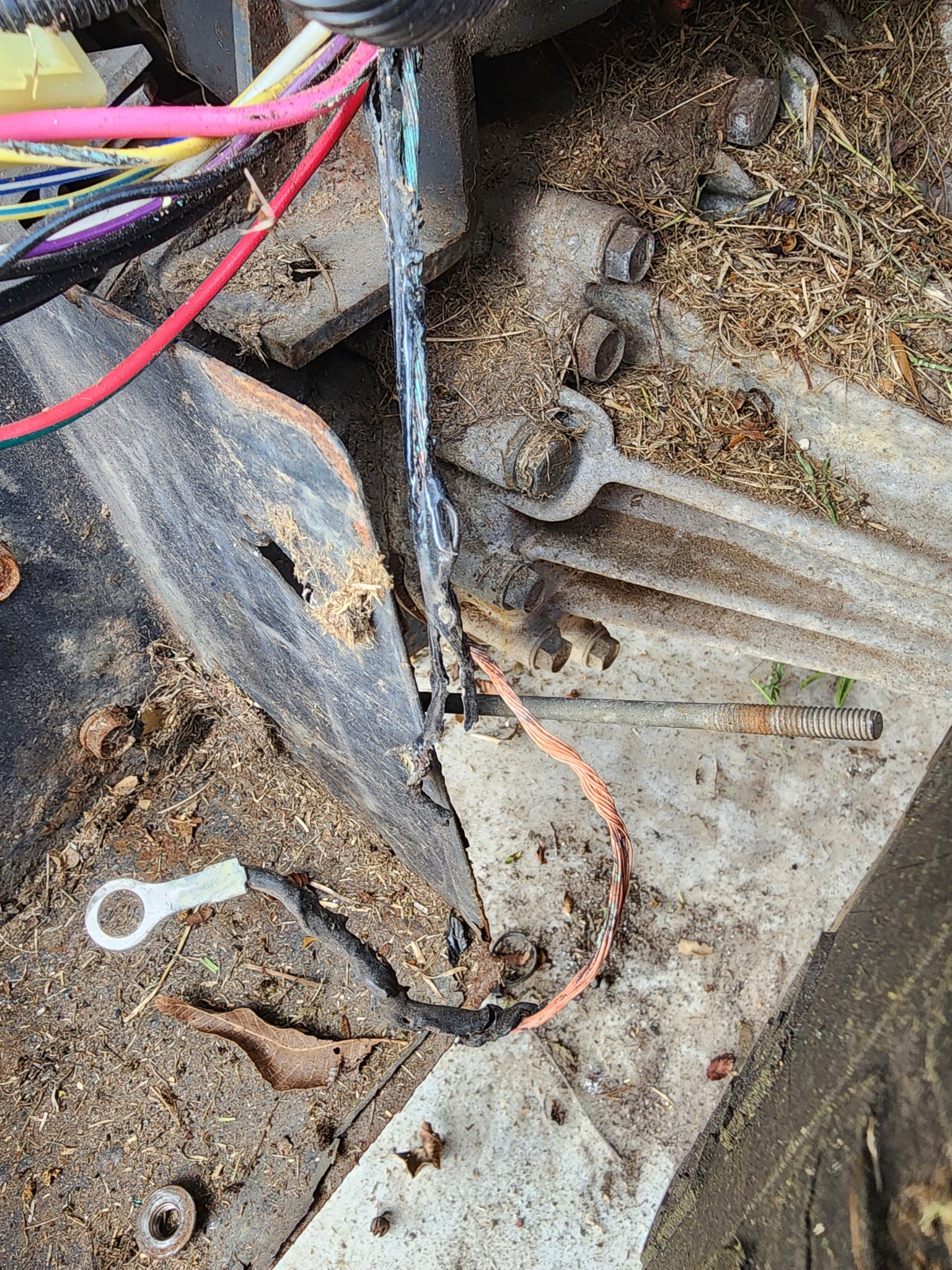

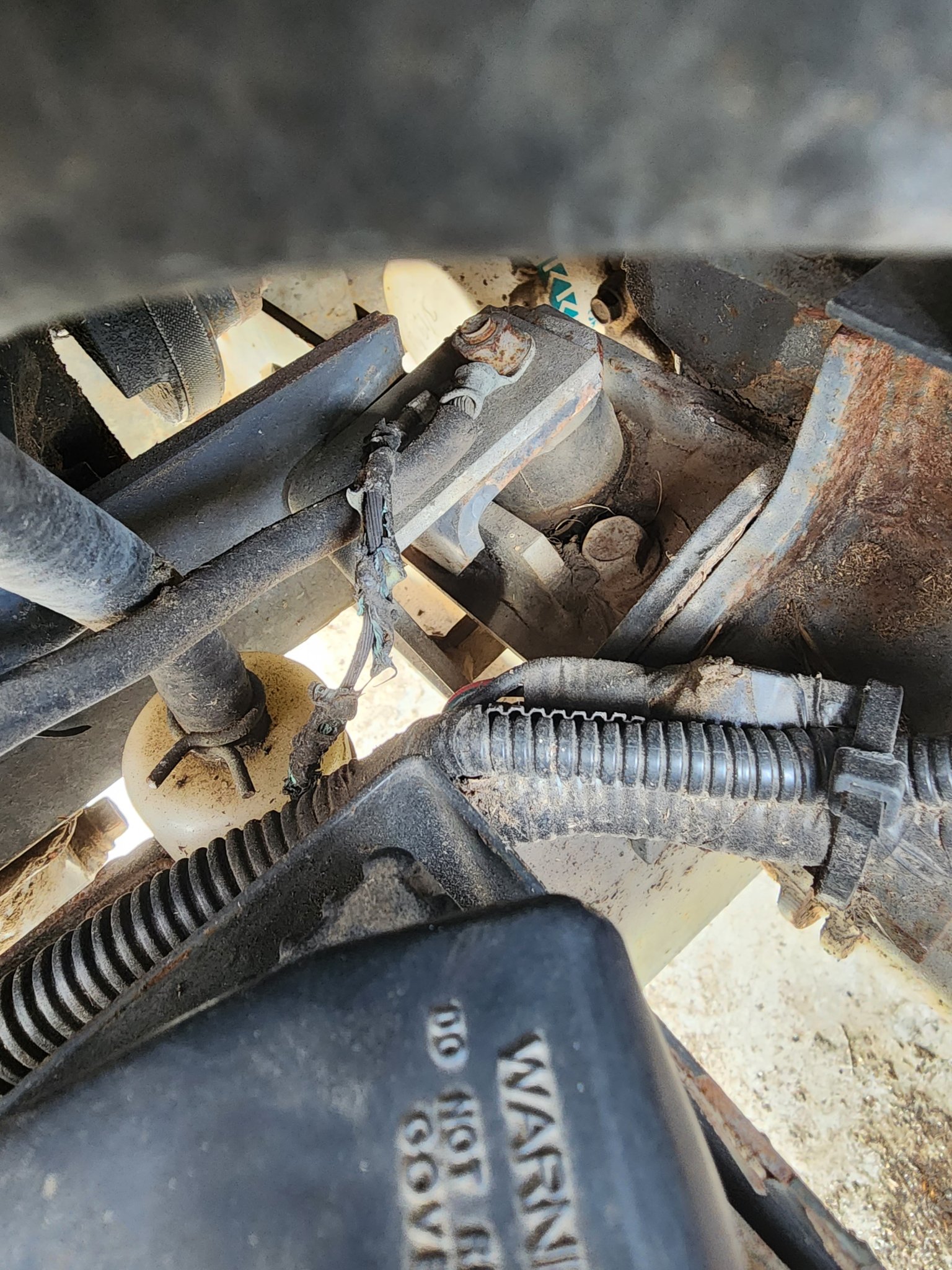

UPDATE: I pulled the battery so that I could better get to the wiring harness. After I laid open the wiring harness, that ground wire insulation is melted from the post all the way to the fuse box. In my experience, wire insulation doesn't melt unless it is exposed to too many amps, but that is primarily with control panel circuitry (AC vs DC voltage).
I'm a little hesitant to continue following this wire up into the fuse box, primarily because I'm not sure what to do then. There isn't enough wire left for me to have any idea what gauge it should be for replacement, and honestly, I've never needed to take a fuse box apart. LOL
Is it time to call a professional? And should this wire have been replaced when the dealership replaced the wiring harness? Sure seems like it should have...

Yes, that wire is part of the wiring harness.

That's your call. Depends on your comfort level. I'd replace it, myself. Count it an adventure! :D
I'd guess that to be about 10 gauge.
But even if it should have been replaced as part of the wring harness, don't expect to get it re-done for free. Some not-right thing made that happen, and that some not-right thing needs to be found and fixed, or it will just get fried again.
I noticed in all of this that nobody mentioned replacing the battery cables. If that fried wire is a ground wire (I'm guessing it is), it's likely your battery ground cable is not happy. Or where it connects to the frame. Or both.
I'd replace both battery cables and clean up the connections (both ends of both cables).
That's in addition to replacing the fried wire, of course.
There is no ground wire at the fuse box, but it does go to the relays, controller, regulator, gauges, and warning lights, etc.
If I remember correctly, it is a 14-gauge wire.
Sounds about right. If the main battery ground cable is making a poor connection (cable or connnections), then, when you try to start the beast, the current will seek a path back to the battery, and any other ground wire (like our fried friend here) will be an available path, but the current will be too much for it. Smoke follows.
Check that main ground cable. I'm betting you'll find a problem there.
Remember, a cable can look fine on the outside, but be corroded inside the jacket.

That little ,fried wire got damaged as a LOT of amps went through it because some OTHER wire wasn't doing it's job. I've seen similar damage on other machines,
As Mark says, check the main ground cable and it's connection to the tractor. Heck just replace with a new one

The burned wire does not go to the battery. The wire was damaged from either a failed component or the harness has been damaged shorting a positive wire to the ground wire.

You probably should contact your dealer as they replaced the wiring harness, and yet they did not perform the PSB which addresses the exact condition you were experiencing. Their failure to perform the PSB has damaged your harness and as you open the loom, will probably find more damage.
Your picture in post #5 clearly shows the harness ground wire is installed with the negative cable rather than on the separate bolt per PSB-2008-028-B.
The PSB is attached to post #4 and the wiring diagram is attached to post #11.

According to the wiring PDF what WT supplied , everything except the starter and 3 sensors is 'grounded' through 3 black wires with rings on them. Lower right of the diagram. 2, #12 wires with M8 rings, 1, #14 with a M6 ring. All the current flows through them to the chassis, then to ground battery cable and finally into the battery.
100% of that wiring harness needs to be opened up and inspected and since it was dealer replaced, it should go back and have it done, right and free.
Agreed! Emphatically! If one wire in a bundle is melted that badly, it's not the ONLY one that is damaged.

The ZD326 like all ZD series mowers has only the main ground cable running from the battery to the frame and all other ground wires are attached to the frame.
