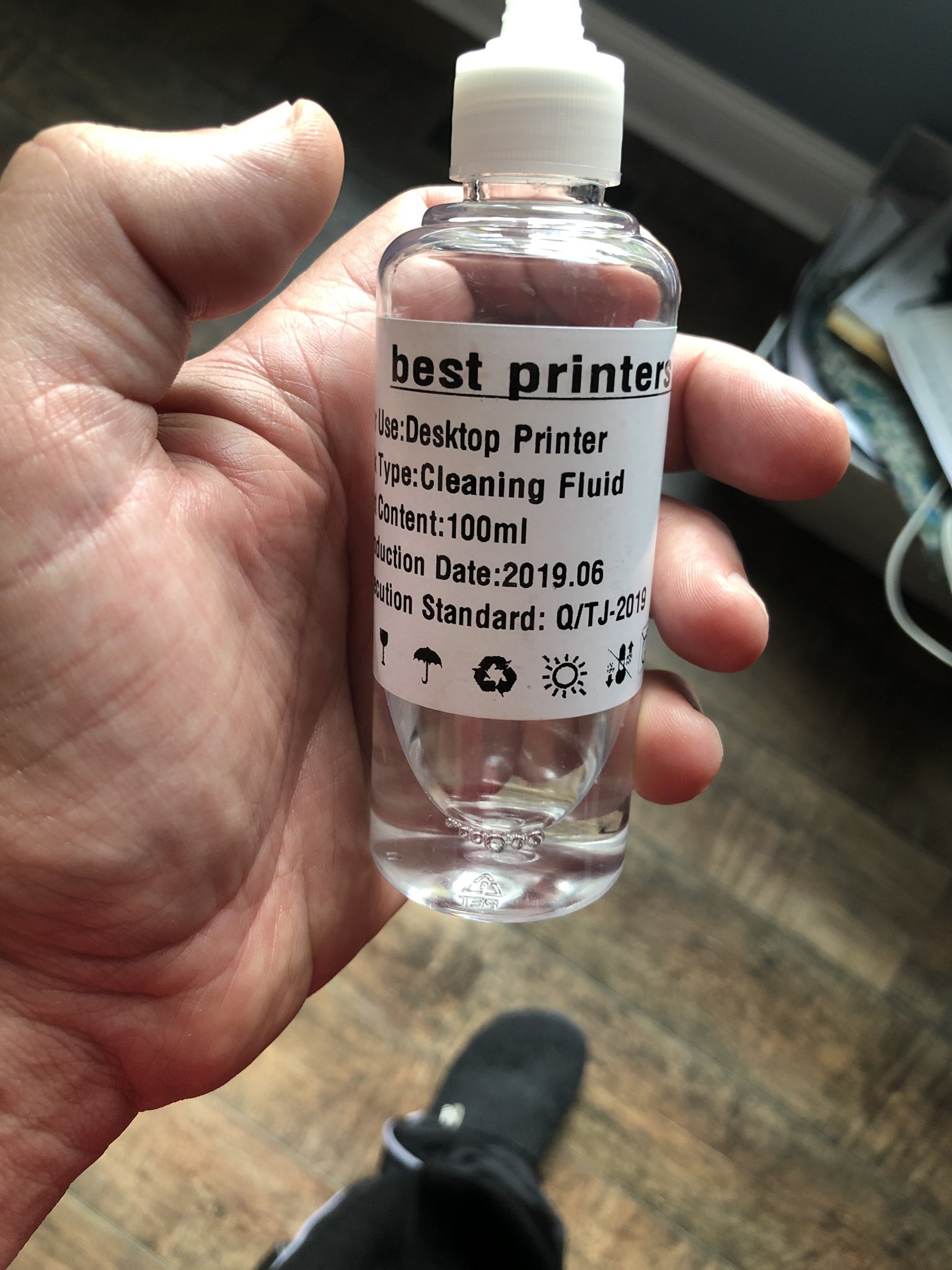

Lots of good tips online to check before you trash old electronics. I have an old HP Photosmart 6520 that rarely got used pre Rona. When I did go to use it, print heads were clogged up. In the past I’d Chuck and buy new. Found a good print head cleaning kit on Amazon and tried that route. Called Best Printers. Put a few drops on the head and let it soak through. Had to do two or three treatments but it works great now. Have to have color for the wife so a simple laser printer is out. Also get 3rd party cartridges from Sotek that are cartridge chip compatible. Prints great and four XL cartridges are less than one HP black cartridge. Worst case when you install the printer says unsupported ink cartridge. Click OK and it works.
