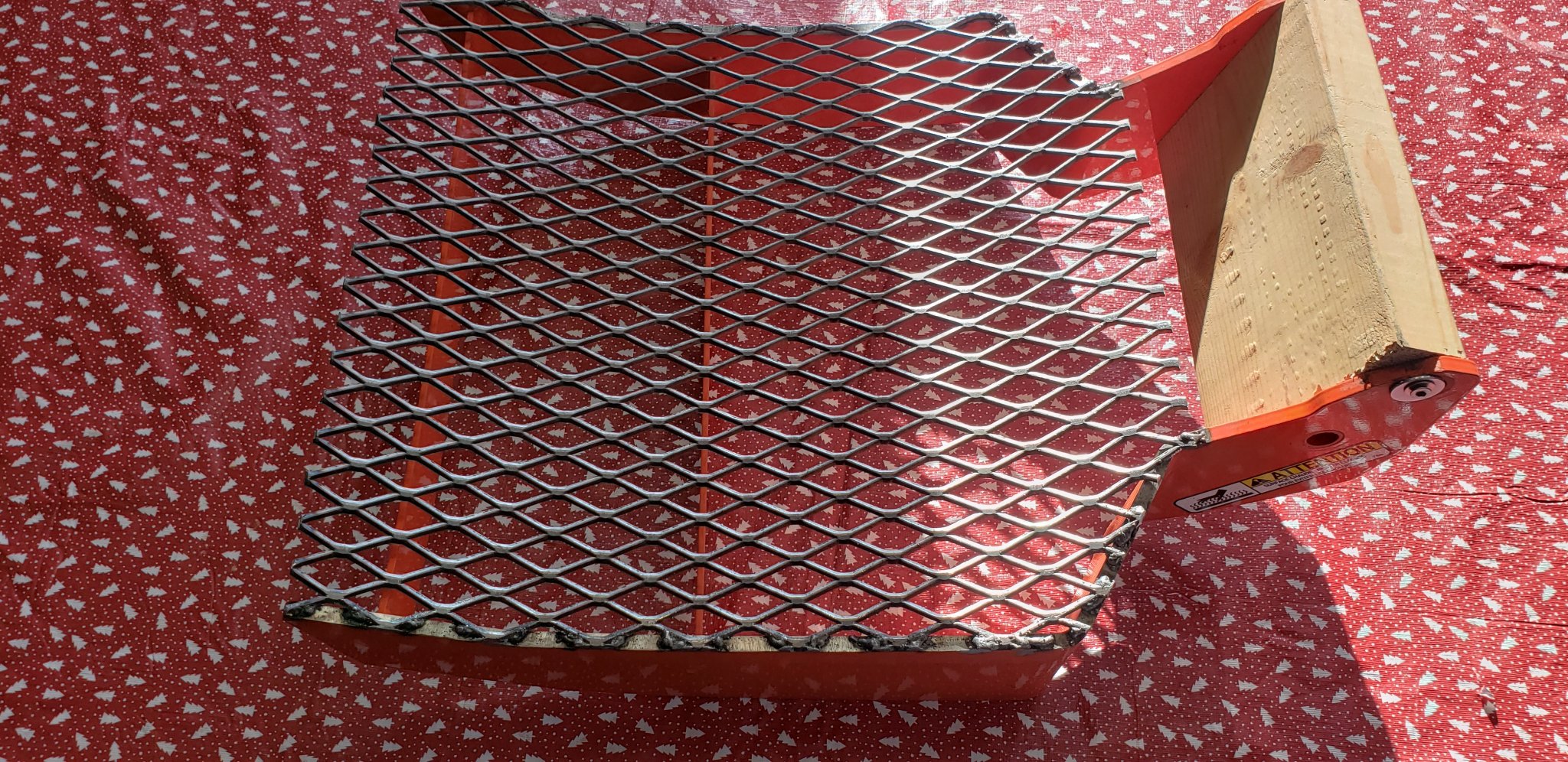

This is my first time welding. The weld is not pretty and probably not as strong as it should be. But there's a first time for everything.

Good job. Welds look fine.
I would weld some flat bar across the top. Lots of sharp edges there....my shirt or skin would find those real fast!

You're absolutely right. I thought about it but I had no more metal on hand. And now it's painted... It's not something I reach for a lot anyway. At the end of the day, if I cut my arm on the grill but did not crush my foot with the backhoe, I guess it's a good day 😁

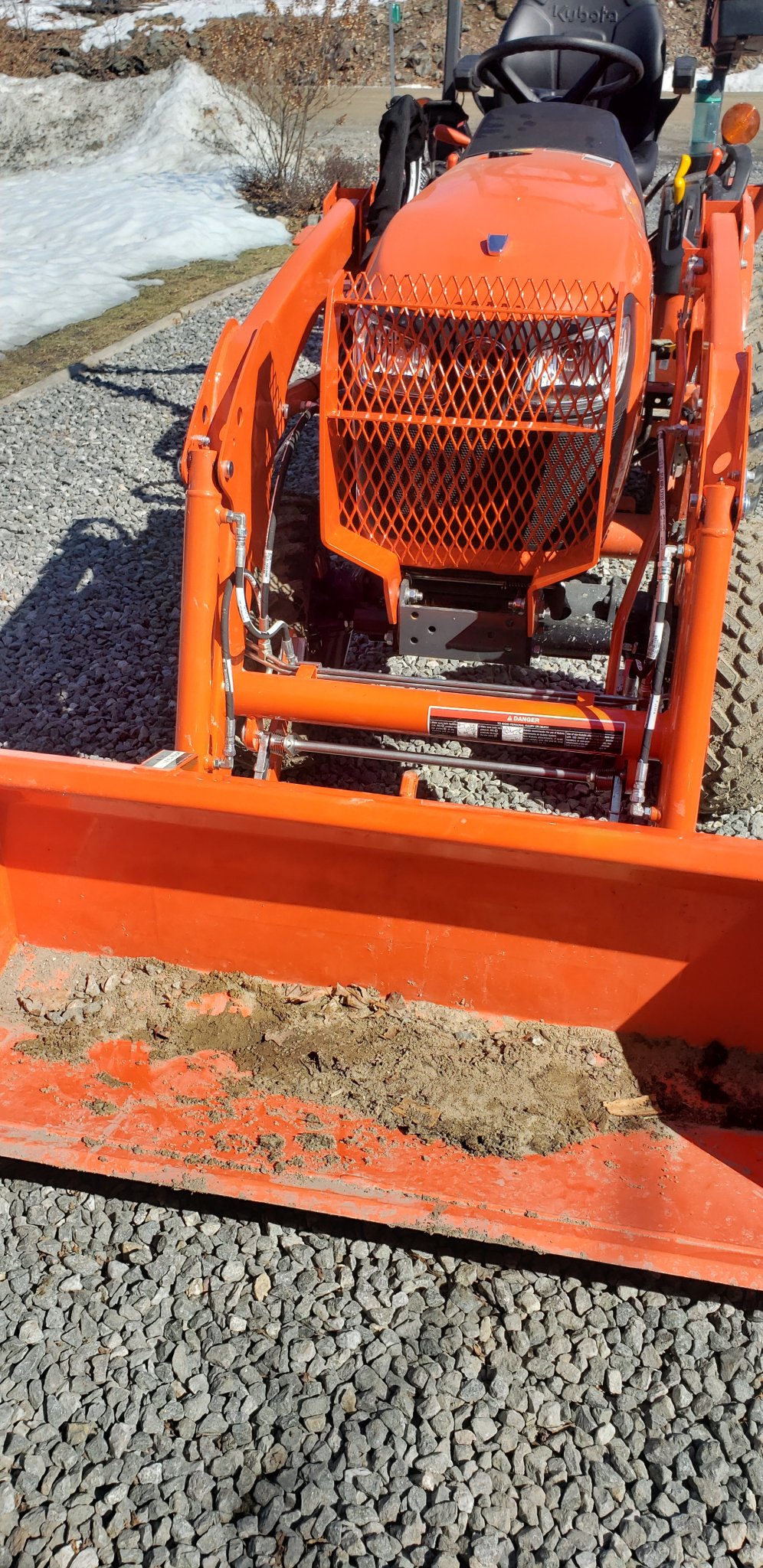

B737
LX3310
Jun 9, 2019
2,024
2,194
New Jersey
at a minimum i would put some trim edge across the top of that
looks good though

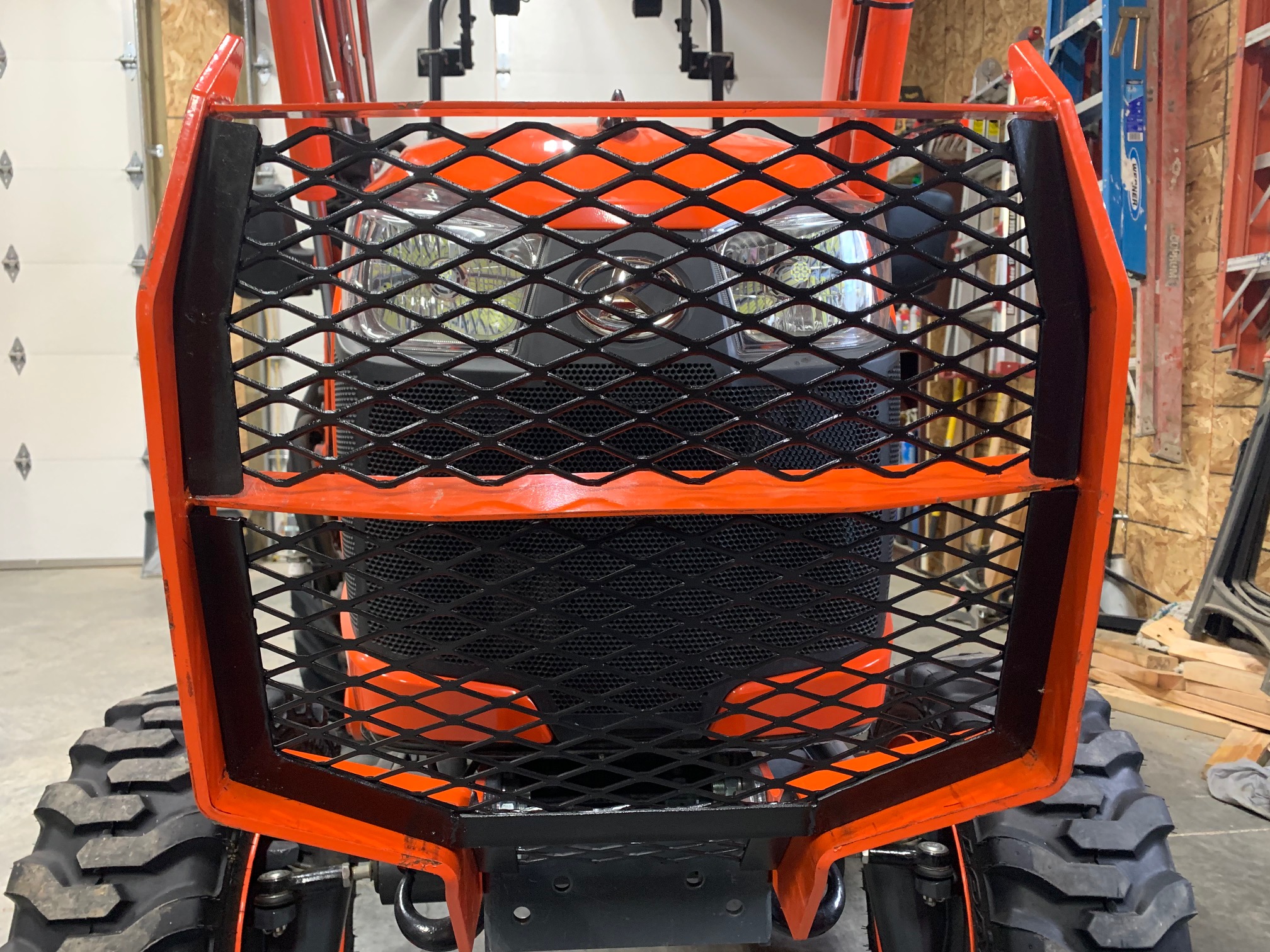

Looks really good. Can I ask why you welded the mesh on the back side and not the front?
I thought it would look nicer on the back. Plus, putting it on the back hides the weld.

Looks good, just get a small diameter fuel line and split it lengthwise and put it over the wire ends and job done.👍

I went with the back on mine and added a little beef at the same time.

I installed the mesh in angle irons and then bolted them to the guard. I did this so if something happens to the mesh, I can just unbolt them and make new ones without having to grind down all the welds to get the mesh off.
The welds look a little cold but you did great for a first attempt.
This is probably the direction I intend to go i.e. mesh welded to angle that bolts to the factory guard. A member here makes very nice grill guards but like many here I'm going to make my own.
