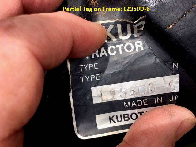

One tag is severely faded (though I think I can read some of the number), the other tag was a foil backed tag (which I believe had the actual Serial Number) was only partially there. Just enough left of it to read the model number followed by one numeral (before the tag was torn). I can just make out a 6 and that is it.

The year of manufacture is not like a car or truck - now some models DO have a serial number break where something was changed. But in your case ...... you just need the model number only!

Flintknapper, I agree with Hokie on his statement...I have an L2350DT and when I order parts all the parts people want to know is the model # and sometime want to know if its a DT(dual traction unit)

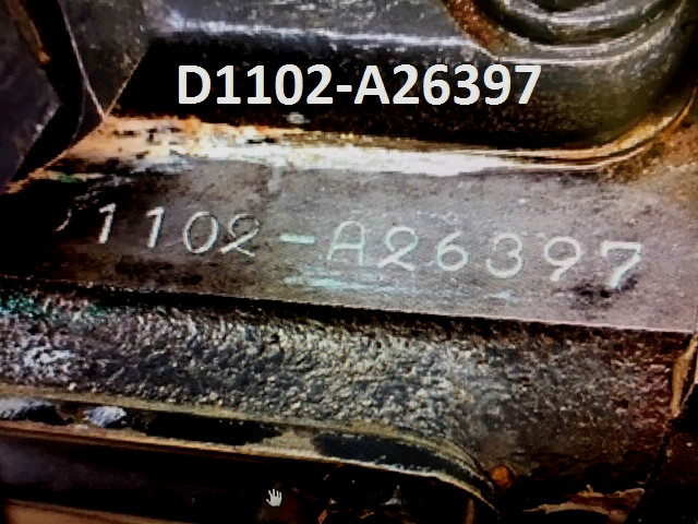

It's stamped in the block near the injection pump on most engines. Some have the number stamped at other places. Normally painted over.
After a little searching.....indeed this was the case. Mine was so heavily painted over that you'd never know there was a stamping if not for the 'location'.
Some Aircraft paint stripper, wire brush and 20 minutes time revealed the Alpha-Numeric stamping hidden all these years. I'll say this about the engine....it received a 'generous' coating of paint.
Anyway, now that I have a 'number', I have another question (you knew I would). ;)
Question: What does it mean? Is it a date of manufacture?
I.E. (26th Day of the 3rd Month, Year 1997)

No, The A begins the actual serial number of the engine. The D1102 is the engine type. (The “D” is for the German word ”Drie” for the number of cylinders (3). The 1102 is the approx displacement in CCs. Your serial number precedes the change in methodology of number assignments which occurec in 1998..so your tractor is certainly make prior to that.
If you can discover another L2350 with an engine SN close to yours then they’re likely very close in tractor SN also….which might help solve your curiosity…however as has already been mentioned, the year of mfr’ isn’t of much import.
As for emissions, smaller engines fell victim to Tier regulations earlier than larger models.
My ‘96-era M4700 has zero emissions (and boy, am I glad of it.)
Nope sorry it's not that simple.
It's just the 26397th serial number generated.
The A in the number signifies it's an AG engine.
