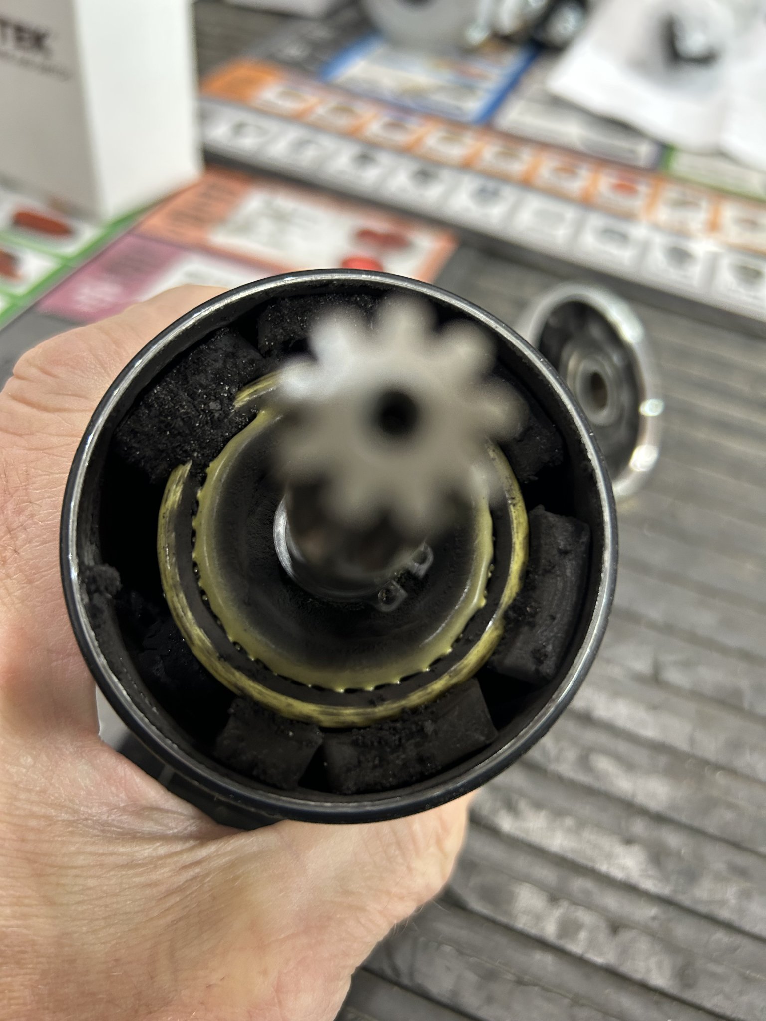

Well another starter magnet casualty here. Same as another poster that Kubota blew me off. My dealer is trying to pull some strings but no luck so far. Rebuild shop can't find any info or parts to be able to rebuild. Mine is a 2019 model. Not sure if newer models us the same Mitsuba SM17B starter. Magnets at about 8-9 o'clock came loose, broke and ground to powder

well good news at least for me. My Dealer stayed persistent with Kubota. Between the parts rep me sending them pics af inside of starter and finally warranty they were able to do a good faith discount a new starter. Got the price down to $216 which is what it should have cost in the first place not $800
