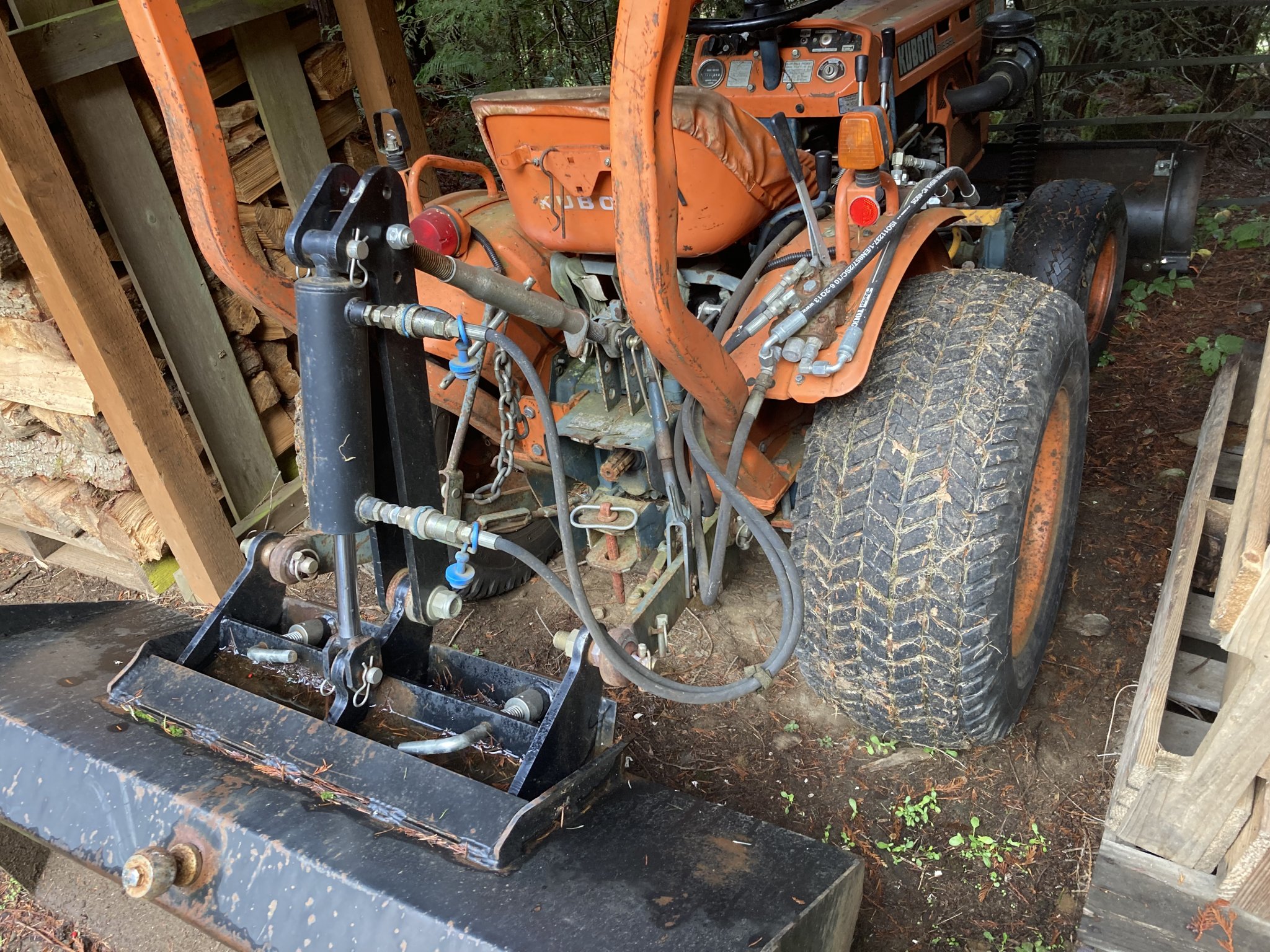

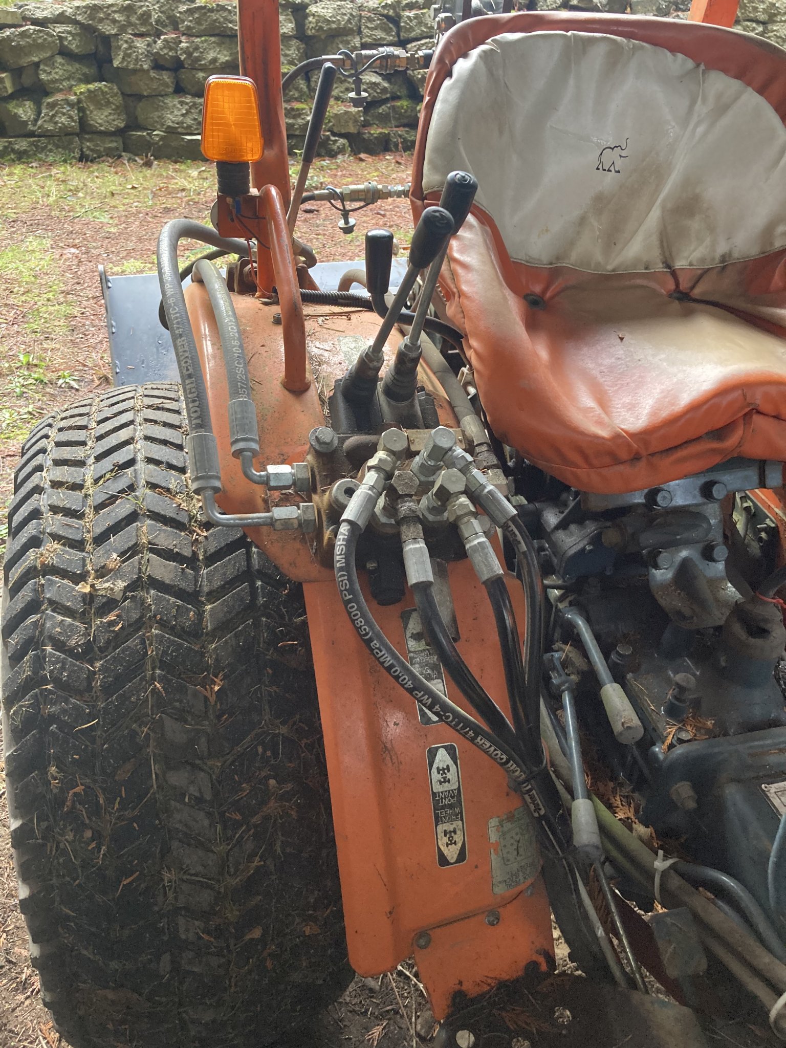

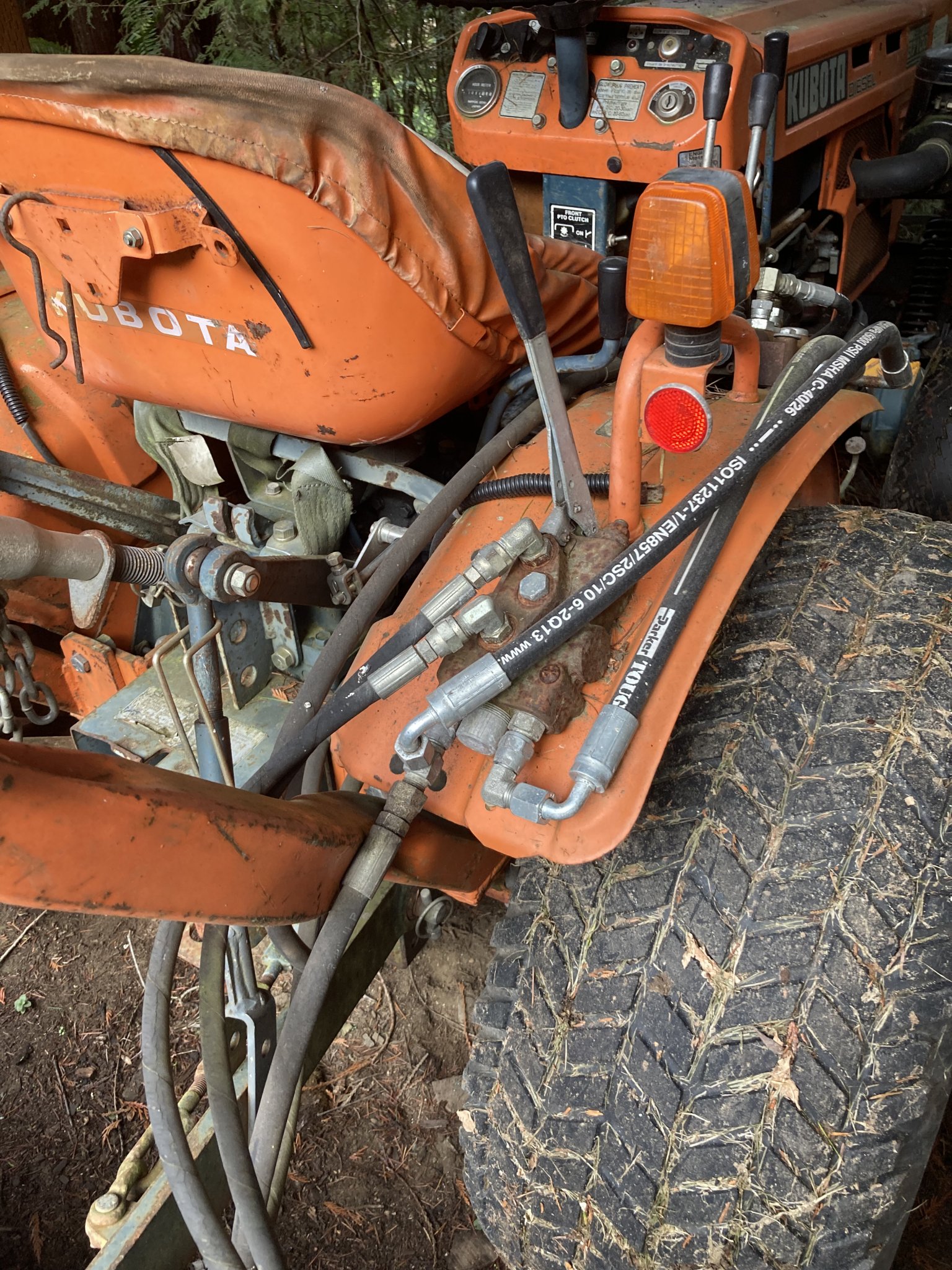

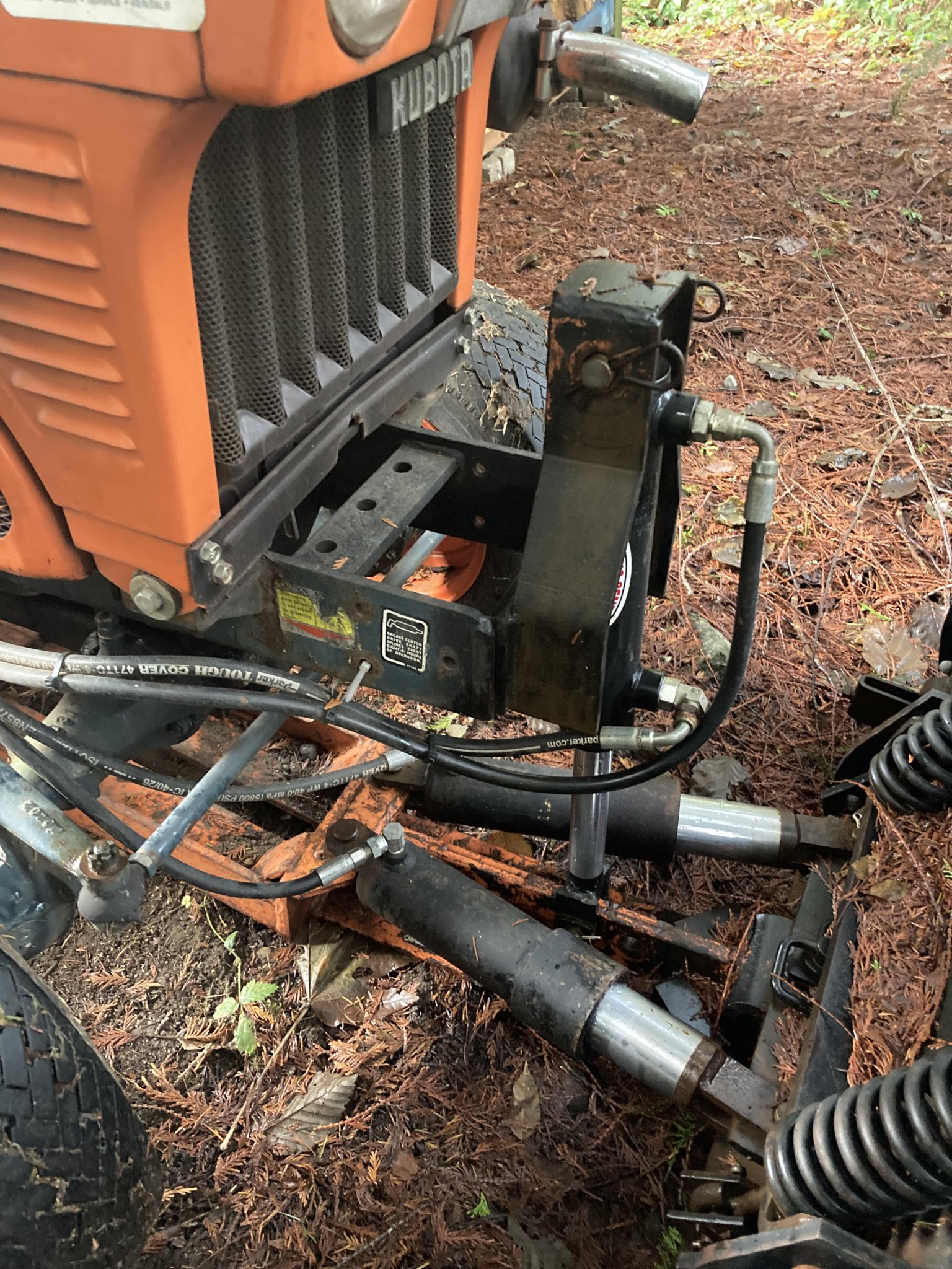

I have a B7100 with a front blade with the control valve mounted to the fender on the right side. Works great.

Thanks very much for your reply: I hadn't thought of doing that but will certainly consider it now. I'm sure routing of hoses will be important to avoid brake pedals & seat access. Any chance you could send a photo of your control setup?
