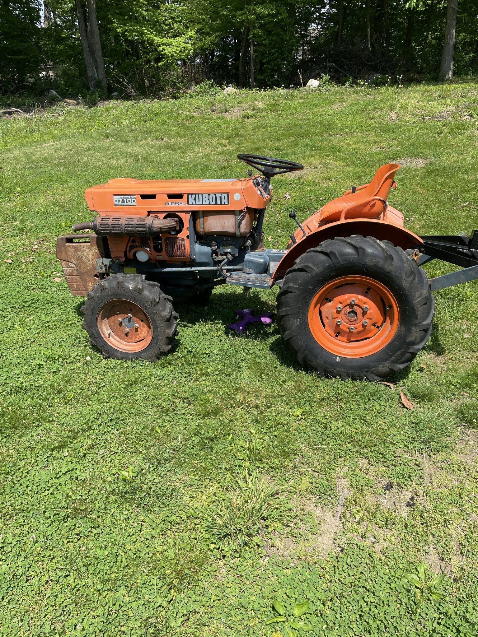

It's probably fair. Get yourself a 3pt scoop and a carryall and a hitch adapter. That's about the best you'll be able to do. I love my 7100, but it's basically just a small trailer puller.
I still expect to keep the 7100 around and pass it down to my son, hopefully. Love that stupid little tractor.

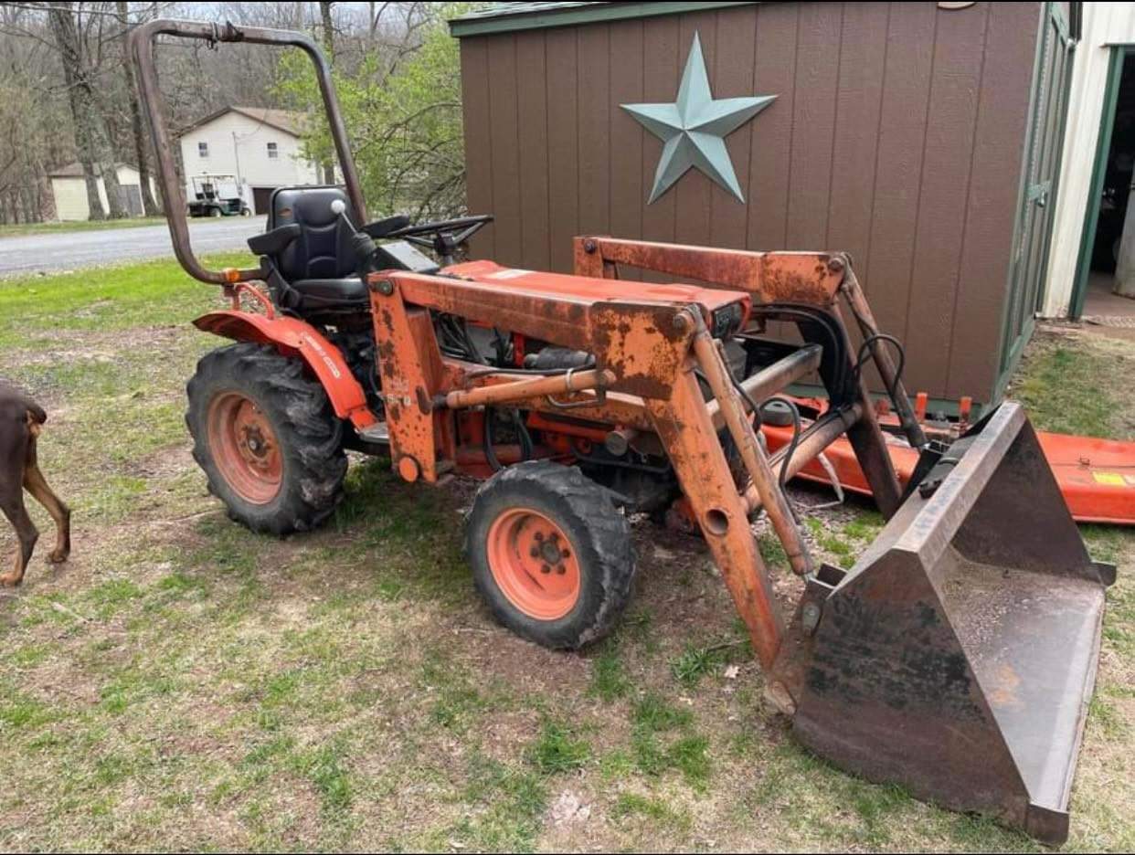

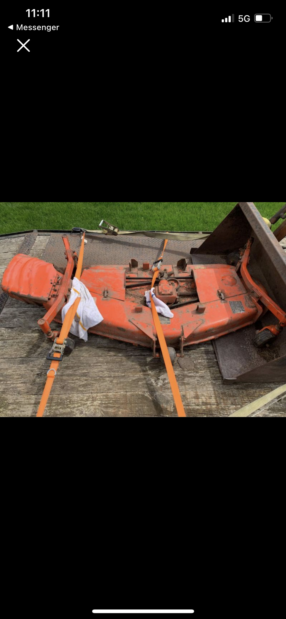

So I found a newer 7100 with a loader and mower deck for 2600, motor has blowby and won't start , I think that's a fair price for everything. Everything is in great shape and everything is complete

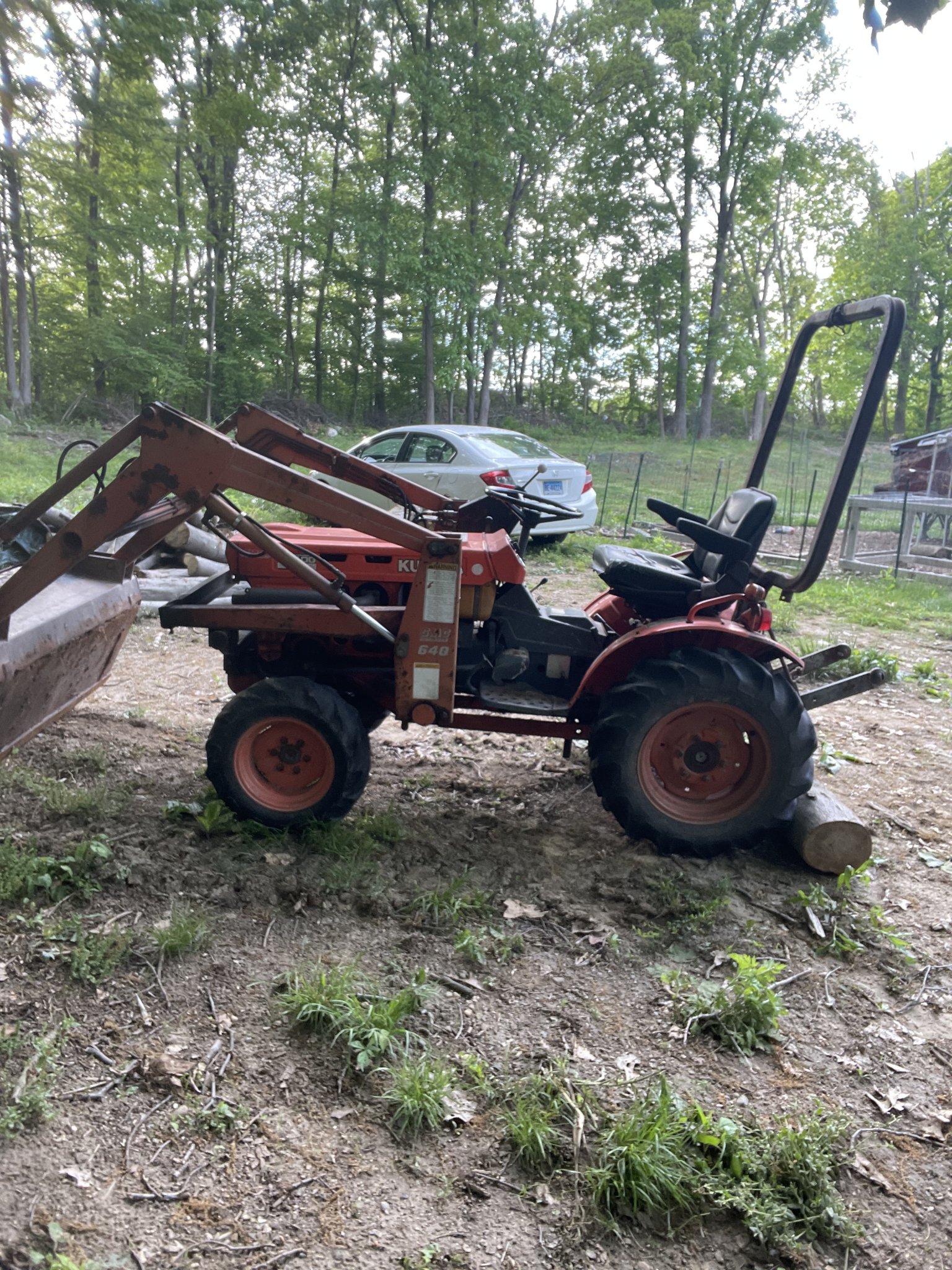

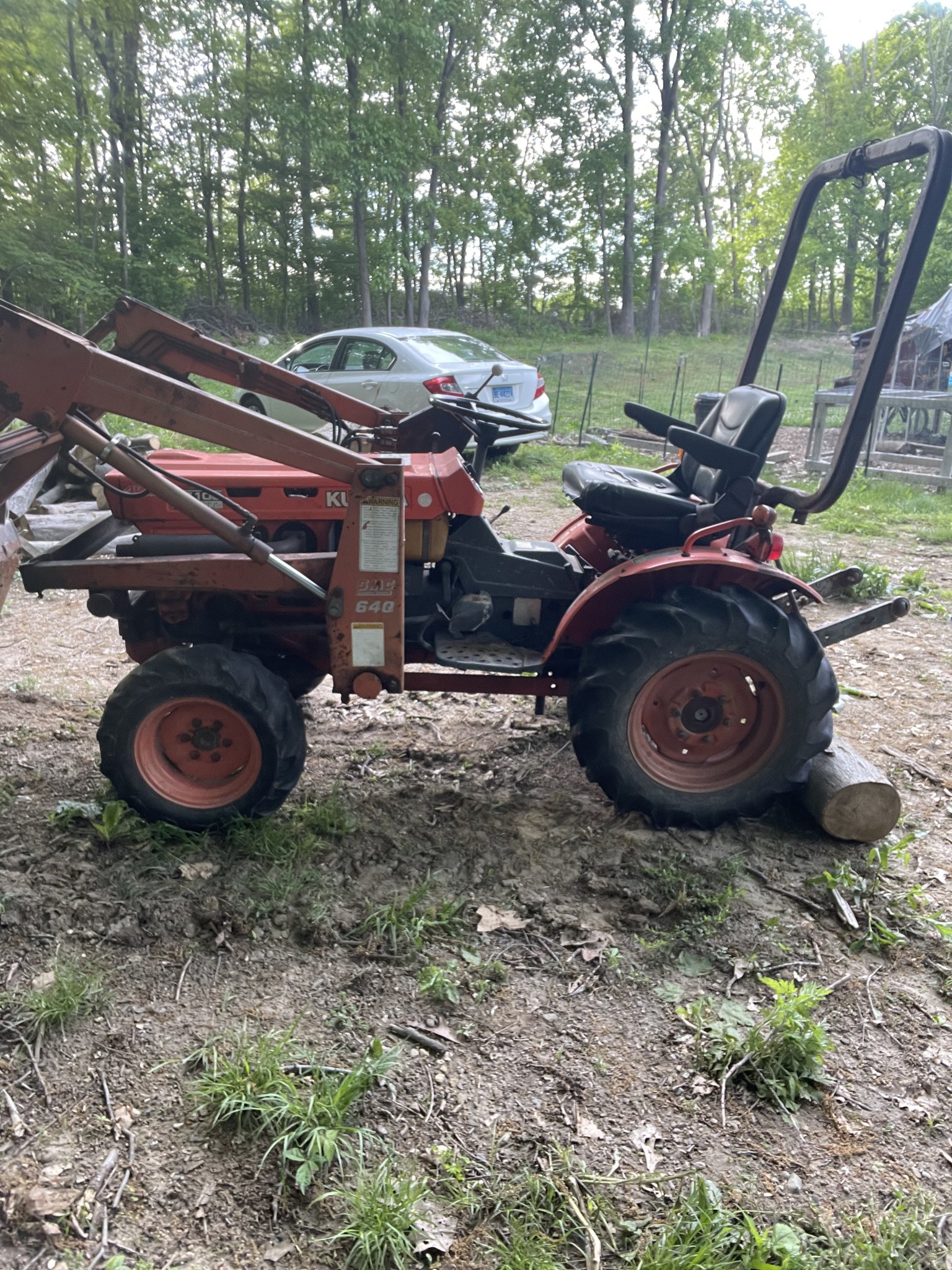

I'm a really good welder, tig and mig . So I found a 7100 with a loader and mower local to me . It's in awesome shape , it just has a blowby issue , he wants 2600 for everything delivered. Im going for it . It's 100% complete in great shape

The loader alone is probably worth what you paid for the whole shebang.
I just got a brand spanking new L3901 instead of trying to find a loader for my 7100. I mean, I probably would have gotten off cheaper if I could have stuck it out looking for a loader, but... I think I made the right choice.
Edit: Correction. The loader is FOR SURE worth what you paid for the whole shebang.

Very nice! For sure worth what you paid. Now you have a difficult choice: fix the non-running tractor and put the mower on the original, or swap the loader over to the running tractor and use the non-running one as a parts mule.
Decisions, decisions...

Looks like that is an aftermarket loader, not a Kubota brand one. Nice fit, but all bets are off. While the Kubota brand loaders and sub-frames generally bolted to provided holes in the tractor, you'll have to carefully compare the two and figure out if new holes are required yourself.
