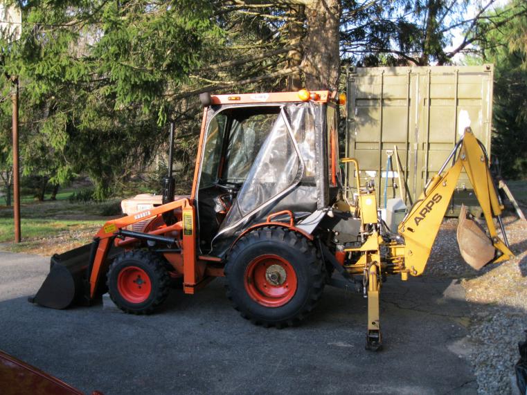

I'm replacing my rear rims, having my existing, like new, R4 tires mounted to brand new rims. My question is: Should I even add ballast this time, at all, to the tires???
My setup is a B7100-D with B219 Loader & ARPS 70 Backhoe. When Backhoe was installed I had to add lots of extra weight to front and middle of the tractor to keep front wheels on the ground. Especially when trying to drive up the trailer ramps. When I purchased the tractor the original AG tires on the B-7100 were loaded, but it did not have the backhoe attachment. Is there an advantage to loading the tires with all the weight on the rig now?
I'm most concerned with winter use clearing snow and keeping the traction. Looking for your comments on using the rig with the weight of backhoe as my weight for traction, vs. loading tires with additional weight.

Do you plan on leaving the backhoe on the machine during the winter when you will be using the machine to move snow if so then I would think you should not have to add weight however for those times when you remove the backhoe you may have to add additional weight, I have a B7500 HSD with a LA302 Loader and my tires are loaded(front and rear)I have a small bracket on the 3 point that I can hang a few hunderd pounds of weight on should I feel the need but mostly I prefer the back of the machine to be clear as it makes maneuvering easier and if I have to use a back blade then the 3 point is ready to go, I have the big orange fiberglass canopy and have mounted 3 mirrors on it so I minimize the turning around, I just glance up and can see whats behind me, I think its a matter of personal preference but for me the extra weight in my front and rear tires seems to be sufficient for the 18-24 inches of snow we have had over the last few winters, If the snow is too deep then I do not drop the bucket all the way down and make a first pass and then go back over it with the bucket in float.

Something doesnt sound right about the front end being that light especially with a front end loader installed. I had an Arps hoe attatchment on the back of my L275 and it has a front end loader and never had a weight issue on the front end. I dont remember which model Arps mine was but it had like a 6 and a half foot digging depth. I looked at picuters of the Arps 70 on Google and it seems rather small from what I could tell.
Whats the digging depth or reach on the Arps 70? I thinking it could be to heavy for the tractor and not properly suited for the B7100.
As far as trailer loading back it up onto the trailer and get the heavy assend up there first. I have to do that loading my tractor when I have the aerator hooked up.

The ARPS 70 was the smallest backhoe available, and I was told it was compatible with the B-7100. The Woods backhoe was the only other available back when I had it installed. I did not like the Woods chain drive for the swing, so I went with the dual piston swing on the ARPS. Backhoe stays on tractor year round.
It was setup by a Kubota dealer who has since gone out of business. It has a depth rating of 7' max with a digging depth of 6 1/2' for an area of about 2' in length.
Because of my trailer setup and axle/weight distribution I need to drive on the trailer. Also need to hang backhoe bucket out the back between the ramps. When the ARPS 70 was installed I had the original factory AG tires/rims on and they were loaded. If you drove up a slight incline or the trailer ramps the front would be off the ground. Even had to setup my trailer on a down hill slope to get the 7100 home from the dealer. He indicated that it was normal to have to add weight to middle and front to use rig with the hoe. Maybe that's why he is no longer in business...

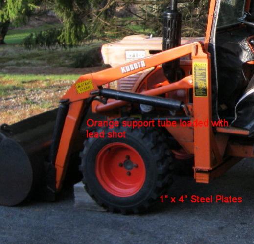

There are other routes you can take to fill your tires with less harmfull and cheaper liquids. You can buy an air/water adaptor from Tractor Supply for about ten bucks and fill the tires with concentrate washer fluid. You can go with a water anti-freeze mix.
It still really concerens me that you have to add weights to the front of the tractor for the backhoe to be on. Looking at the photos you posted it seems like it should be well balanced out. I've been scratching my head all day on this one!

I'll take it as a complement. It was balanced out after some creative work. If you look under the vertical tower for the loader frame, you will see 3 1"x4" steel plates. There are actually 4 steel plates in all. Top most was cut shorter to clear bolts holding loader to frame.
Also, the orange, angled tubes, (behind the black lift pistons) that support the front part of the front bucket assy (with the pinched top ends), are also weighted. I drilled 3/4" hole on bottom side of the tube, tapped in a thread for a plug and filled them with lead bird shot many years ago.
The additional weight keeps my front end down and balanced now. My big worry is being top heavy if I don't replace the weight in the rear tires that I have always had. Guess I could go with beet juice, but hear it is very messy.
