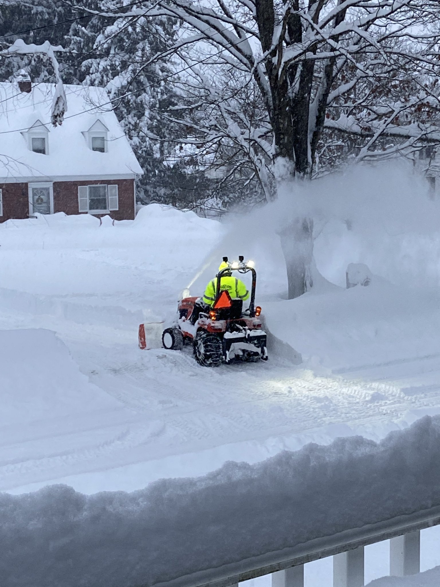

Snow blowing sucks a lot horsepower. Mowing does as well, but not to that extent.
If blowing snow and you get a lot, go BX2380, or even 2680.
Not sure that pushing snow would have the same HP demand. Helps I’m sure, but like Hokie said, you’ll break traction first. HP won’t be the limiting factor.
Trust me, I know a little about moving snow with a BX…..
As far as slopes, my BX is also part mountain goat. I pull some slopes with it without spacers, and without issue (within reason) while mowing with the loader off.
