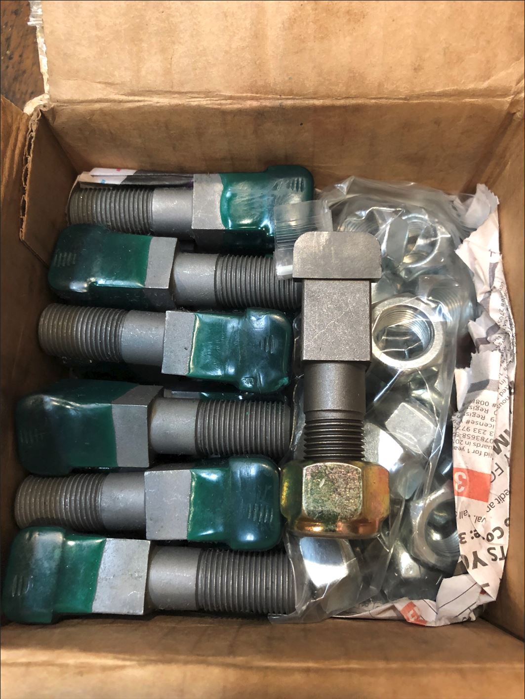

Thanks for the hook up Bird dogger. Placed an order on tuesday (maybe it was wednesday) and they arrived today (friday)! That's freakin service for sure.
Got 20 new teefers. The one at the top of the pic without the green covering is an original from woodland mills.

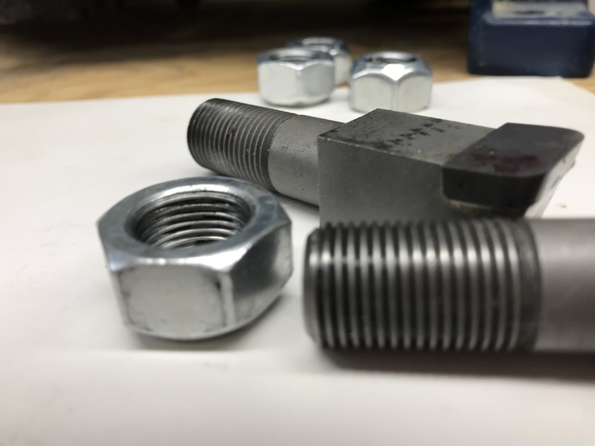

Hey Dirtydeed,
I finally got around to replacing the old teeth with new ones from Gabdon. The new nuts are impossible to get on the new teeth. I even took some inside and placed them in a vise and torque them with a long wrench. I could not get the nuts all the way on the teeth. One I did manage to get a couple of threads showing above the nut. When I took that nut off the threads inside were like flattened, but not stripped.
Anyway, I called Gabdon and spoke with John for a while, then he went to get an answer. When he came back he told me they would send a new set of teeth and insure the nuts fit. 34 teeth is not small change, but they are replacing them.
John also told me the old nuts would not fit the new teeth... a bit strange I thought.

Interesting. I had no issue at all. I did order new nuts with the new teeth.
I believe the nuts supplied by Gabdon are of the locking type. Not nylock, but they use deforming metal. It's likely that they will mess up the threads a bit once tightened/torqued down. I don't think that they can be re-used.
The original nuts from Woodland Mills were of the Nylock type and a bit deeper. I don't know if they are the same thread as what Gabdon uses.

Boy, that's a strange one!! I know Gabdon's teeth were a "fine thread" vs the standard thread on the original teeth. But you'd sure think the nuts they send with their new teeth would be of the correct "size/thread".
I'm sure you know....if they were of the "crimped" style locking nut, that the uncrimped end is the starting point for threading them on the studs.
Makes you wonder if they unknowingly just got a batch of nuts with the wrong thread and you happened to be the unlucky one to find out first? Good on them for replacing them right away for you!
With a proper thread chaser you might be able to salvage some of them and use them on the inside positions on the cutter?
Can you post a few pics of those cutters and the oddball nuts?

The picture is as close as I can get, if you can enlarge it you can make out the deformed threads. I understand about the threads deforming as a locking technic, but I haven't found one yet that can be turned with a 1/2" ratchet. If I use a longer box wrench, I can get the tooth bolt to just even with the end of the nut, but no further. Using a vise and the longer wrench I got the one in the picture to a couple of threads past the nut, but the amount of force on my part was way more than would be possible installing them on the grinder. It's like the tolerances are too tight. I should mention a lot of them were very hard to start the nut on the threads. Why not just use a lock washer and be done with it?
I'm guessing that if Gabdon didn't think something was wrong, they wouldn't have replaced them.

It's just the wrong thread pitch, likely the difference between standard and metric. If you had a thread gauge you could easily figure out the difference.
Additionally the locking part of the nut will only damage the upper threads of the bolt, where the crimp in the lock nut comes in contact with the bolt threads. If you didn't bugger up all the new teeth using the wrong Nuys, and they don't ask for them back, I'd be making a trip to a good hardware store and getting the proper nuts for them.
