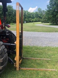

I use one of these to unload flatbed trailers of pellets and wood bricks it will lift 2000~2200 lb skids no problem. I don't know what your 3pt is rated for but these work well for unloading and stacking skids.
