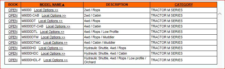

Please tell me the exact model as there are several and things are different between models.

Its a 05 m 9000 4x4 that's all I know on the model I can give you more on Monday
