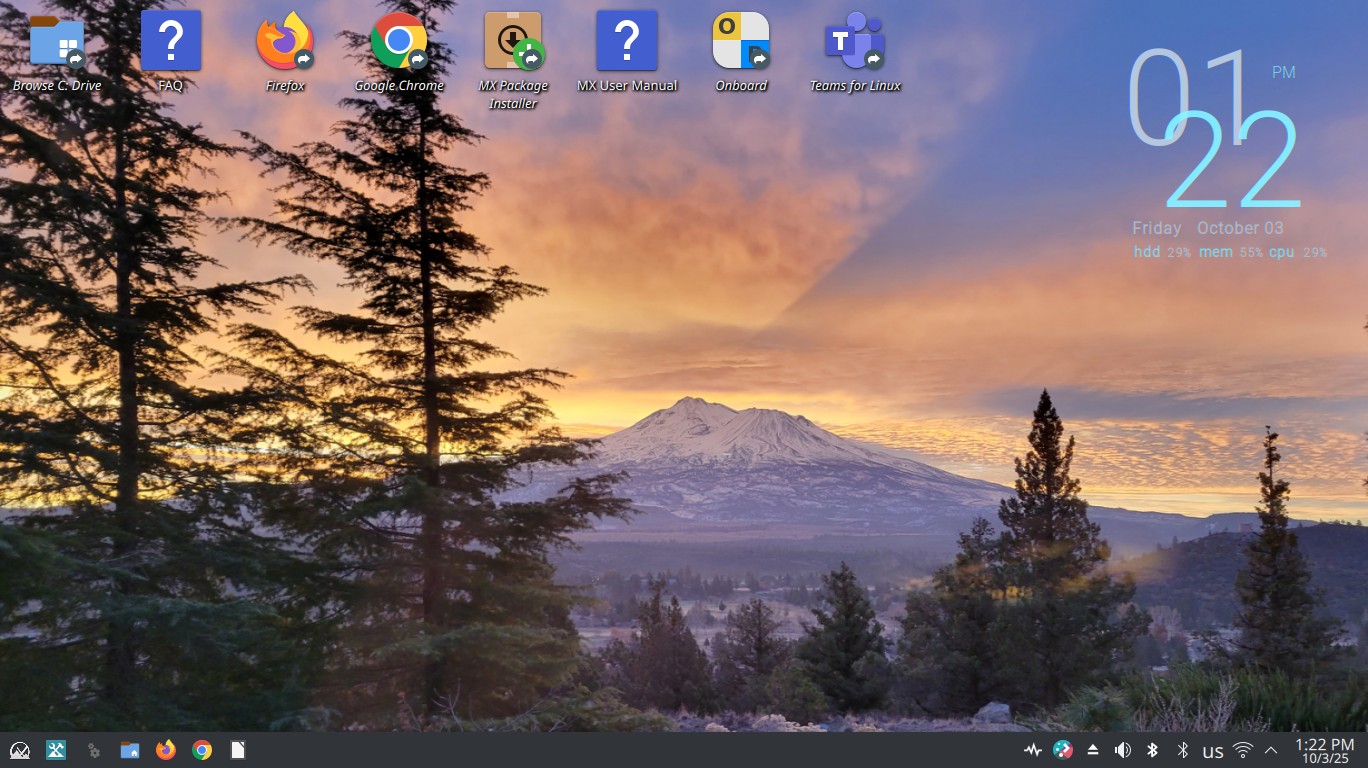

I have several old computers that are not upgradeable to Windows 11 since they don't meet the requirements plus either they have little non upgradeable memory or a gutless CPU and ran the latest version of Windows 10 like crap. I have been looking for a Linux distribution that would make them usable (not great) again and it would also be usable for a "Windows only" user since some of my relatives are in the same boat. I played with Linux over the years on and off but never found anything worth spending a lot of time on as a user and not a tinkerer since I am not an expert. Finally, I have found a distribution that allows to try using it and installing it on these low power machines without a lot of hassle. MX Linux to my surprise works much better on these machines that Windows 10 did. I initially installed the "Fluxbox" desktop version since it is supposed to use minimal resources but the sound needed further work and it was also a pain to try to add shortcuts to the desktop. From the desktop software package installer, I picked the "KDE Plasma" desktop thinking that it was going to bog down the machine. Amazingly, it fixed the sound, added the battery charge indicator and not only it was more "Windows like", I could add desktop shortcuts for apps just like in Windows. Updates come in at least daily and and a couple of clicks take care of the installation. Google Chrome, Firefox even MS Edge are available for installation and can be synchronized with my Windows machines. YouTube videos run fine with no jerkiness. The other usual suspects are available too for installation with a couple of clicks, like Libre Office as a MS Office substitute, The Gimp as Adobe Photo Shop stand in, Mozilla Thunderbird for email client and many others. The touch screen works and also there is a screen keyboard called Onboard.
The only things that do not work are teleconferencing apps like Google Meet and MS Teams due to camera or sound issues.
Here is my desktop:
If anybody is interested in the topic add to the thread or send me a message. Like I said, I am not an expert.

I found a Win 11 lite that works on older "non-upgradable" computers. Then I used a program to make the startup look like Win 7.
After installing anything, you need to go into the startup settings and disable all of the BS it thinks you need to run. If you look in the bottom right hand corner of the picture in the first post, you will see quite a bit of stuff. If you don't need it, disable it, which is likely everything.

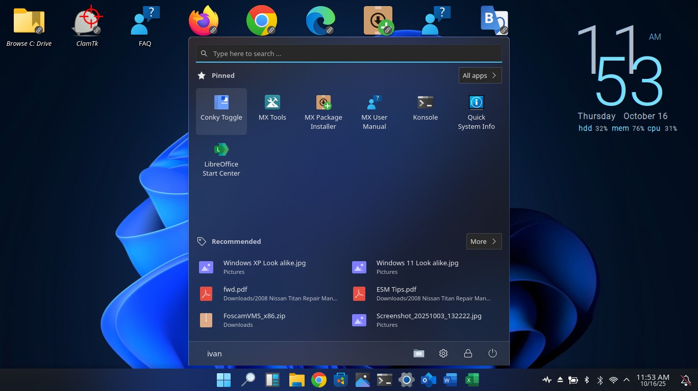

Well, I am very impressed with MX Linux so far on this little under powered computer. Not only it works better than with Windows 10 but I have found some interesting User Interfaces under KDE that make things more familiar:

Many Linux flavors give you a wide spectrum of customization options for the user interface, far more than Windows does.
