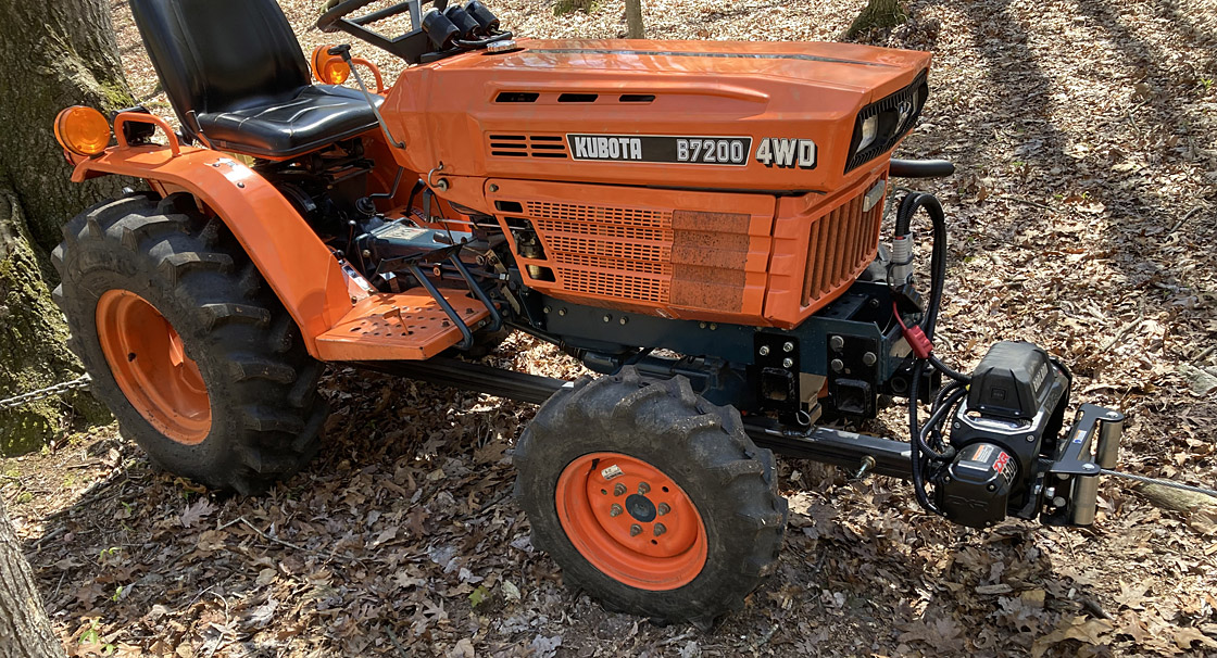

The 3PT hitch isn't the best spot to mount a winch, but it can be done. A few things to consider:
-The 3PT system has strength limitations and it's possible it could be damaged during the winching process. A lot of winches have enough power to bend and break tractor parts (been down that road once).
-They are current hogs. If your battery is in the front, you have to run #2 copper to the rear. I'd suggest an Anderson quick disconnect plug. That's what I use and it's perfect for that.
-It's better to winch from the front than rear.
I fabbed a frame mounted hitch for my winch. If you have a loader on your machine, then this may not be an option. If you wind up using your winch for log skidding and tree felling, then you should go a step further and fab a subframe. That's what I did and use when I need to anchor the machine off to something

Thanks for your comment, nice setup. I do keep a loader on the front, but maybe I can attach a plate to the front frame that a winch can sit on temporary when needed.

Mount a 'stubby' 2" receiver on the frame, put winch on a 2" receiver insert/adapter plate. That way it's EASY to install/remove.Anderson Powerpole connectors to battery, properly fused for electrical.
