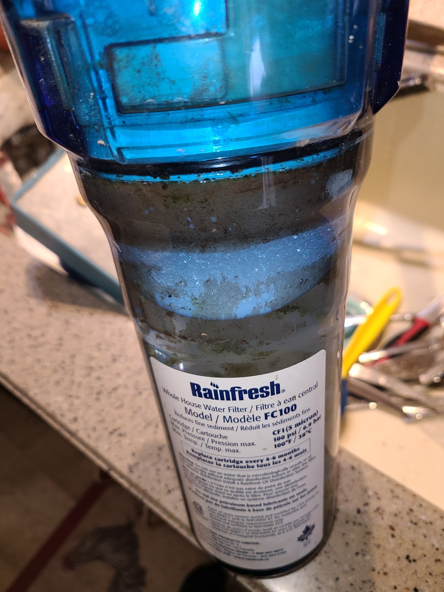

Dumb question, if I take a water filter and put it right before the tap on the hot water side as well as the cold will the heat make the casing fail? It says on the casing it's rated to function at up to 38c but I assume it means the filter cartridge will come apart after this. My plan was to put carbon filters on both lines. It's uv treated lake water as the source.
28,676
5,099
Yes it will fail!
You can not use a plastic canister filter on a hot water line, there is a stainless one that you can use, but its real expensive.
Also carbon filters do not do well with hot water either.
Use a big whole house carbon filter before the hot water tank on on the feed line to the entire house.

I can't put carbon on the main line. It's too much flow restriction, hmmm

Actually wait.... most water use is cold so I may be able to put a filter on the feed too the hot water
If you can’t get sufficient flow with one filter that’s exactly how you filter hot and cold separately to increase overall filter capacity; filter the hot on the input side while it’s still cold.
Unless the water stinks (some in this area smells of sulphur), it’s kind of rare to really need to carbon filter it for bathing (which takes a lot of water). You might consider putting a whole house filter (or two if needed) for primary filtration and use carbon filters on faucets and refrigerators where you’d be getting drinking water.

Water has no smell, luckily or that gets more difficult. I don't plan to filter bathing water anymore than the primary filtration (not carbon or anything to fine) I think between the two of you I have a plan
