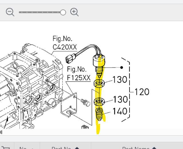

B Beetle615 New member Equipment B7800 Mar 12, 2025 1 0 1 Spraggs Mar 12, 2025 #1 I have a B7800 that will not start unless I push slightly forward on the pto lever. Just started. Any ideas.
G GreensvilleJay Well-known member Equipment BX23-S,57 A-C D-14, Apr 2, 2019 13,137 5,805 113 Greensville,Ontario,Canada Mar 12, 2025 #2 PTO lever or switch needs adjustment. hmm....maybe something got bent ? Snagging your winter coats might have done that ?? A look at the online parts diagram 'should' show what can be 'tweaked'. Hopefully you can SEE 'how it works' ....
North Idaho Wolfman Moderator Staff member Lifetime Member Equipment L3450DT-GST, Woods FEL, B7100 HSD, FEL, 60" SB, 743 Bobcat with V2203, and more Jun 9, 2013 34,149 9,335 113 Sandpoint, ID Mar 12, 2025 #3 Adjust this switch
