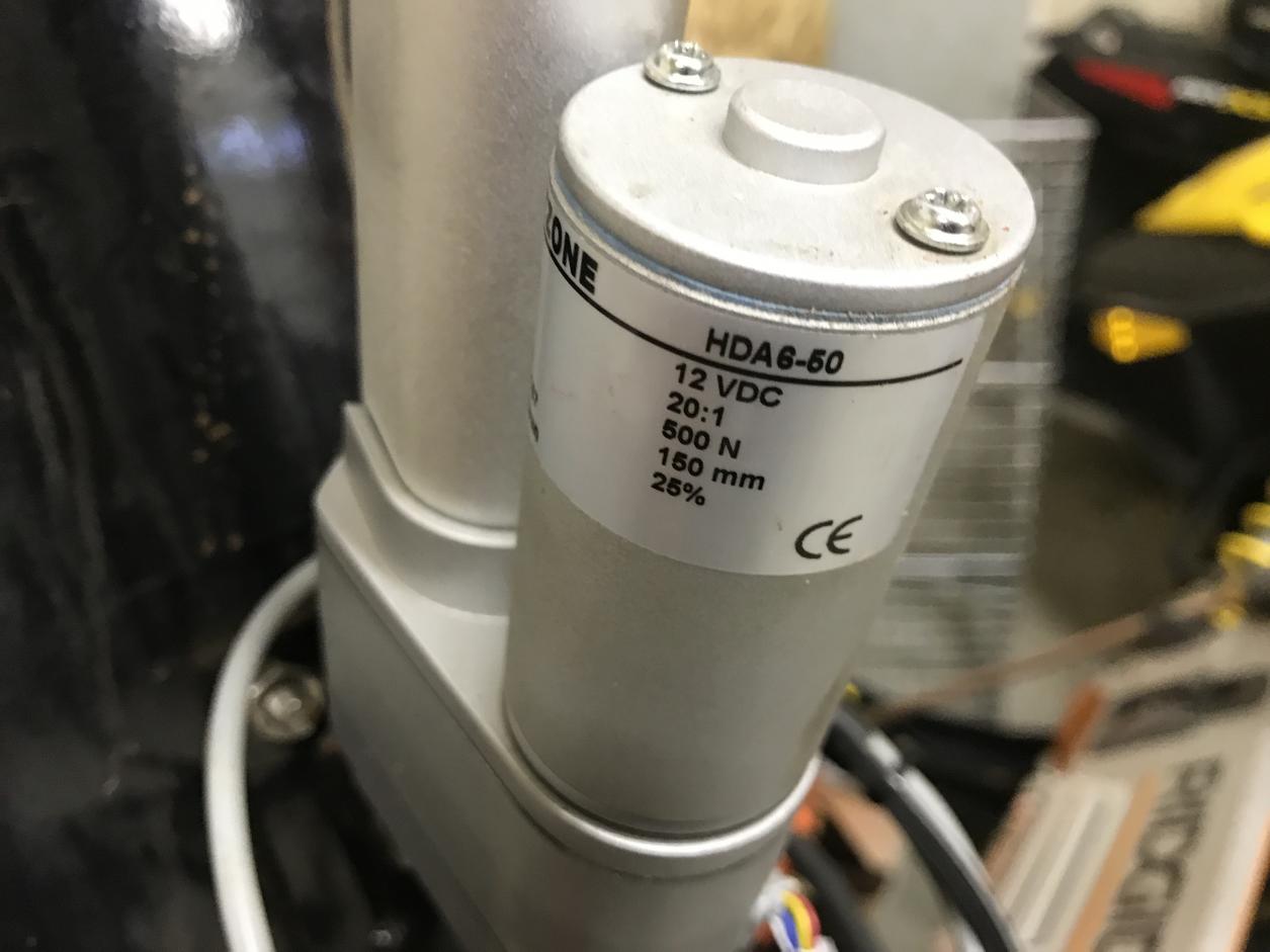

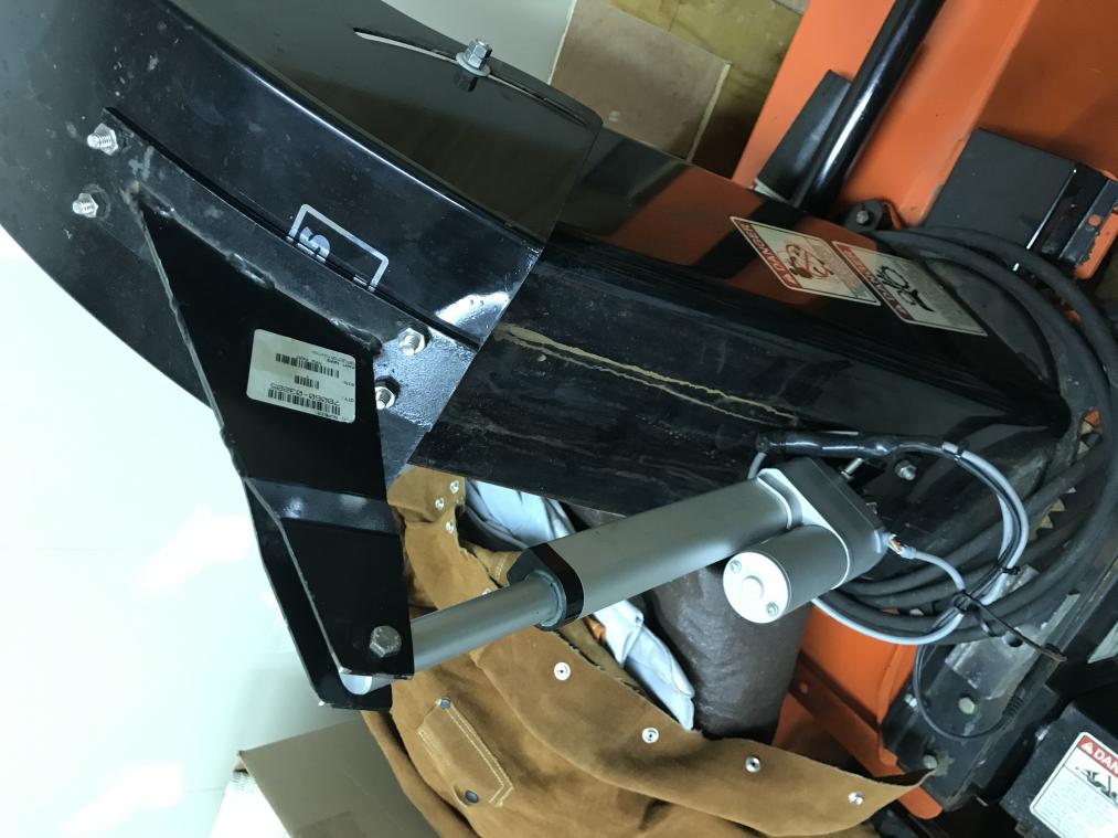

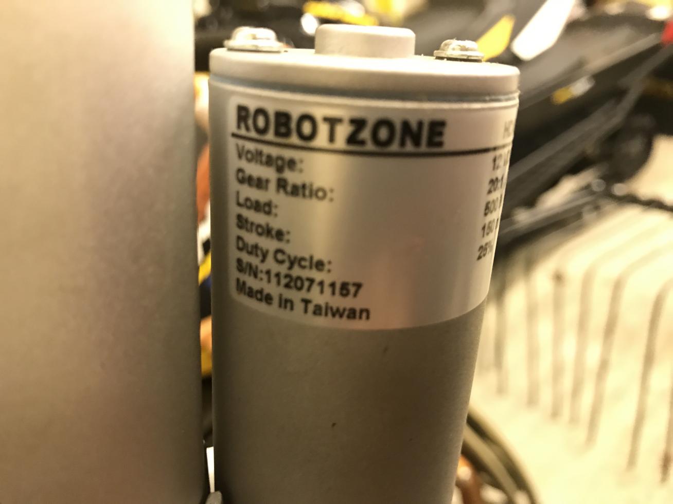

I bought a 6" but should have bought a 4" for one big reason, they all move pretty slow. 4" of stroke is all you need (told my wife the same thing but she doesn't buy it) and mount it so you get full up/down. The geometry of a 4" stroke will equate to more motion at the expense of power but power is never a problem as they all can move 50lbs or better.
