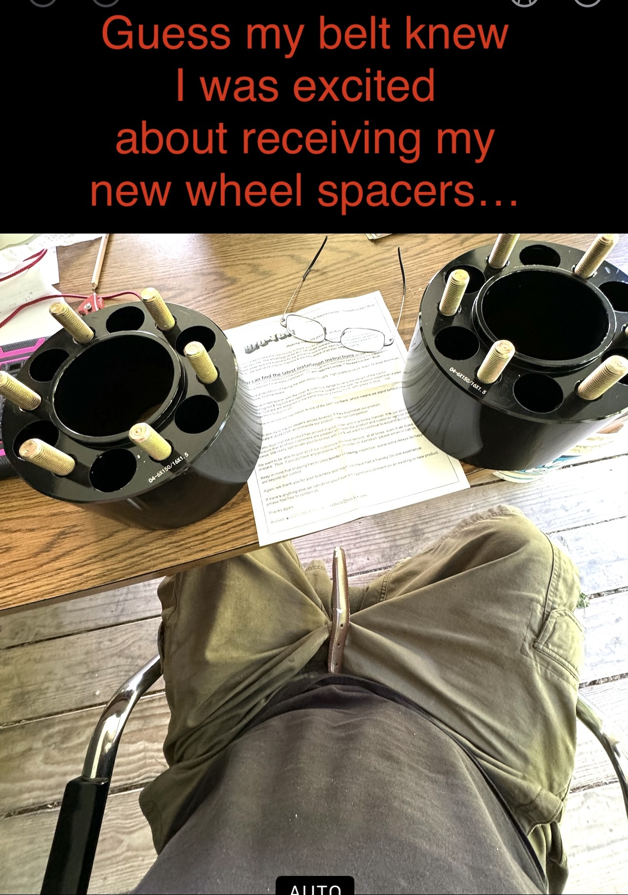

I happened to look down after unpacking the wheel spacers that arrived today…
