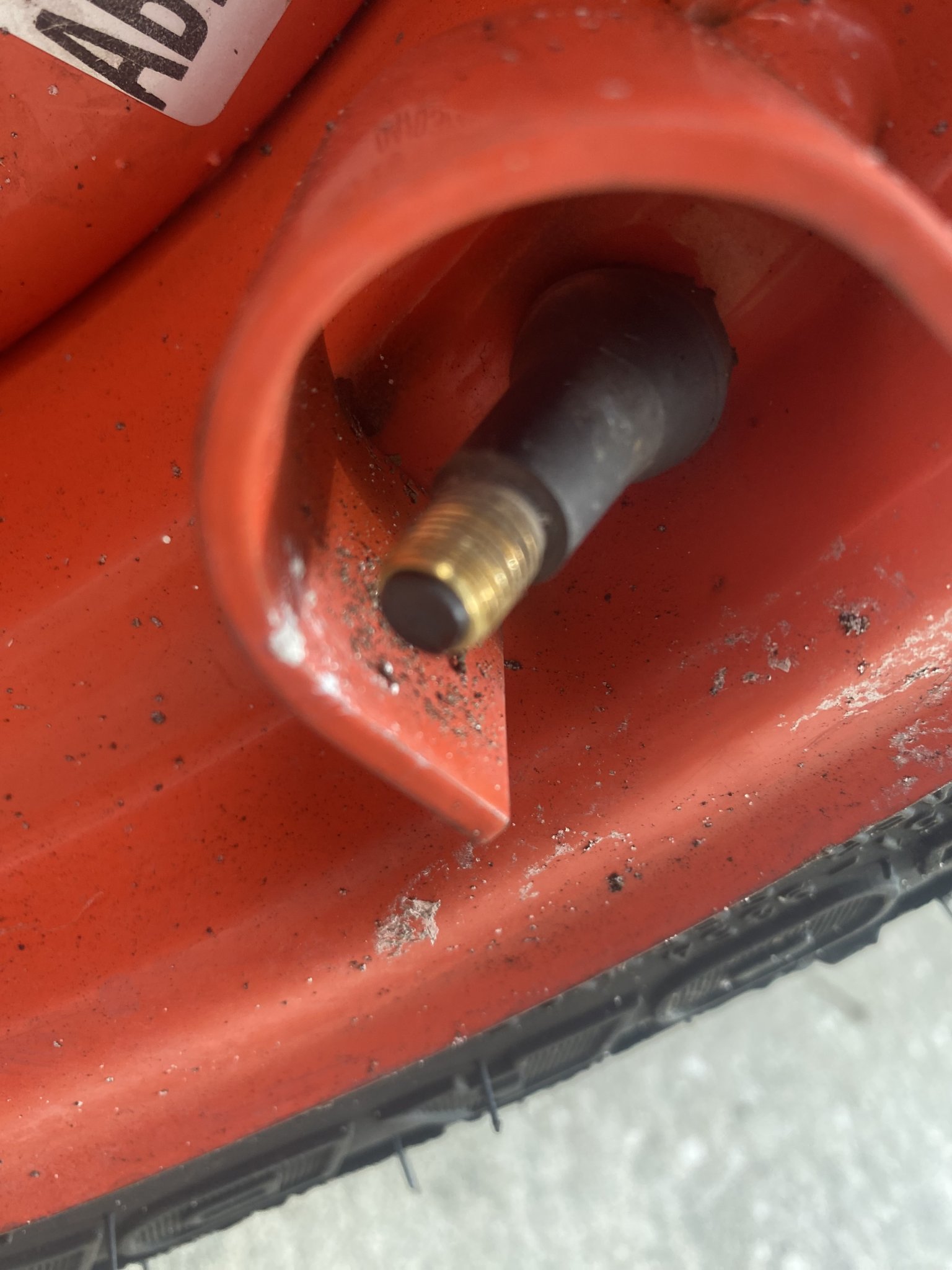

I got this machine used and went to air up the tires. The back ones are normal but the front are sealed in the valve stem. Is this puncture sealant or something else. The tires feel hard but I can’t check the pressure. One of the valve stems feels like it’s barely attached so I’m not sure if there is any air in the tire. Any ideas?
6,989
1,872
Foam filled?
They are usually rock hard.
4,871
2,427
IF…they are foam filled…they will be rock-hard.
