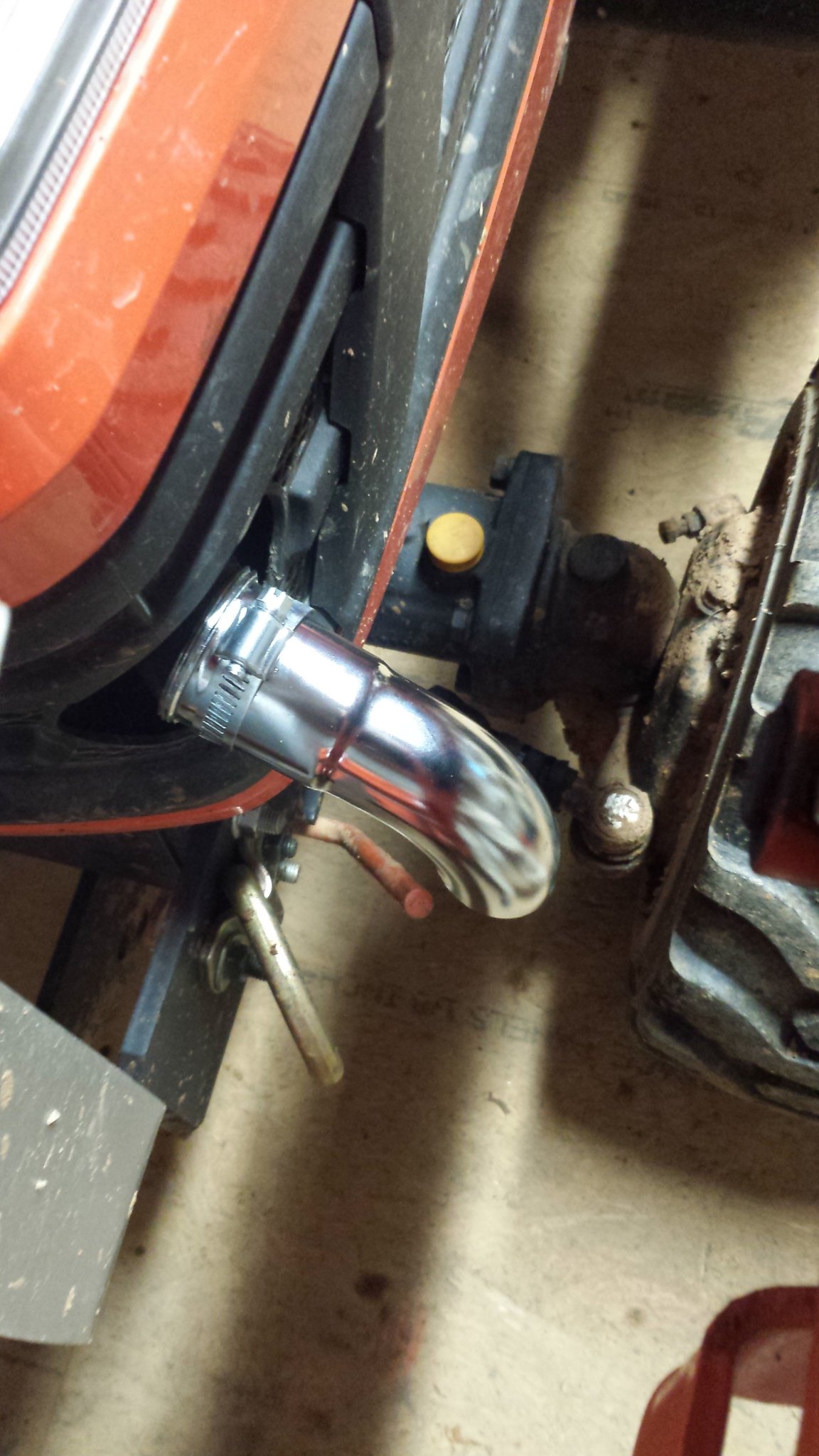

Don't think I've seen anyone mention that problem. I did install an extension on the exhaust pipe on my B so at startup, I don't spray it all over the loader. Was not due to me breathing it though. Hmmm...

I have had mine for over 9 years .......... I too turned the exhaust down so carbon black is not over the loader.
Do something like this and see if it helps:
