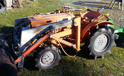

Look down on the side of the transmission by the clutch pedal. Should be an I'd tag with a serial, and model numbers. If not there, check by the injection pump.
Can you get some better pics, the ones you posted are hard to see

Welcome to the forum thorpboy. Not much to go on. Like Todd said, more pictures.

from those pictures.........
B6001?

Yea a little hard to figure it out off a couple of pics the size of a postage stamp. ;)

Bigger pics and some info from the plate as per Daren.

Little better, make it twice as big again.
How many cylinders does the engine have? 2 or 3?

Better picture.......
IF like Wolfman said -
Does it have 2 cyl or 3 cyl?
Does the pto spin CW or CCW?
B6000D has .6 L 2 cyl 13 HP and CWW pto
B6001DT has .7 L 3 cyl 14 HP and CW pto
which one you got?:)

On the side of the transmission where your left foot would sit, there should be some stamped #'s and usually the model # too. ;)
