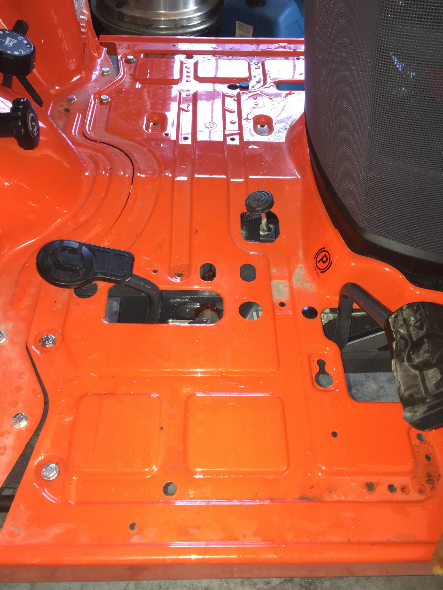

I’m curious as to how many of you may have found rust under your floor mats. I’m sure there may be some that’s never taken the mat up but you may want to check on it.
I have only 23 hours on mine so not much to worry about at this time but if left alone I could see this corroding quicker than wanted. Other than removing fairly often and cleaning and waxing it, I don’t know what else you could do. The back of the mat is cleated and there are holes in floor board for drainage but mine was still holding water days later.
Just something to think about if you have not ever taken it off. Much easier with Auto body & interior panel tools. Those suckers were tight and I would have destroyed them without that tool. Not that you can’t replace them cheap enough but just one more thing to have to remember to get.

I would think if you had only 23 hours on the tractor Kubota would warranty it.
If you are going to take care of it yourself, if the metal is rusting you need to strip the paint down to the metal and use an epoxy primer and then paint it. You won't have anymore problems with rust.

Sorry if my post was misleading.. mine doesn’t have rust but I could see where it could easily rust without some attention.
Thanks for the suggestion on the fix!
If I ever need it.. hopefully not!

I thought I could see some rust in spots in the picture. Depending on how the metal was finished rust can spread out under the paint and get bigger than what you see. This is the benefit of epoxy primer. If there is a scratch or damage to the paint down to the metal the rust would be isolated to the scratch.

I was trying to show the puddles of water plus there was some dry dirt along with a little mud. It looks new again but you can tell where the most used spot is.. and that’s where you place your foot for upward approach.
