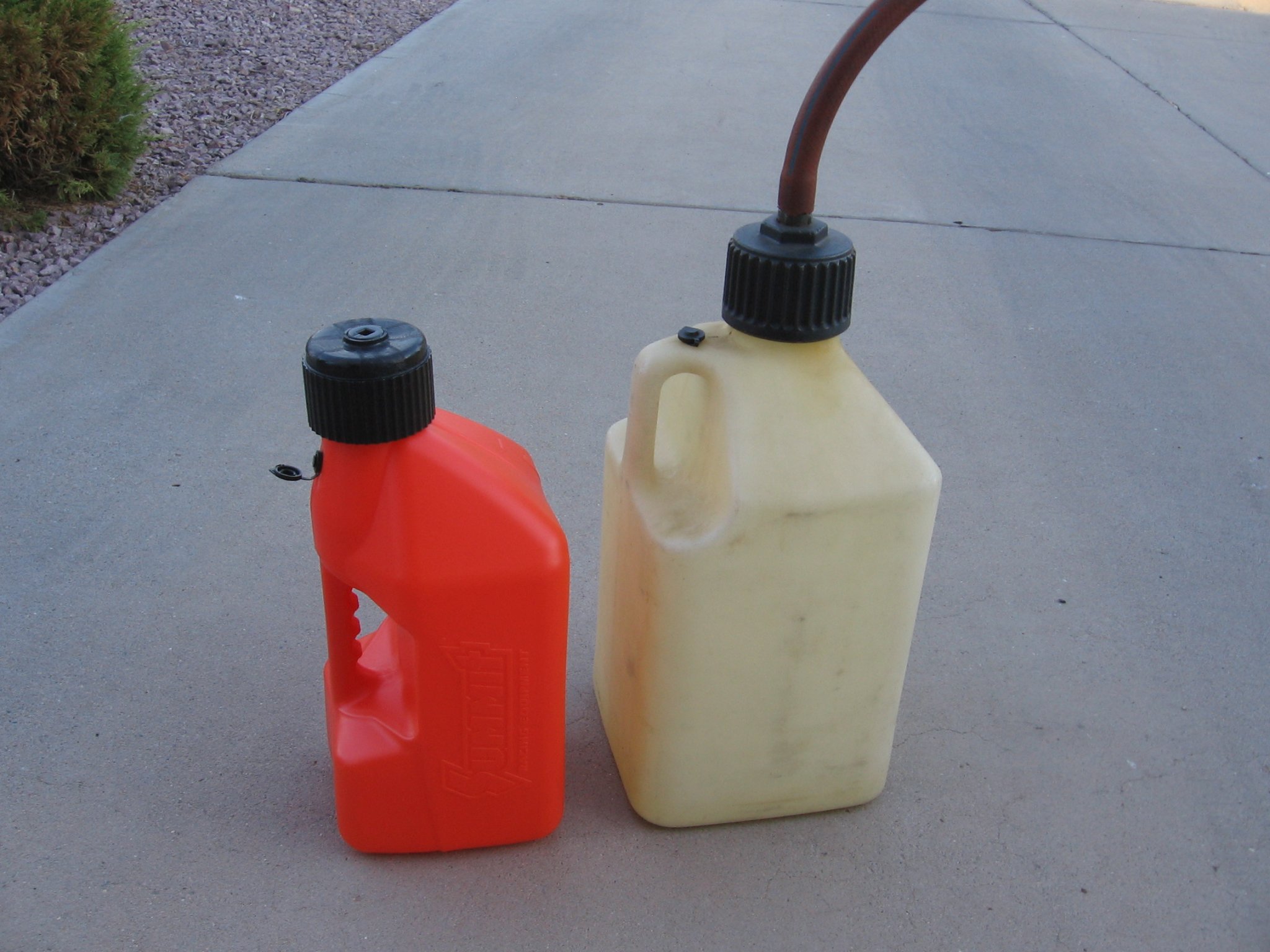

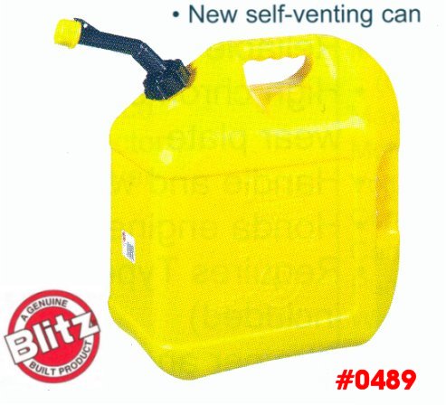

5gal cans like these:
And to make it easier to pour under the hood, 2.7 gal can like this:

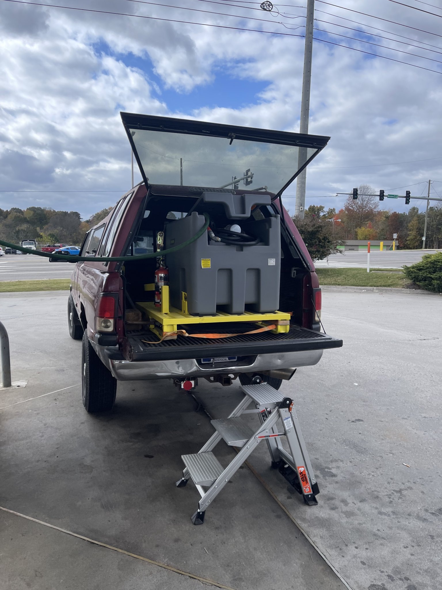

100 gallon tank on a home-made skid with 12 pump and meter. Have a Anderson SB-50 connector on the tractor to plug the pump into. Load it in the back of the pickup and take it to fill it up.

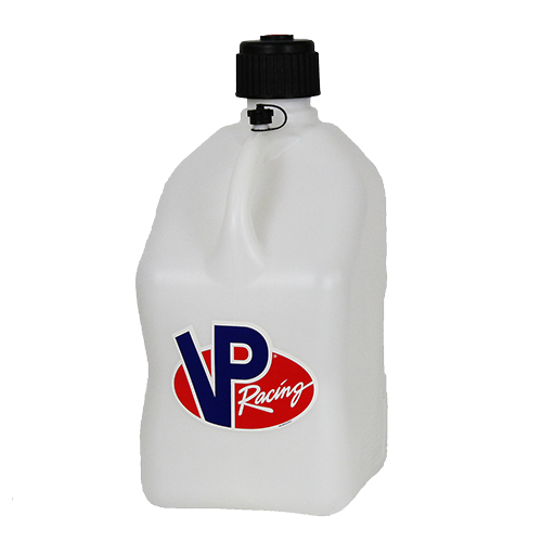

View attachment 147132 View attachment 147133
I use the VP racing jug over here in the UK, for us they aren’t “For Road Use” or whatever it is they class it as here so the pump stations can deny you filling them up which happened to me once. What I tend to do is use a proper jerry can then decant it in to the race jug.
At work I just use the race jug filling it straight from the fuel tank.

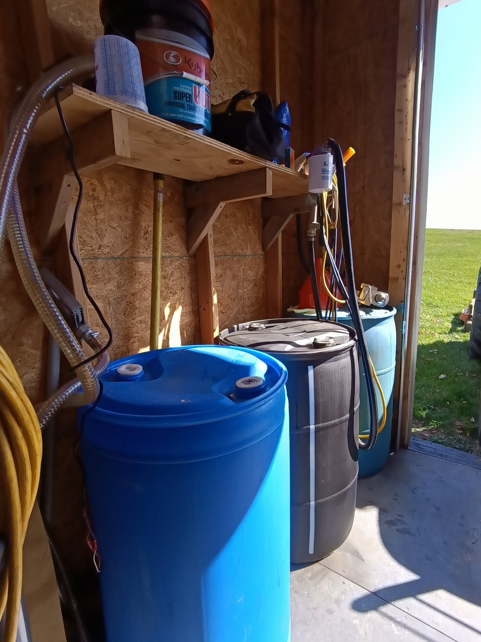

For years it was a bunch of yellow 5 gallon cans. Got tired of lifting and spilling as the tractors got taller. A couple years ago I went with three 55 gallon plastic drums. That allows me to get fuel cheaper (offroad and more than 100 gallon delivery). There's a 12V pump I plug into a tail on the tractors & generator to power it.
How do you transport and move those things? A drum seems like it would be top heavy in the truck and difficult to lift and carry.

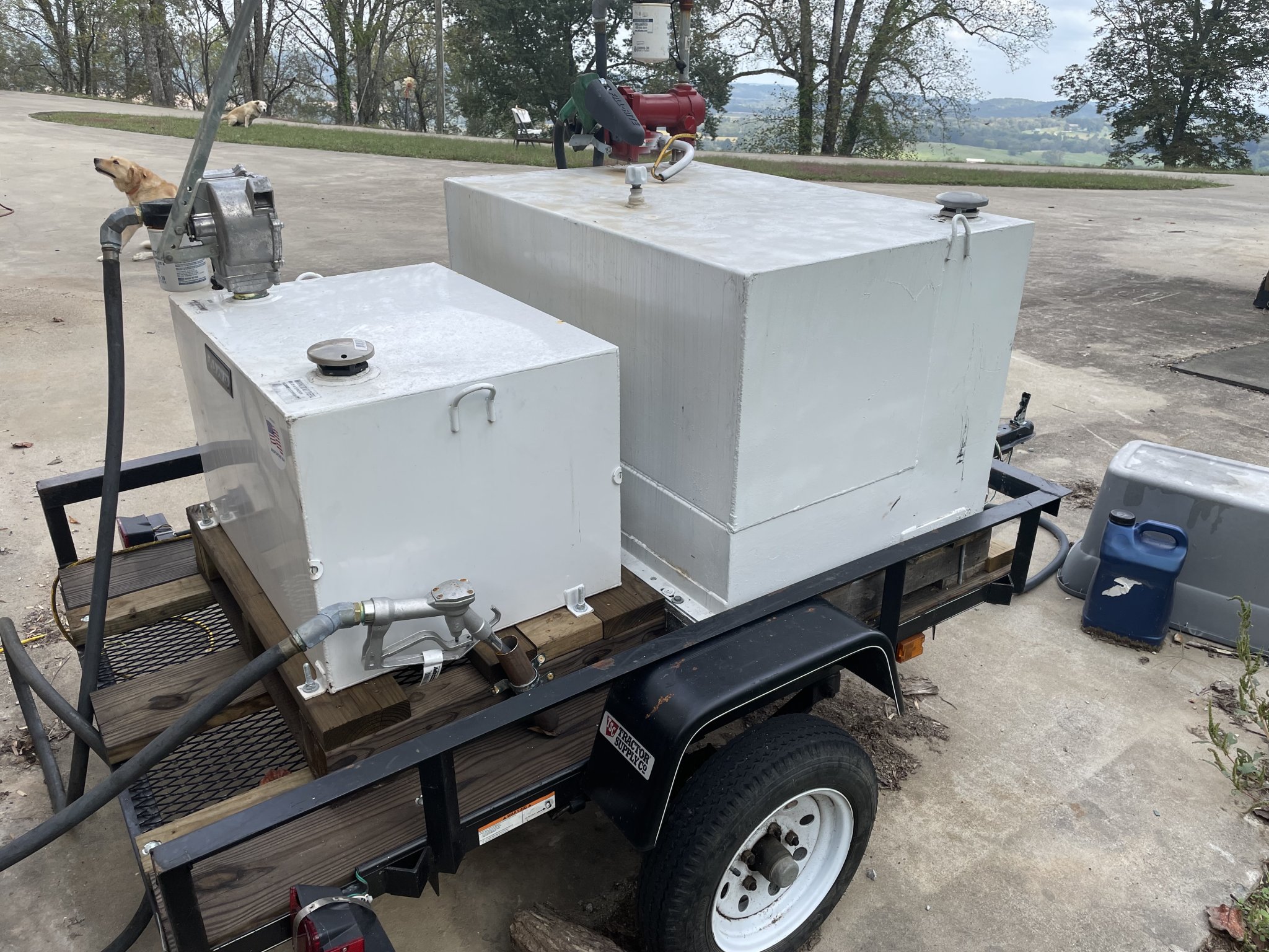

I built a fuel trailer with a nominal 105 gallon diesel tank (nominal!) and a 50 gallon gas tank on a TSC trailer:
Biggest mistake: Installing a 125 vac Filrite pump on the diesel tank instead of a 12 vdc pump.
