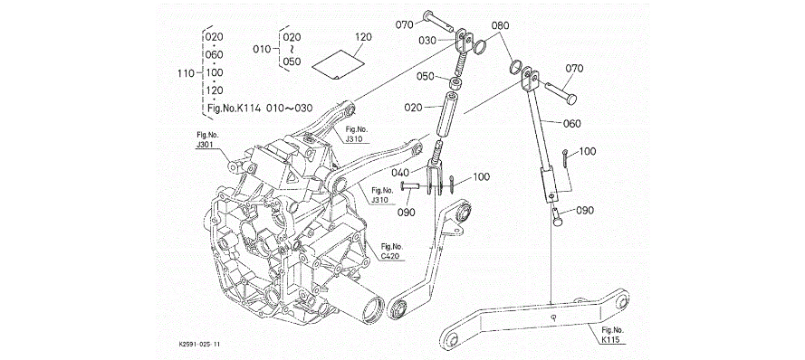

For the BX23D, here's the parts diagram ........if it's part #90 (part # 05122-71245 & #100 (75599-53194)

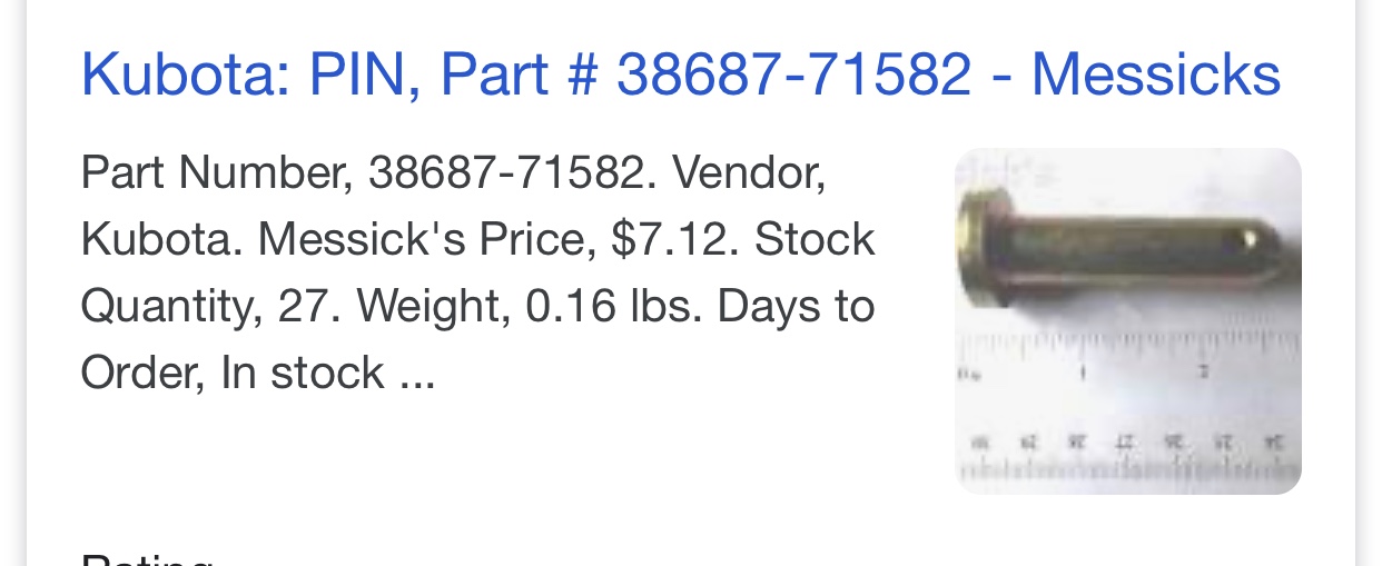

Can you pull the one on the other side to take with you to the store? (I had the same thing happen this last spring). Messick’s just calls it a ‘pin’ (different size for mine)
