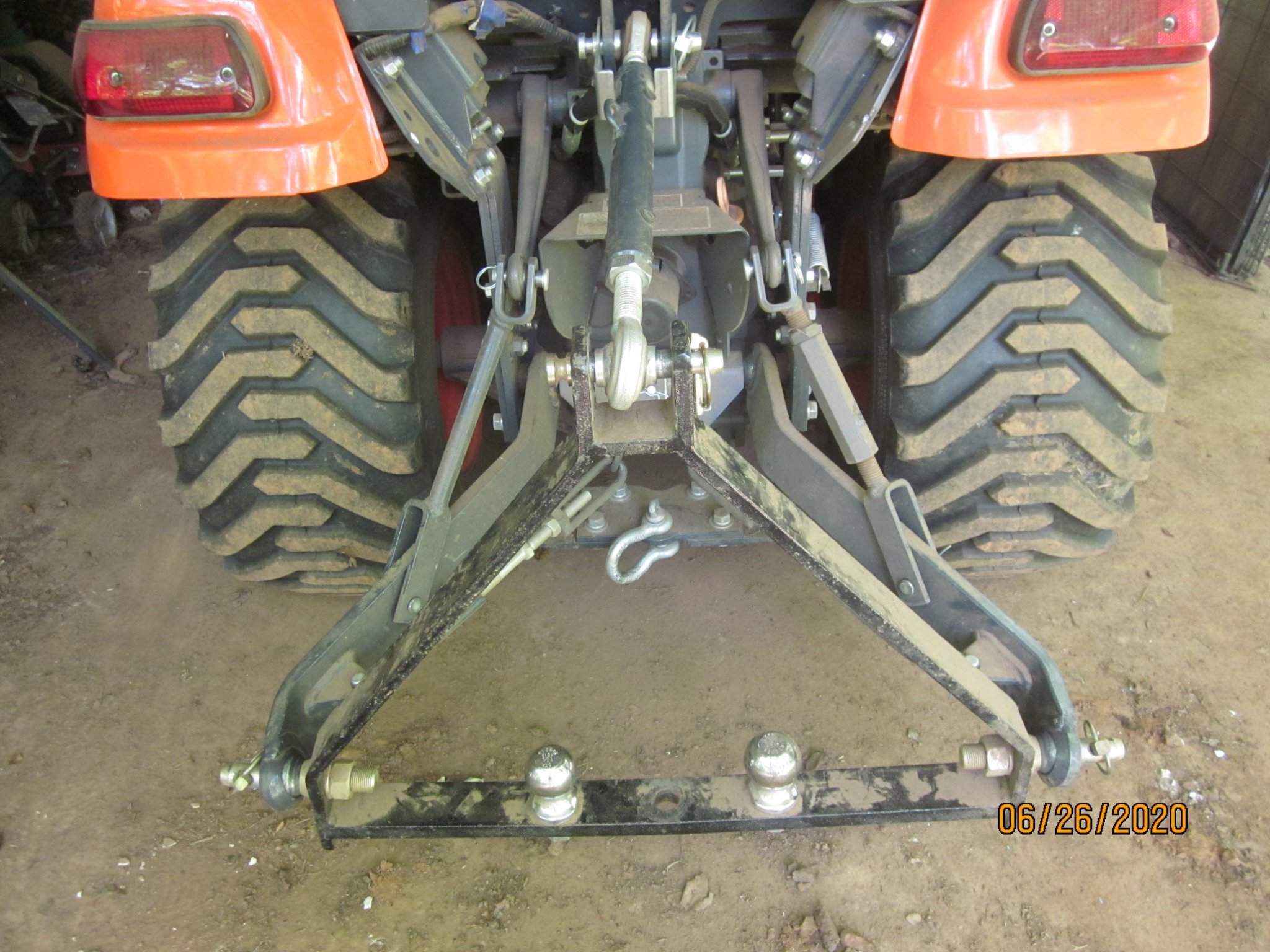

The best way to tow a trailer is to hook it to the draw bar. The problems include having to dismount to hook up the trailer. You must watch the tongue of the trailer hitting the 3 point arms. The biggest problem might be trying to find a trailer ball, if needed, to fit the draw bar.
The option several people go with is to attach the trailer to the 3 point hitch. There at least 2 ways to do this. One is a straight bar that goes from one lower arm to the other arm. https://www.ruralking.com/catalog/product/view/id/102943 There is also a piece needed to keep the bar from rolling. https://www.ruralking.com/catalog/product/view/id/120417 The other is a draw bar that goes from arm to arm and hooks to the top link. https://www.amazon.com/Receiver-Tra...t=&hvlocphy=9012067&hvtargid=pla-767386958564
Understand that there is nothing to keep the 3 point from coming up. If you over load the rear of the trailer the tongue will raise up.

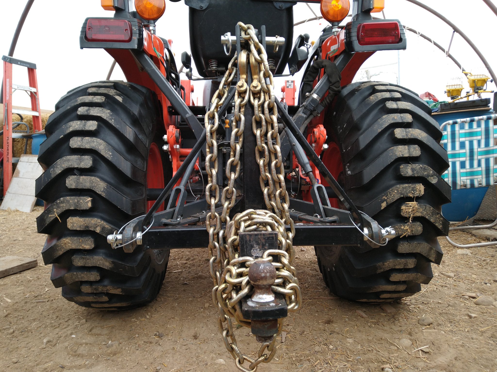

I use my 3-point receiver adapter for a lot of different work, including trailer hauling. I haven't had a problem with the trailer tongue pushing up the 3-point. It's happened, but no damage or any other issue ensued. Was when dumping a firewood load the load pushed down the back of the trailer as it slid off, trailer front went up to 3-point limit, so I pulled forward slowly and 3-point slowly lowered. No worries. I'm ready for it.
The hitch adapter lives on top of my box scraper when not attached, handy, and is an added rear ballast and box scraper working down-weight, too.
