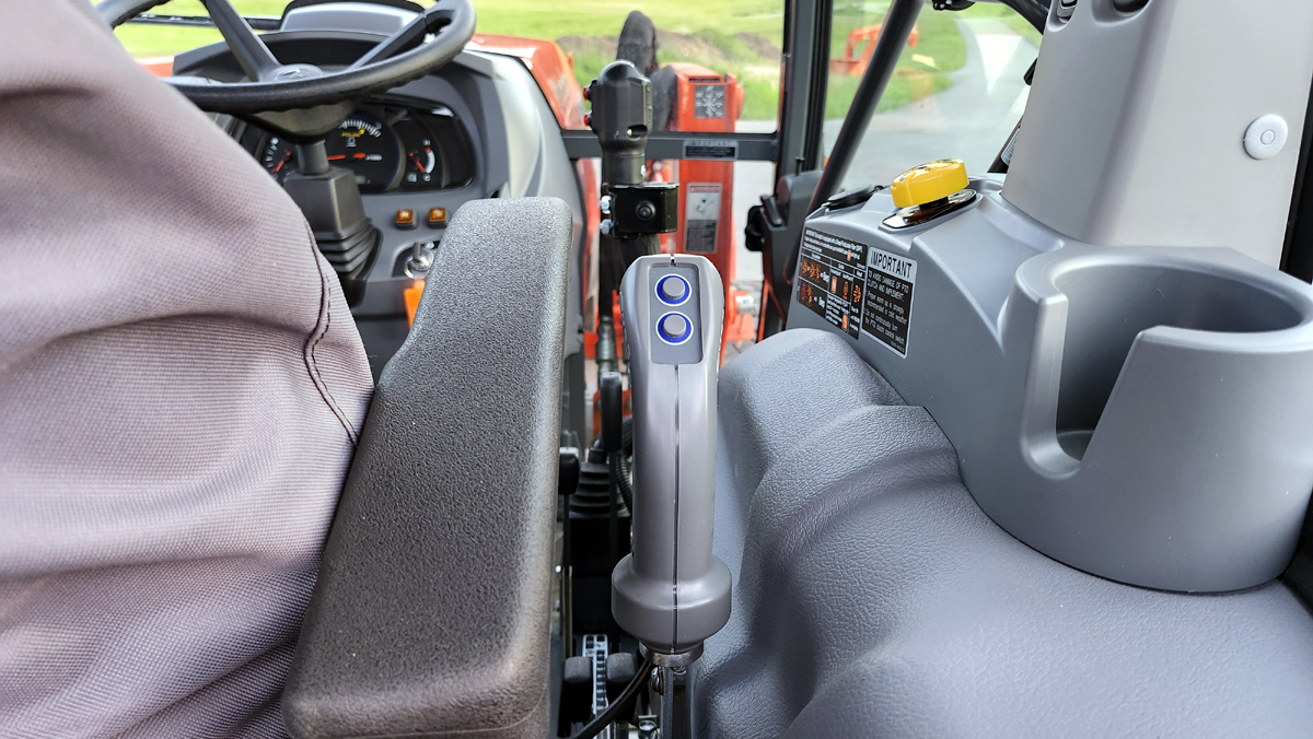

I ran the Del Morino a bit this morning to clear an area for a trailer, and the offset feature is invaluable to me. The ability to quickly change the distance to an obstacle such as a fence line, hedge or wall without having to reposition the tractor is a game changer for sure. The ability to quickly change the angle of the cutting head is also a great feature, and the recent addition of a Summit 3X multiplier with a Scorpion control grip is another game changer for the MX. Now I can control cutting head rotation and cutting head offset without taking my hand off the lever.
The other benefit of adding the control grip is that it makes the control far more accessible (and far more ergonomic) rather than being tucked down between the arm rest and inner fender.

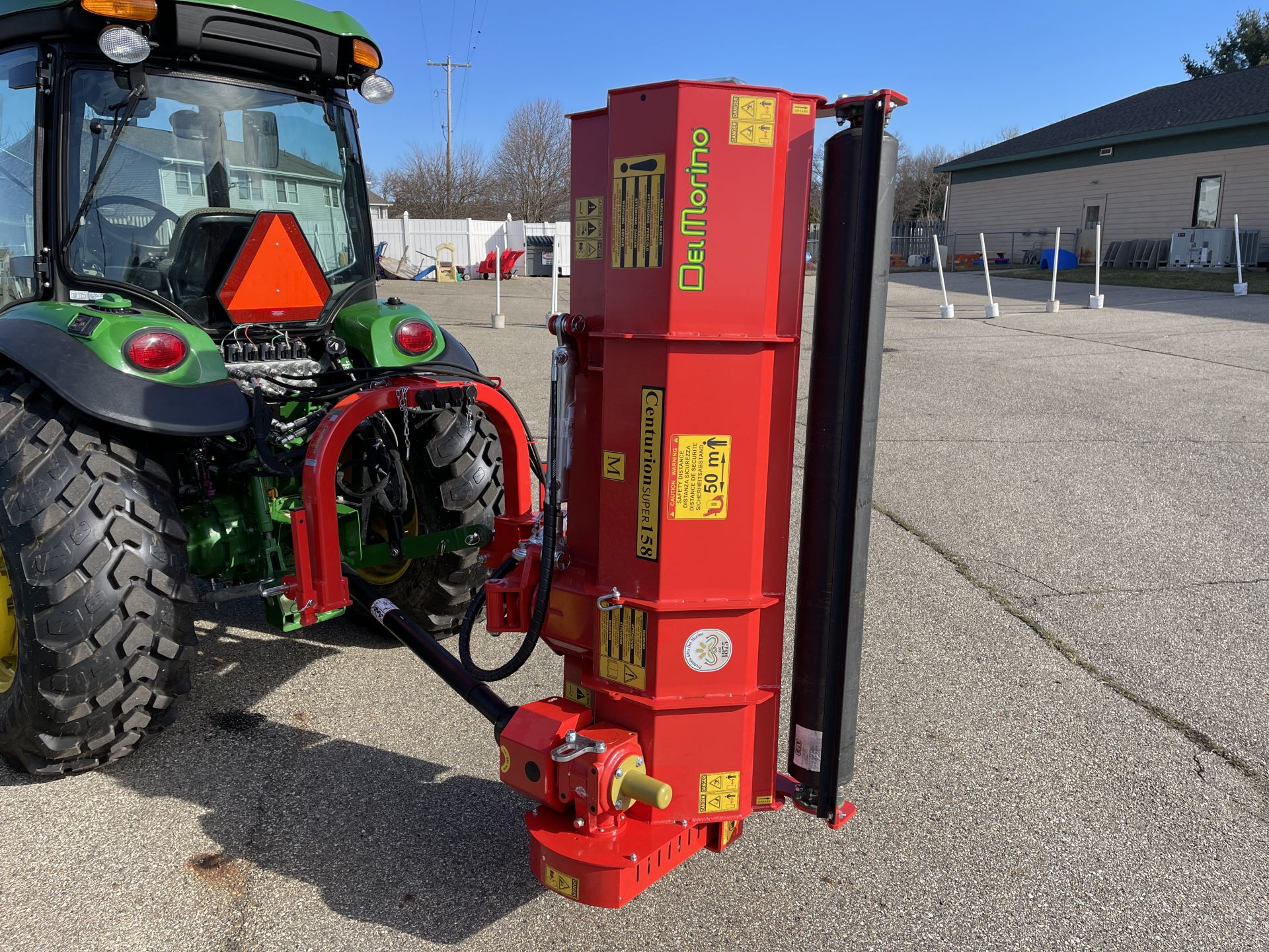

What model are you running? Can you run it vertically? I want to be able to cut shrubs along fencelines

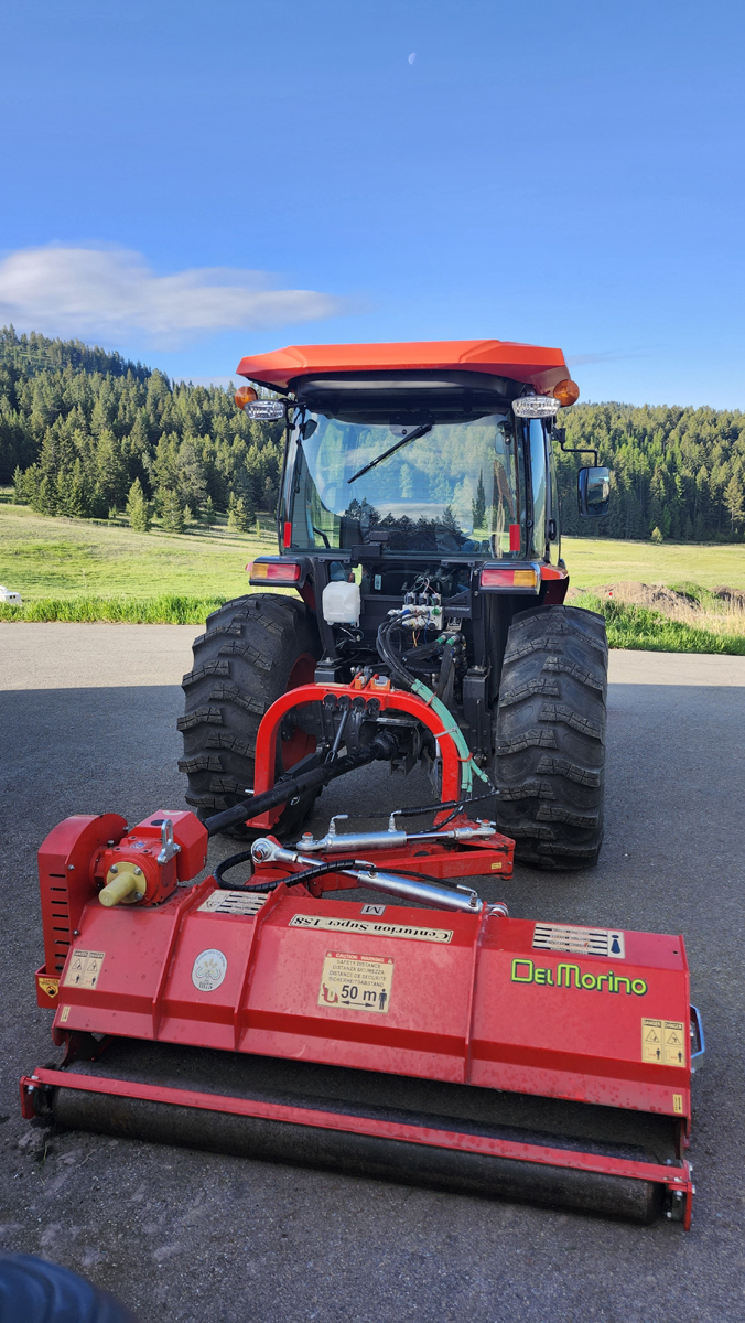

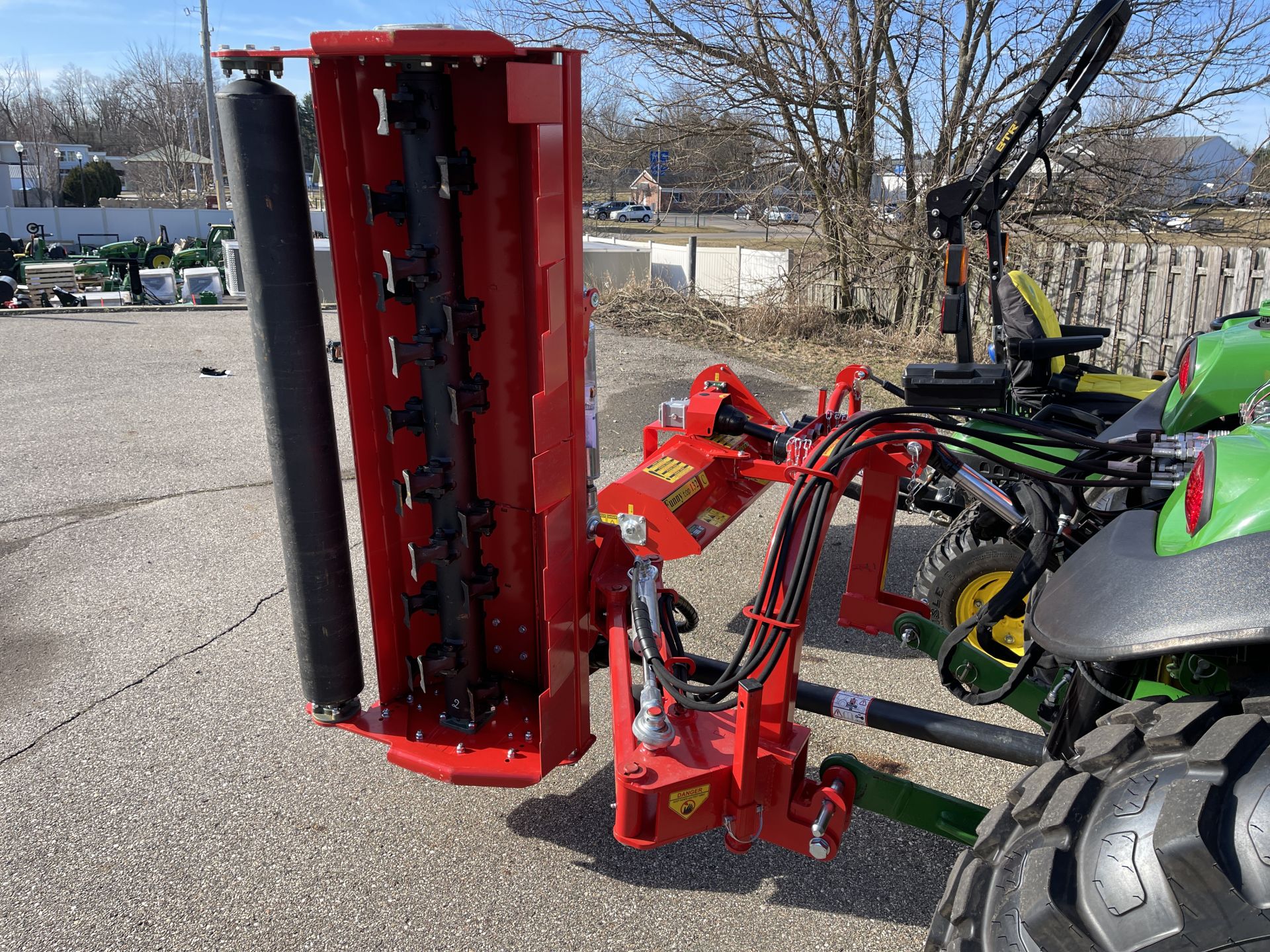

Del Morino Centurion Super 158, and yes, the cutting head can be rotated through a total angle of 135° with 0° to +90° and 0° to -45°. These photos from GWTC might help.
I don't currently have a need to cut vegetation with the head oriented in the vertical position, but the ability to adjust the cutting head angle on the fly, and to offset it are invaluable features that I constantly use.

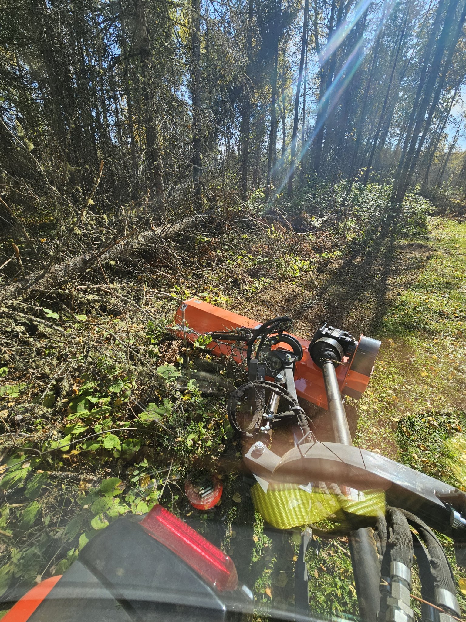

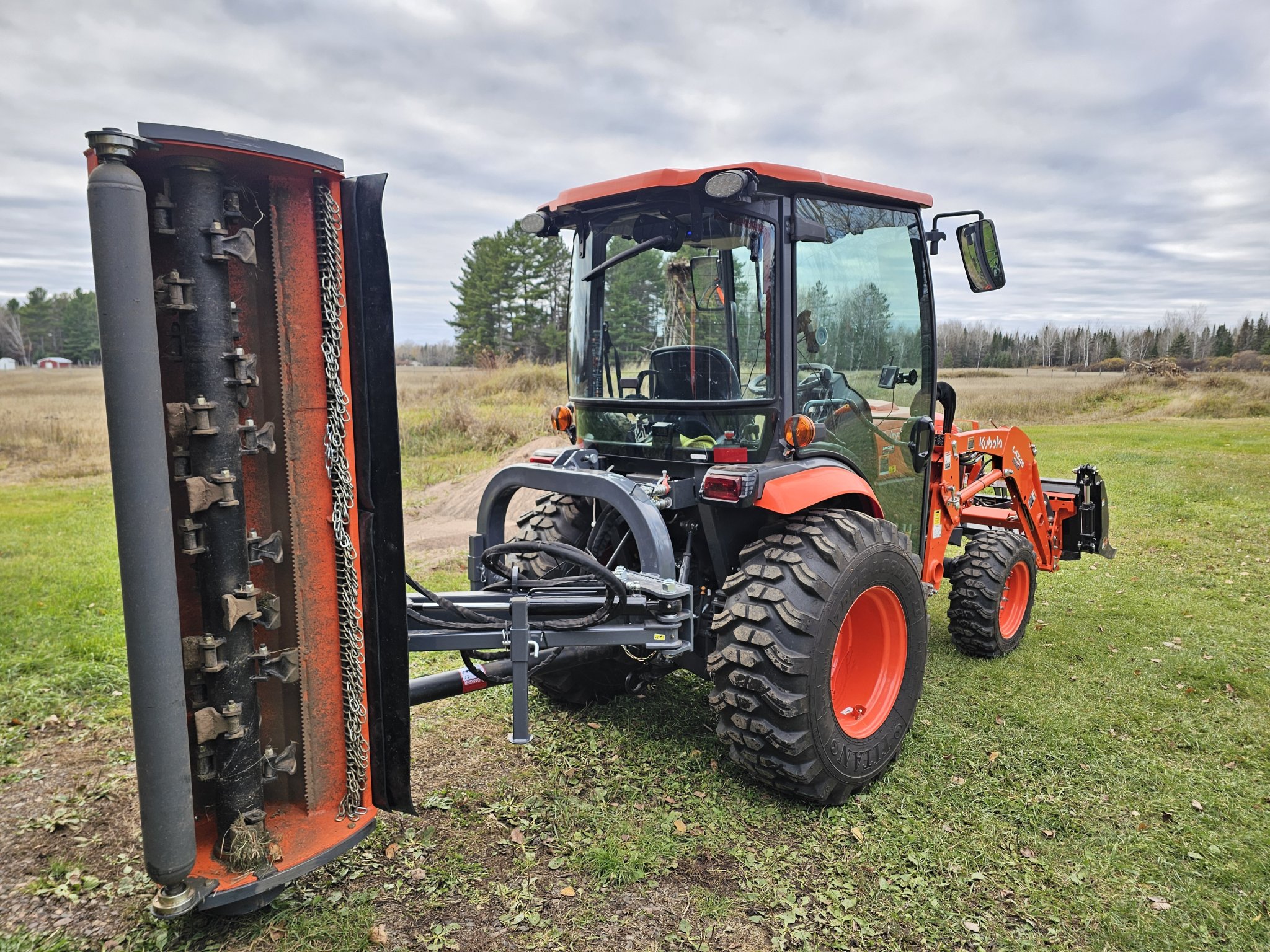

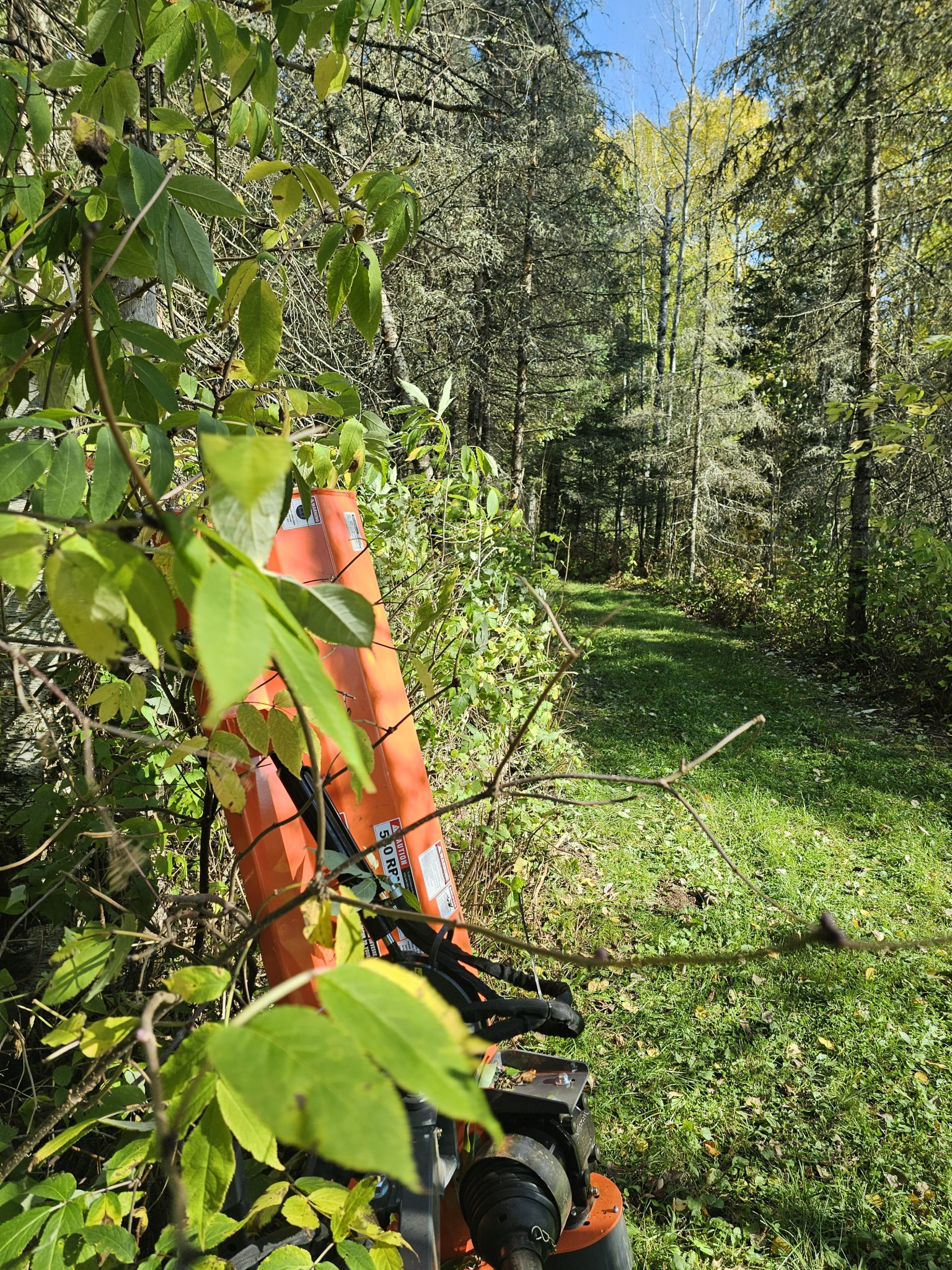

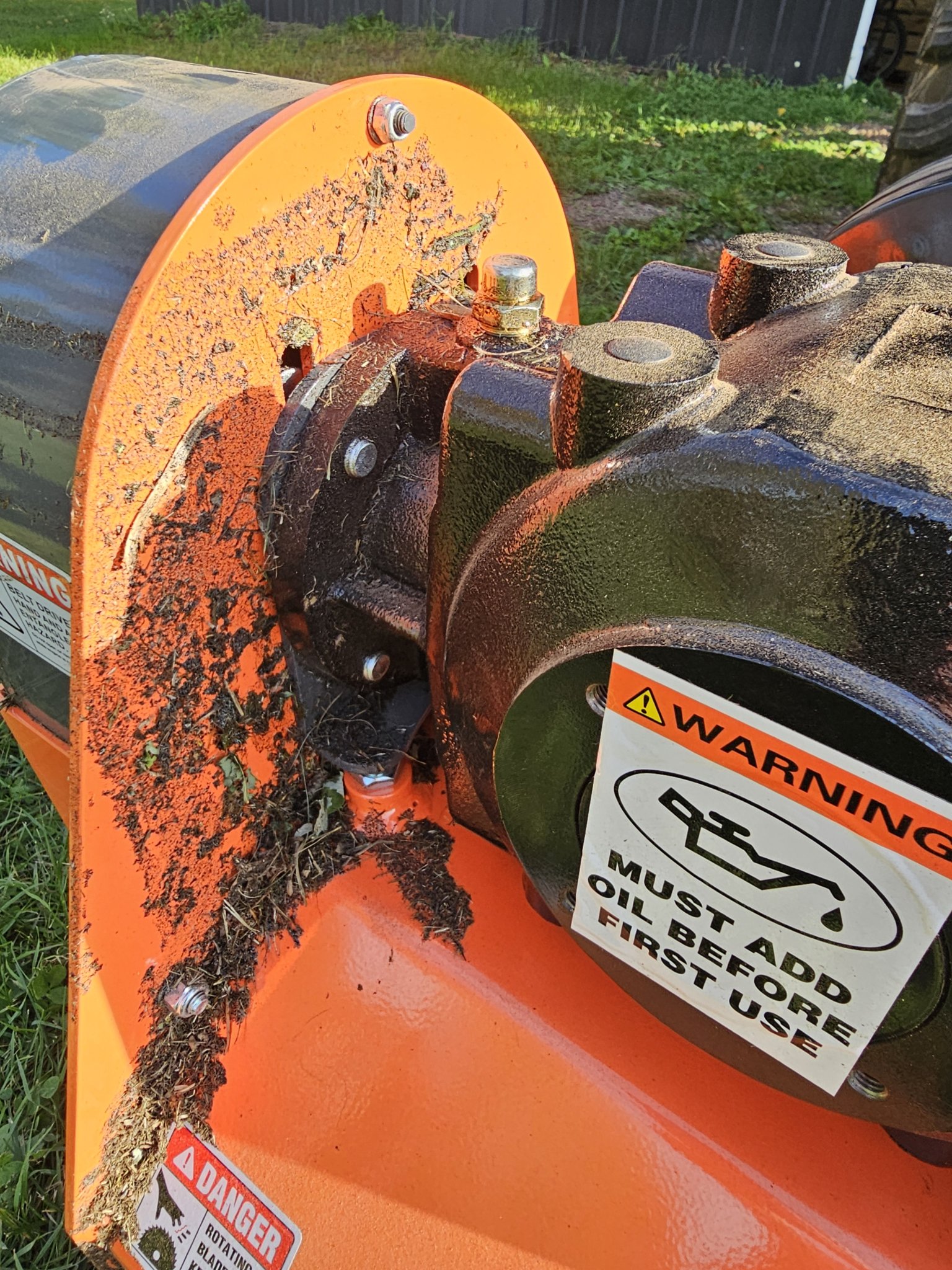

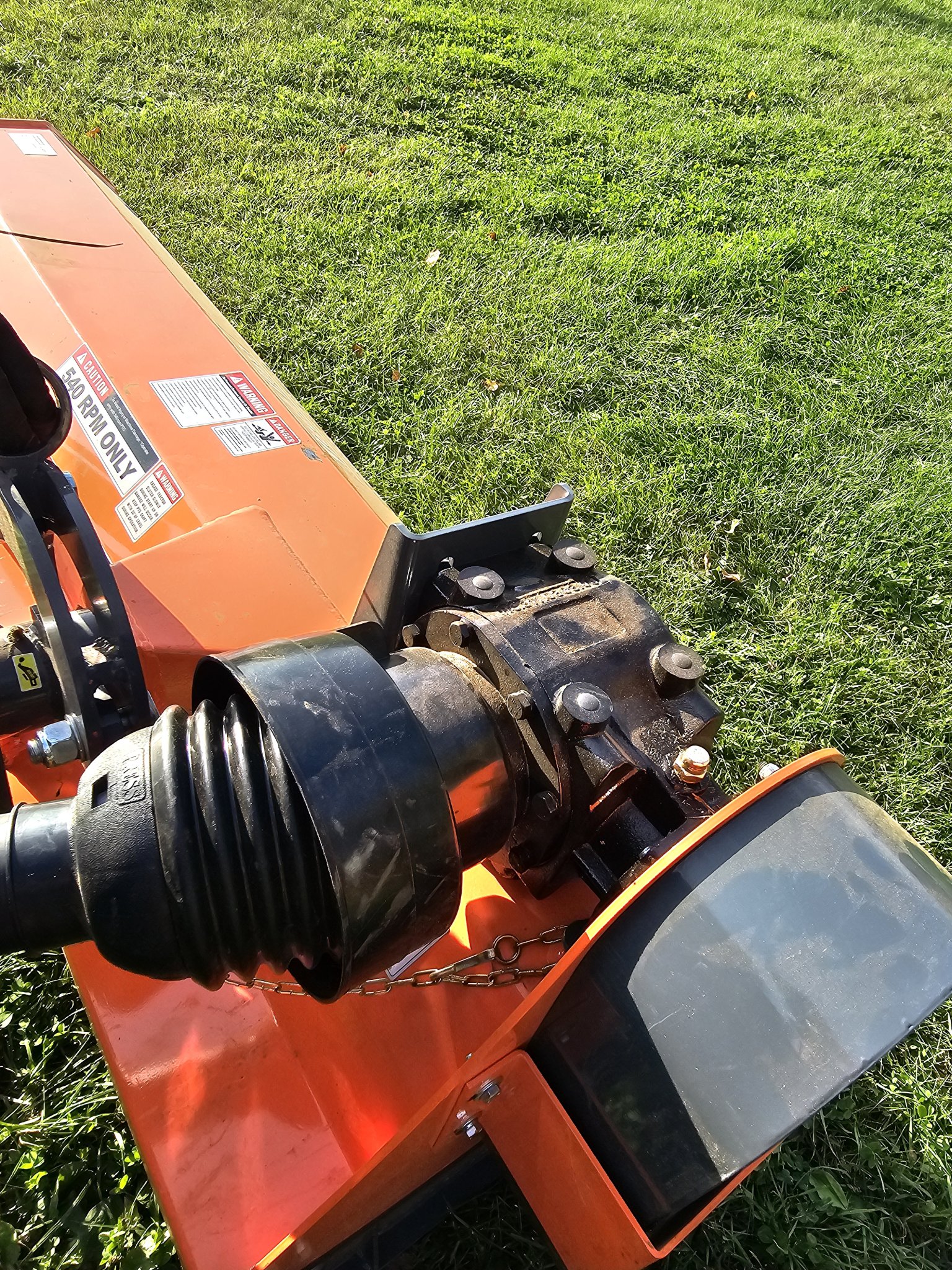

My first MechMaxx product was a stump grinder, 5 star experience with this item! It's simple, and simply works.
This 65" offset flail mower seems to be built nice and heavy duty, and arrived in good condition. I used it and then spent a little over a week going back and forth with MechMaxx customer service daily in regard to the gearbox though, which seems to have just been a waste of my time. I'm guessing the gearbox is the same as on their standard flail mowers, which are always horizontal. If you look at the location of the vented fill plug while keeping in mind that the offset flail mowers are advertised for vertical use, think about what this vented fill plug is going to do in the vertical position.... Yep, it's going to loose gear oil!
According to MechMaxx this is normal and isn't a problem. I disagree.
*It also seems that they don't allow reviews on their site that are less than 4 stars. My 1, 2, and 3 star attempts wouldn't post, but at 4 stars they let it post.
I'm also adding a rubber flap to the front edge to better contain debris. The little chains it came with are only partially effective in the horizontal position, and they are worthless in the vertical position (they drop vertically with gravity, go figure...)
Weekend update- Added a rubber flap in front the safety chains, HUGE improvement!
