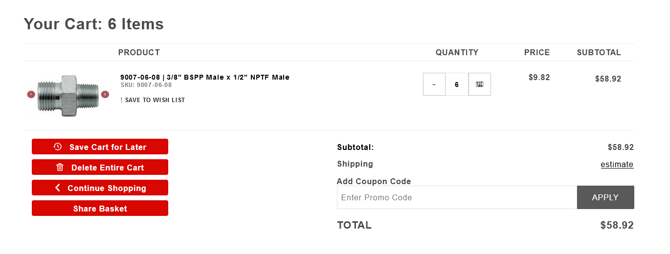

@WI_Hedgehog, thanks for the link to Discount Hydraulic Hose. The adapters on Amazon are a rip off at $147.74 with shipping (and I'm a Prime customer!). With shipping, the "same" fittings from DHH are less than half the cost.

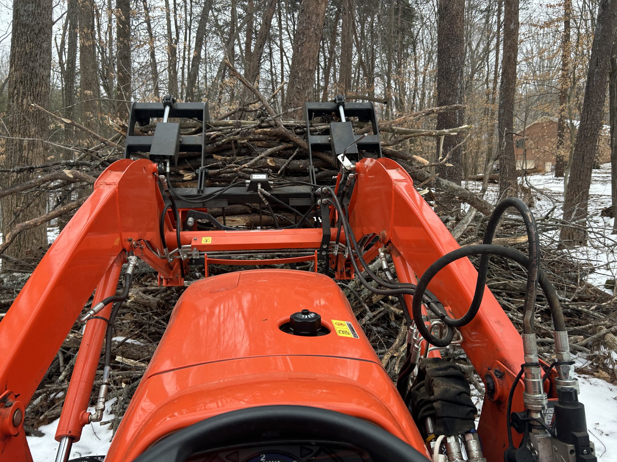

Had a little wind yesterday. Not much, but enough to topple an aging out Virginia Pine. It was hanging over one of our trails and we have guests coming tomorrow so needed to get it at least cleaned up enough to clear the trail today despite ground still being covered by snow on top of a sheet of ice.
Started with a double line pull with a redirect to finish pulling it off the stump and clear of a smaller tree I preferred not to take out.
That went pretty well. Let it sit a few minutes to make sure it wasn’t going to move any further on its own.
Rehooked a single line pull to pull it straight back. That put it on the ground.
Virginia pines don’t self prune so even healthy ones have a bunch of dead limbs below the crown. Its crown was still green, but the bottom was clearly in bad shape.
Grappled a couple trunk sections and a pile of limbs to their respective piles.
A few minutes with a leaf blower finished off today’s part of the job. Will finish cleanup when the ice is gone and the inevitable mud dries up a bit,
The VHS website is a $hit show so no go there I'm afraid. 😂
Glad Discount Hydraulic Hose is working out for you, I order most everything but QDs from them.
The Valparaiso site is even more difficult when actually placing the order, BUT they take phone orders too. I haven't found better prices on Quick Disconnects, and given I needed boxes of them it cut my costs significantly, allowing me to switch to Flat-Face. Since the tractor is my main landscaping machine I switch implements often and FF make sense IF one can afford them.
