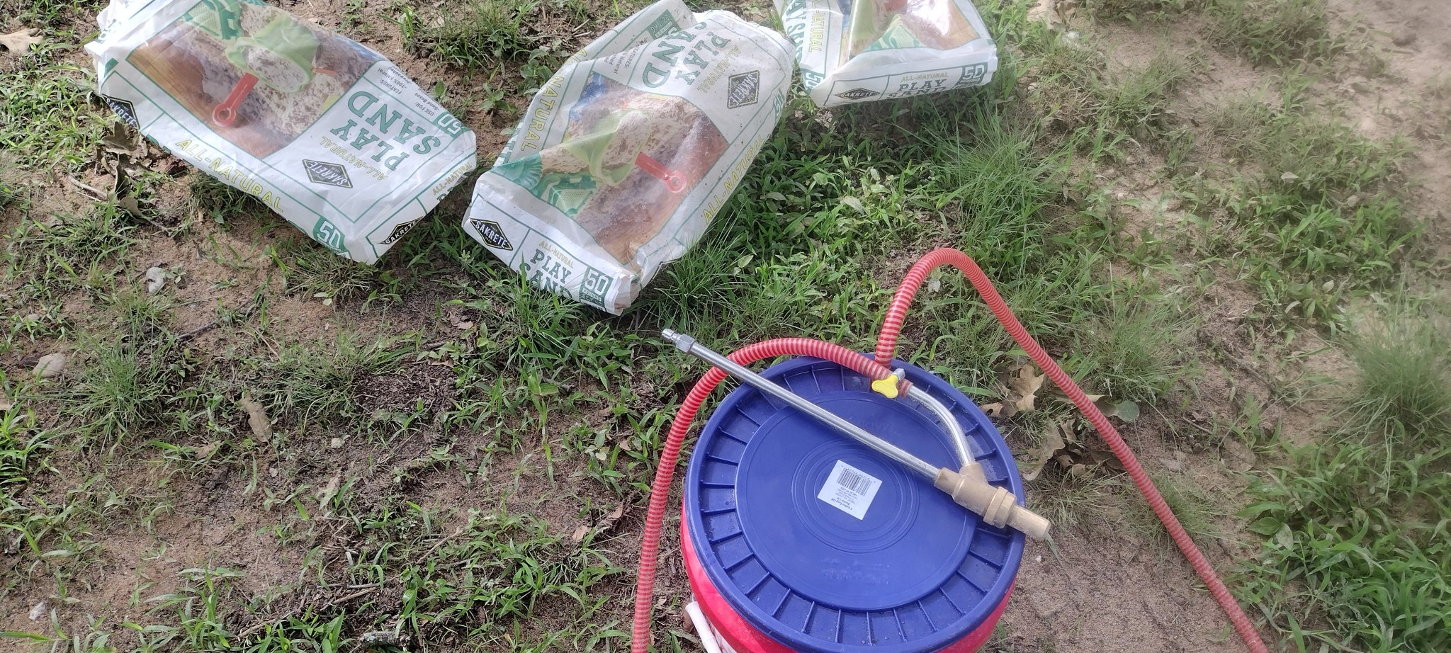

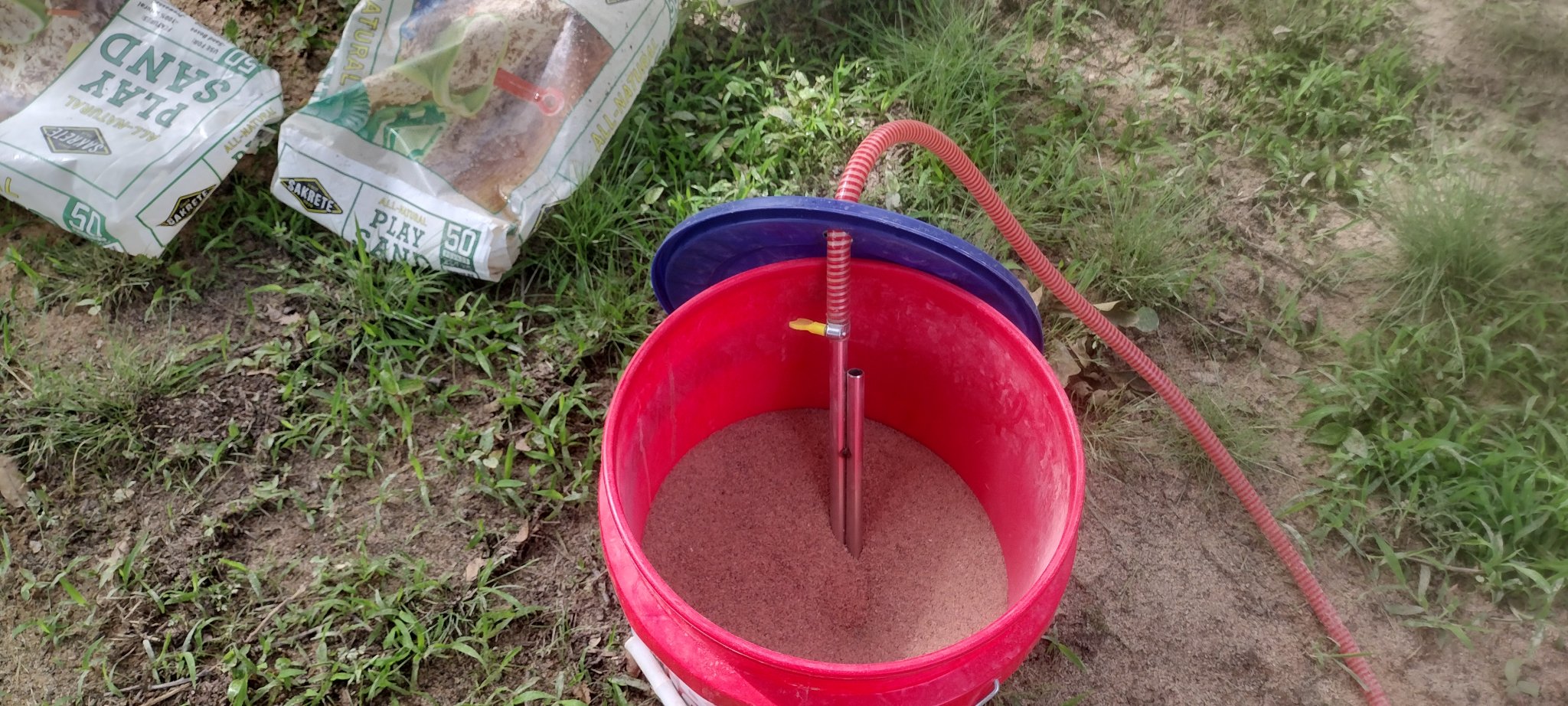

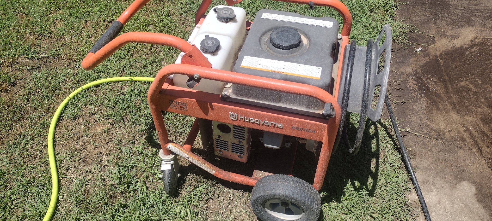

I bought this wet sandblaster from amazon 29.99 it snaps into your pressure washer wand, use playsand get the same color bag that I have because there is another playsand that has bigger sand particles in it and it will clog. I drilled a hole in a bucket lid so the sand wont get wet, if wet it will clog up. Sandblast really quick, when finished blow off with air hose or leaf blower and wipe down and you will not get any rust, then spray primer and let set a couple days and paint with Kubota paint quart can. I found out the paint dries to a touch in 4 hours but takes a week to dry hard. My washer is 3300 PSI you need at least 2800 PSI

View attachment 138452 View attachment 138453

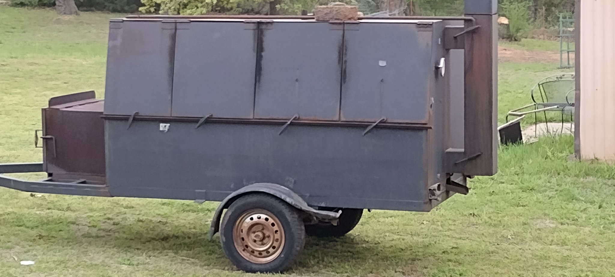

I have a large smoker I'm going to wet sandblast the fire box next, it is 3/8 thick with just surface rust.

Once again thanks for the reply. I was using black beauty for the media. That’s some pretty aggressive stuff. Might have to give your sand a try. Not sure what the pressure is on my power washer but I will look that up in the manual tomorrow.
