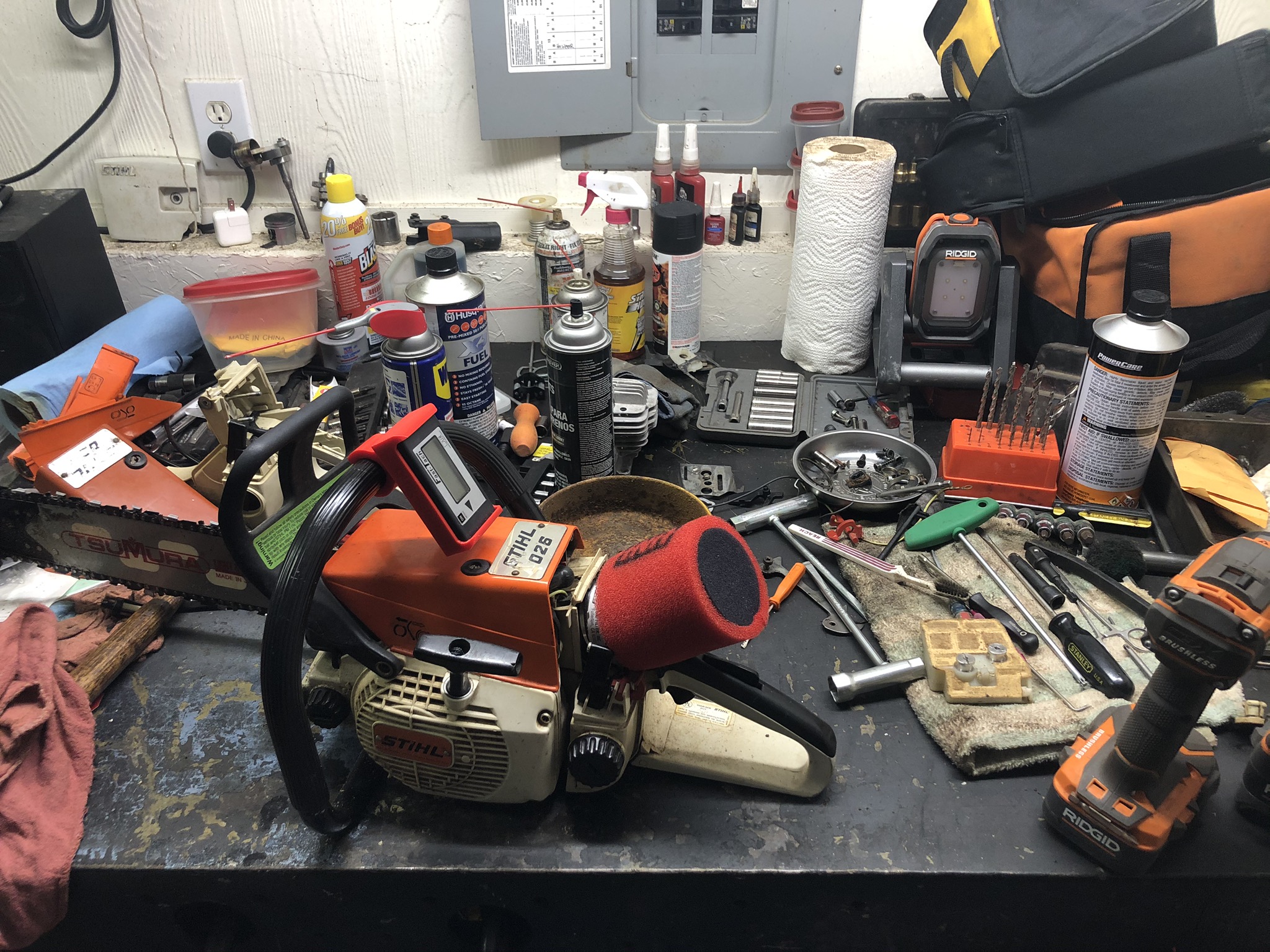

Have you sourced a filter yet? UNI makes some that will clamp around that aluminum but on the carb. I have one on my play saw.

Hey Matt! That almost looks like a beer coozie! But yes, my air filter was already done. I had planned to do something like your example. But then I found that piece of aluminum in my junk box that just screamed to be made into a filter housing. I could probably find a little bit finer material to cut into shape for a replacement filter element, though.
What's that gadget clamped to your main handle bar on the saw? I swear we share the same workbench!
David
That is a tachometer and a 3D printed holder. I was tuning after adding a bigger carb and filter stack.
As for the work bench, I’m sure you and others are the same, I know where everything is!

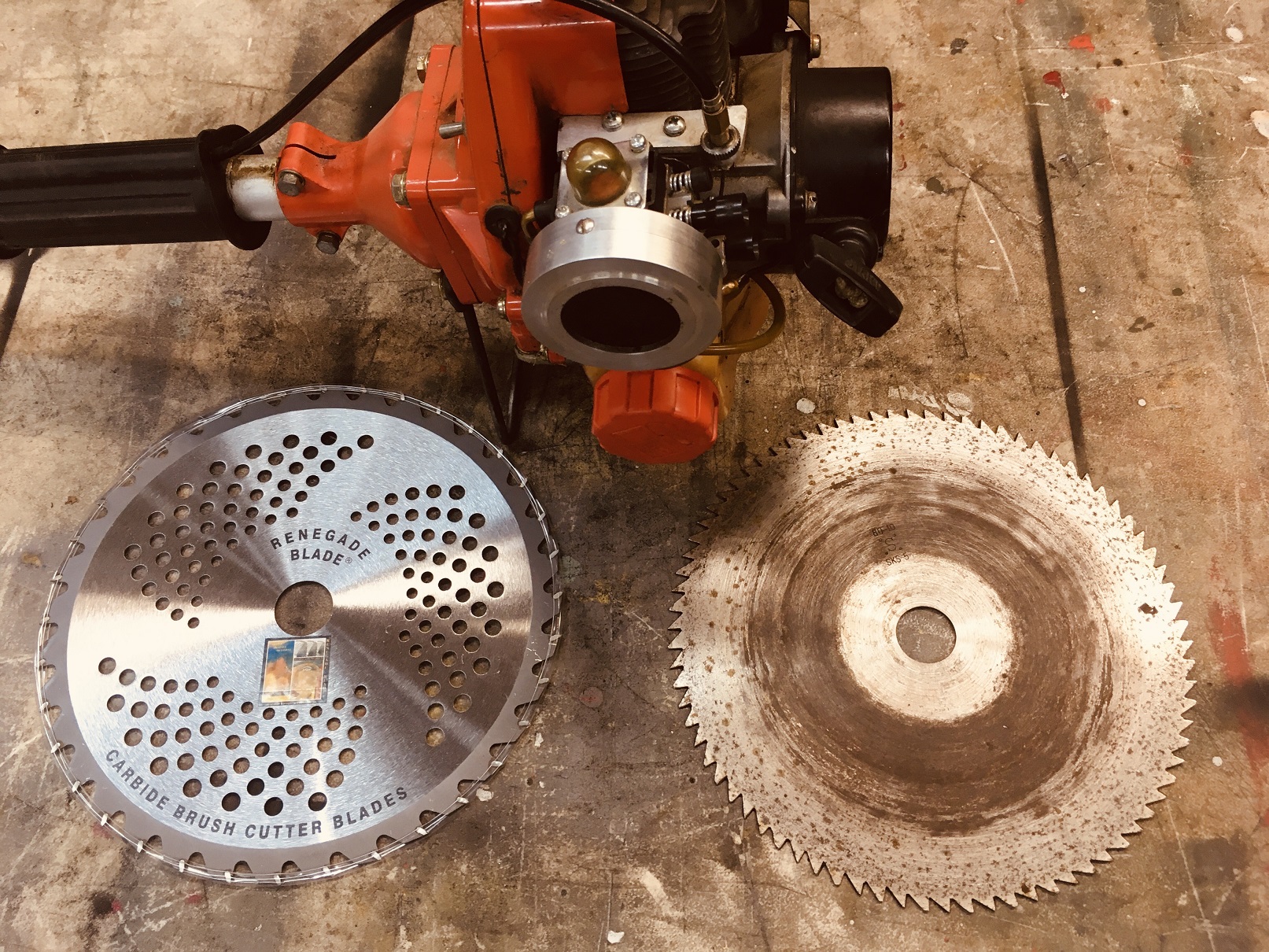

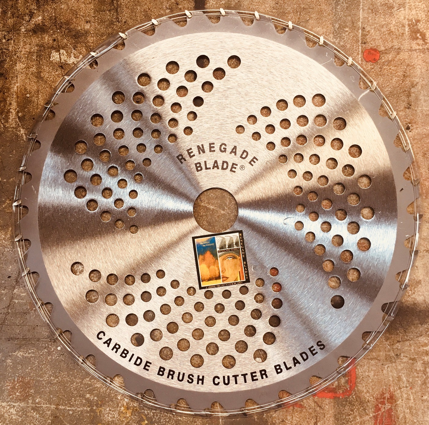

Here's a couple of pics of the brush cutter blades. One pic shows the original with the new. And a close up of just the new blade. Those new thin kerf carbide tipped blades made the old blade seem like a butter knife...even when it was new!

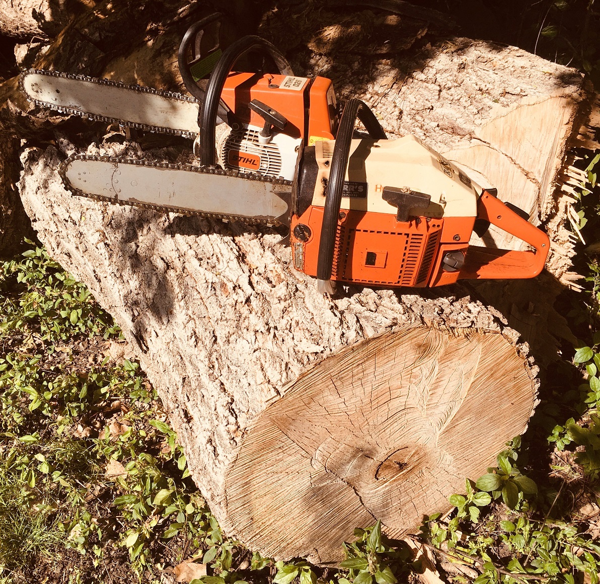

and here's a pic of my chainsaw lineup: In the background is the Stihl 026. Up front is my 1970's Husqvarna 61. The Husqvarna is more of a beast compared to the Stihl and just will not die. It'll probably do me in one day instead! :unsure:
View attachment 61715 View attachment 61716
I have that same blade on my weedeater, it does a fine job!
