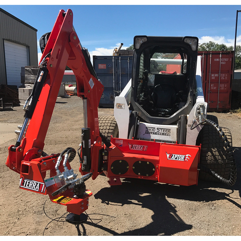

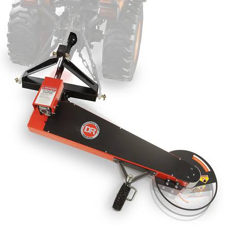

I've kicked around the idea of buying something like that for steep road ditches and fence lines where rotary blades or discs are risky.
for the rest of us without the skills or patience to build our own, thankfully there's a few options out there for us.
I really like this except for the cost. 😀

That's why I built mine. Not as flexible or nicely finished, but even with the new gearbox and the bearings and belts I had to buy, it's about 1/10th the cost of a commercial unit.
