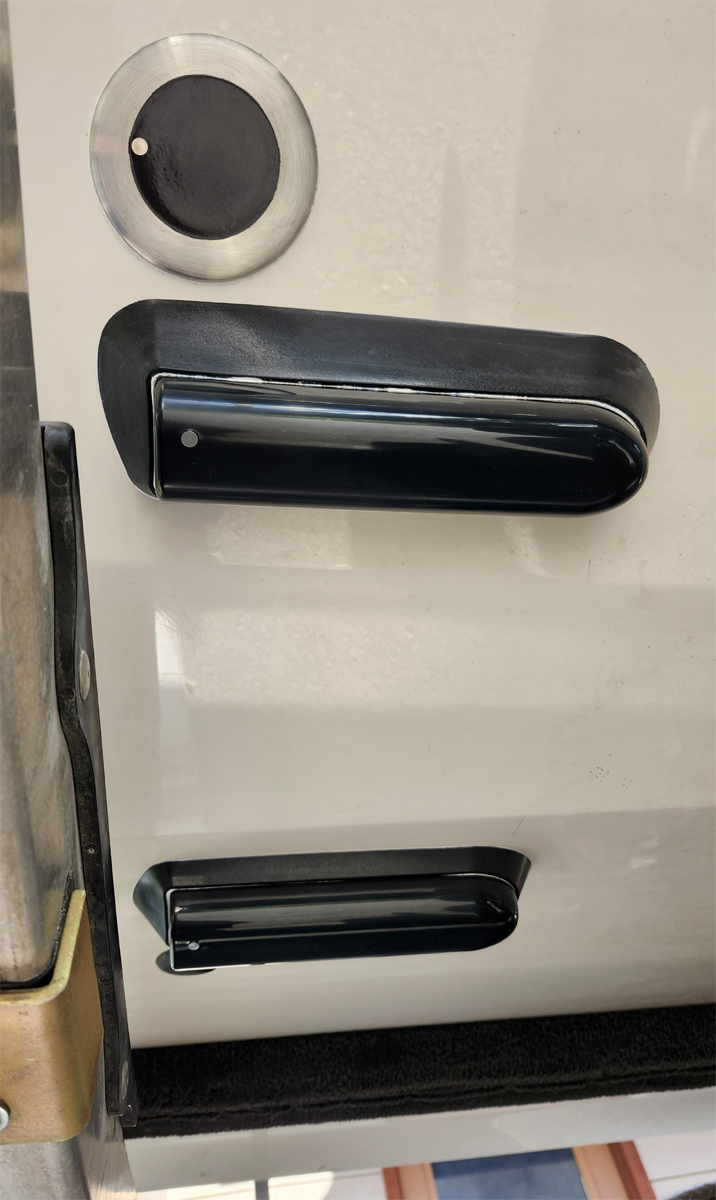

Here's the old AIRMAR transducer with the marge larger and more capable Garmin transducer.

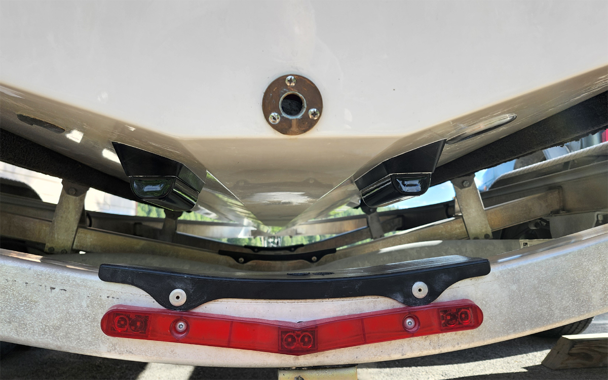

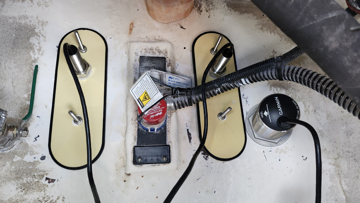

Here are the three new transducers installed in the hull along with the view from underneath the boat. Transducer placement is important, and since the boat has an 18 degree deadrise I had to install one on each side of the keel. The long transducers are ClearView/SideView models.

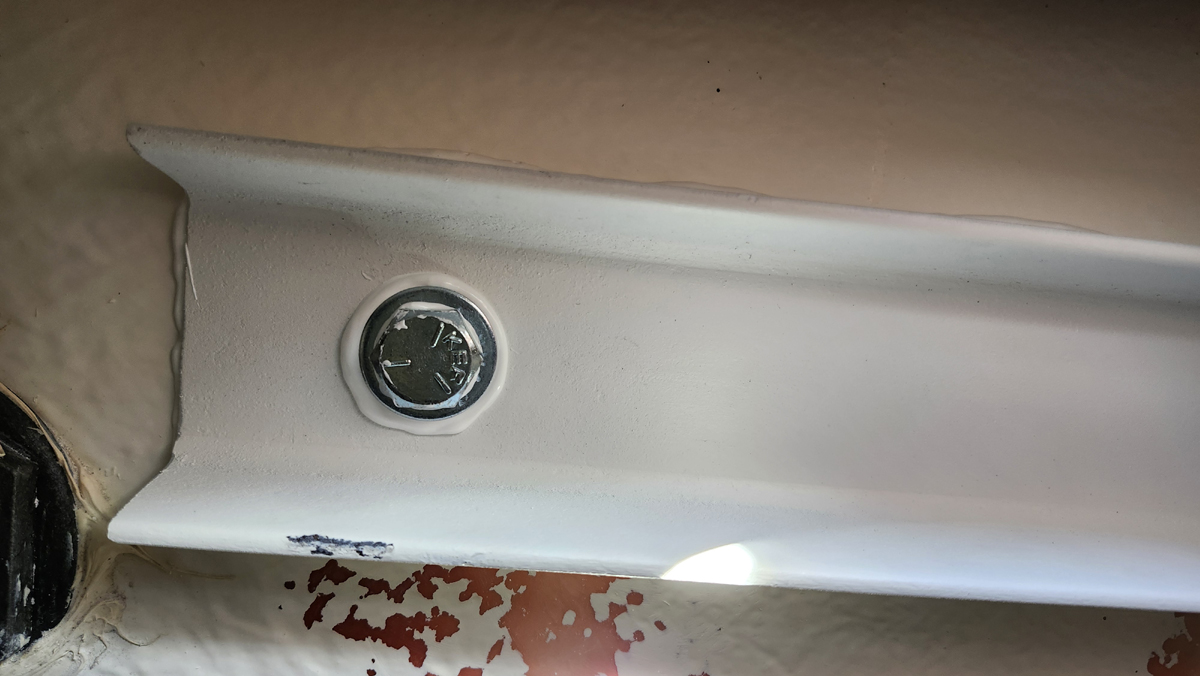

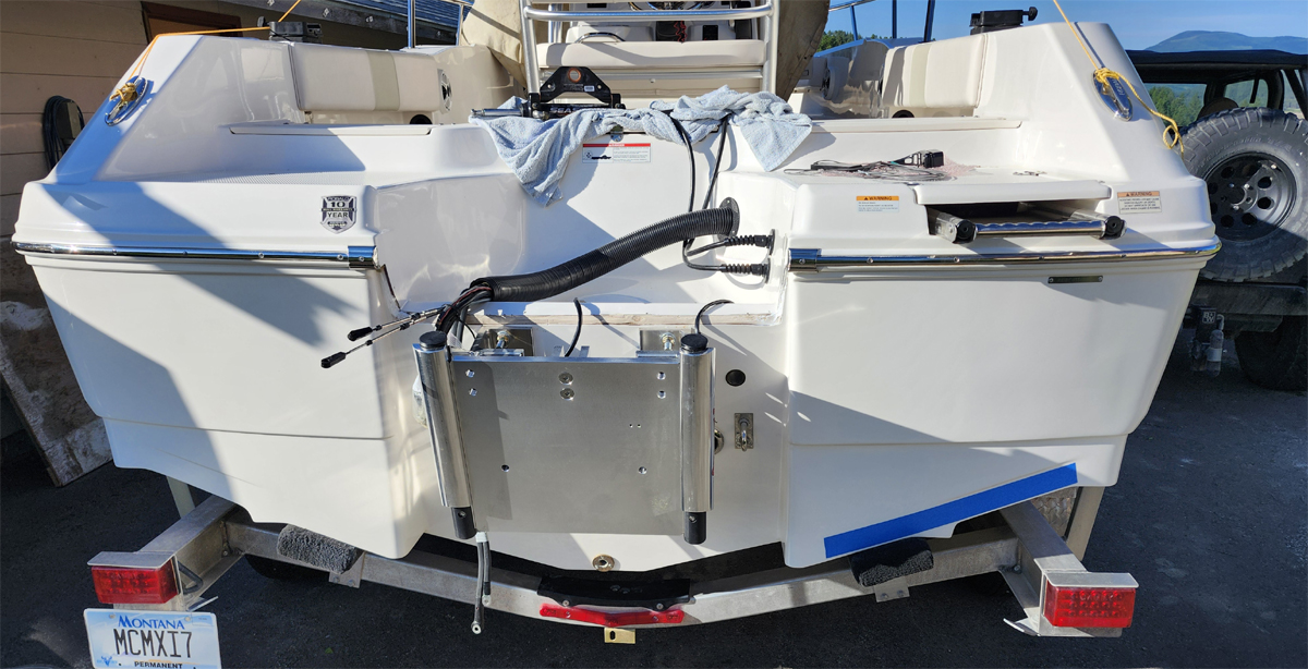

Here's the jack plate installed and the bit of "machining" I had to do to clear one of the through-hull fittings. I cut and drilled a section of 3" c-channel to install on the inside of the transom to support the load. The upper bolts have a cast aluminum ROBALO branded plate that serves as a backer plate to support the load.

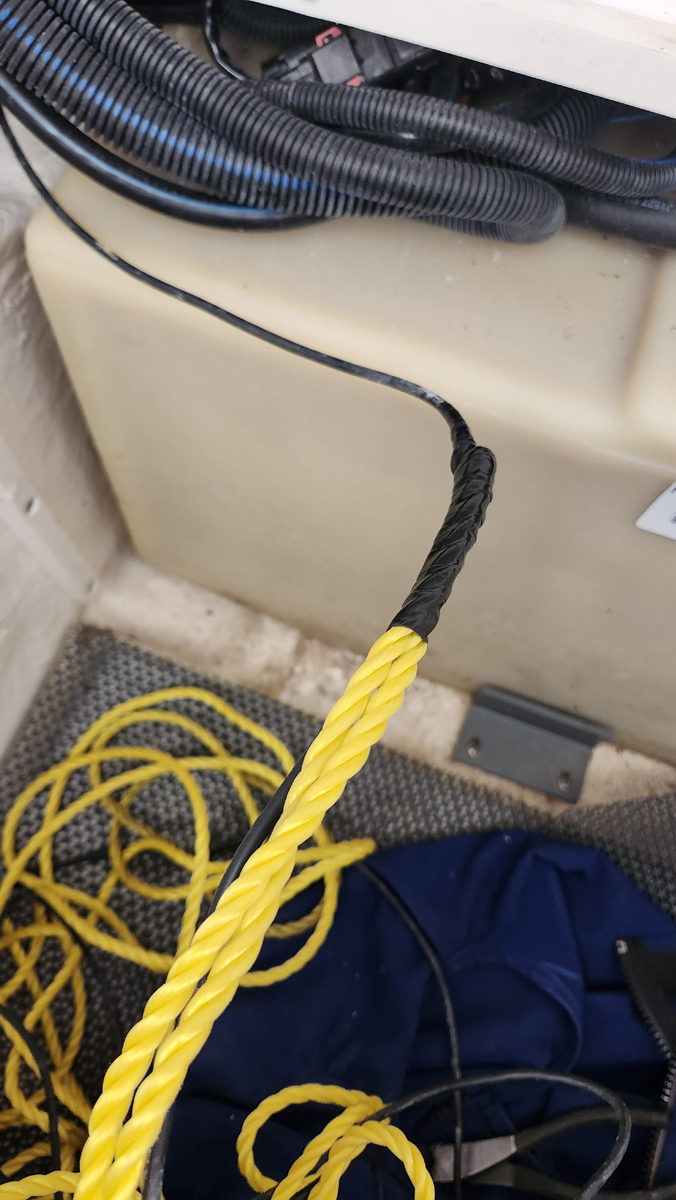

So here are some photos of both ends of the rigging tube and the old transducer cable and two nylon lines already pulled.

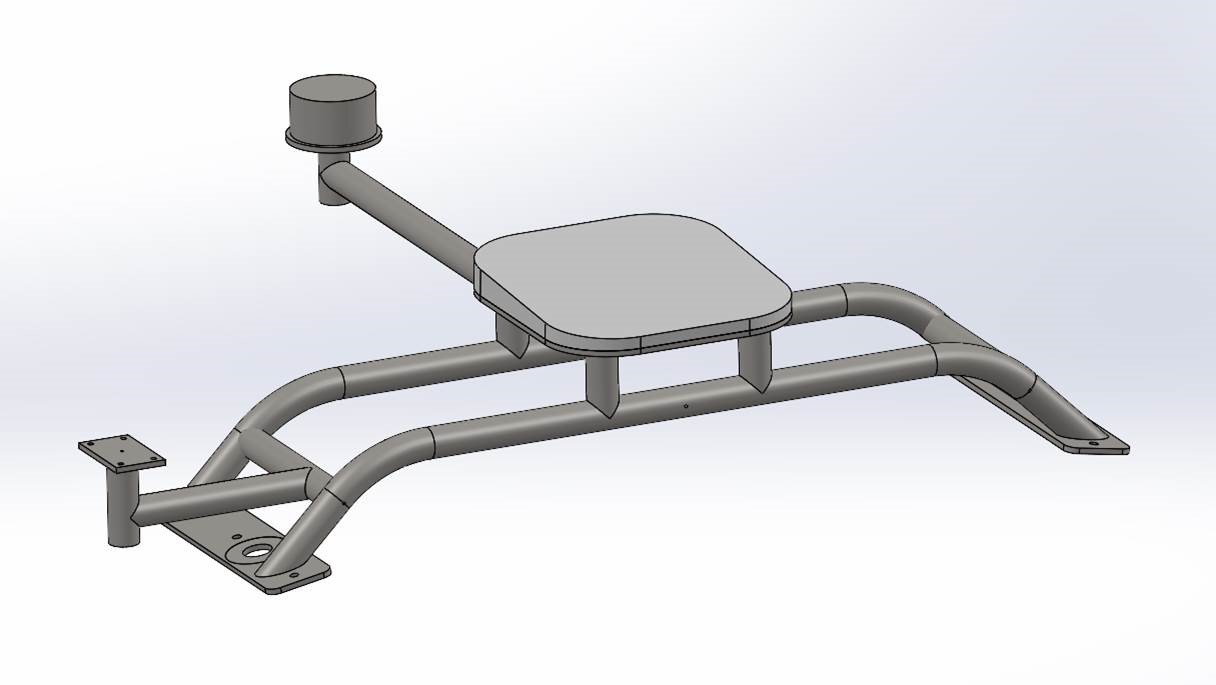

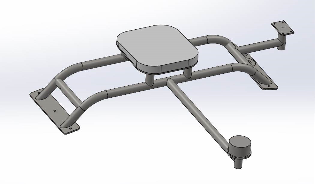

Here's the Radar/GPS/VHF mount that I've modeled in SolidWorks. It'll bolt to the aluminum tower using existing rectangular sections for this very thing. I have all of the material on hand and just need to cut, fit and weld everything.

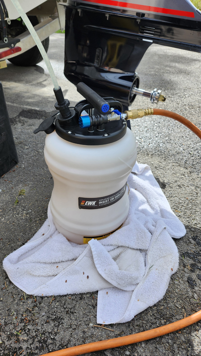

I got the new outboard installed on the jack plate today, but due to the weather I didn't do much else. I put the EWK vacuum extractor to good use and started the process of emptying the 70 gallon fuel tank. I don't know how much is in there, maybe 25 gallons or so, but I want to start out with fresh, ethanol free gas so figured I'd use the gas from the boat in my Jeep.
