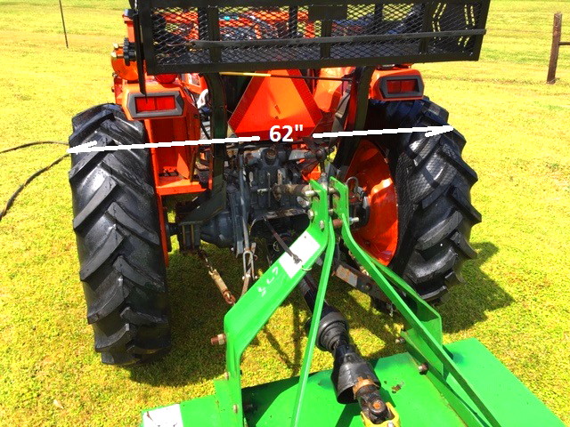

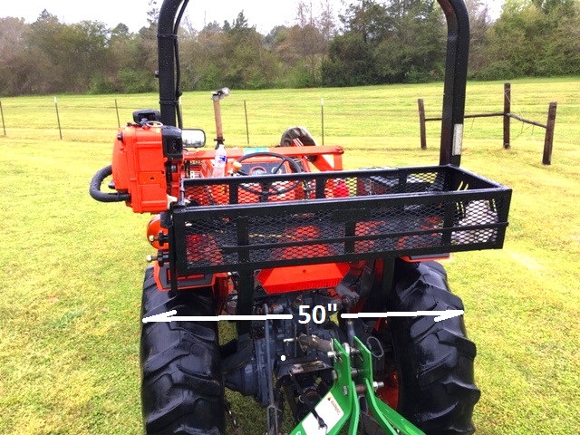

Actually I have ag tires on my tractor so if I just want the valve stems on the outside all I will need to do is swap them, side for side. I do want a wider track so I will be changing their position on the rims. Widening the track will make me feel safer on the land I have to travel/work. That and loading the tires with fluid.
My rims have tabs that actually allow for 3-4 different width changes. The largest (by just swapping sides) giving me 12" of extra width. Stability greatly increased.
