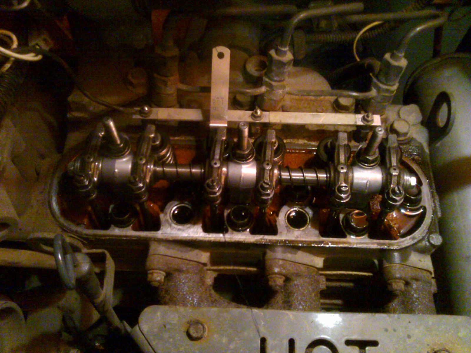

Well, I did the valve adjustment according to specifications above. The tractor runs a lot better.
It was, for the most part, very easy to do. :cool:

1 - IN - 0.004" <--- Worst
1 - EX - 0.005"
2 - IN - 0.006"
2 - EX - 0.007"
3 - IN - 0.005"
3 - EX - 0.007"
I adjusted them to 0.006" across the board. Right in the middle of Kubota's specs.

Yeah, roughly in the 800-1000 hour range is a good time to check. I think at 950 hours, it was the best time to check.
It does run noticable smoother, and it seems to produce a tad less smoke at start up.
