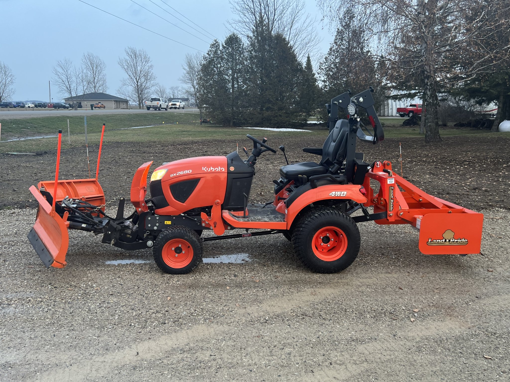

Bx2680 with many unnecessary options I just needed to have
Mar 5, 2023
9
Ontario Canada

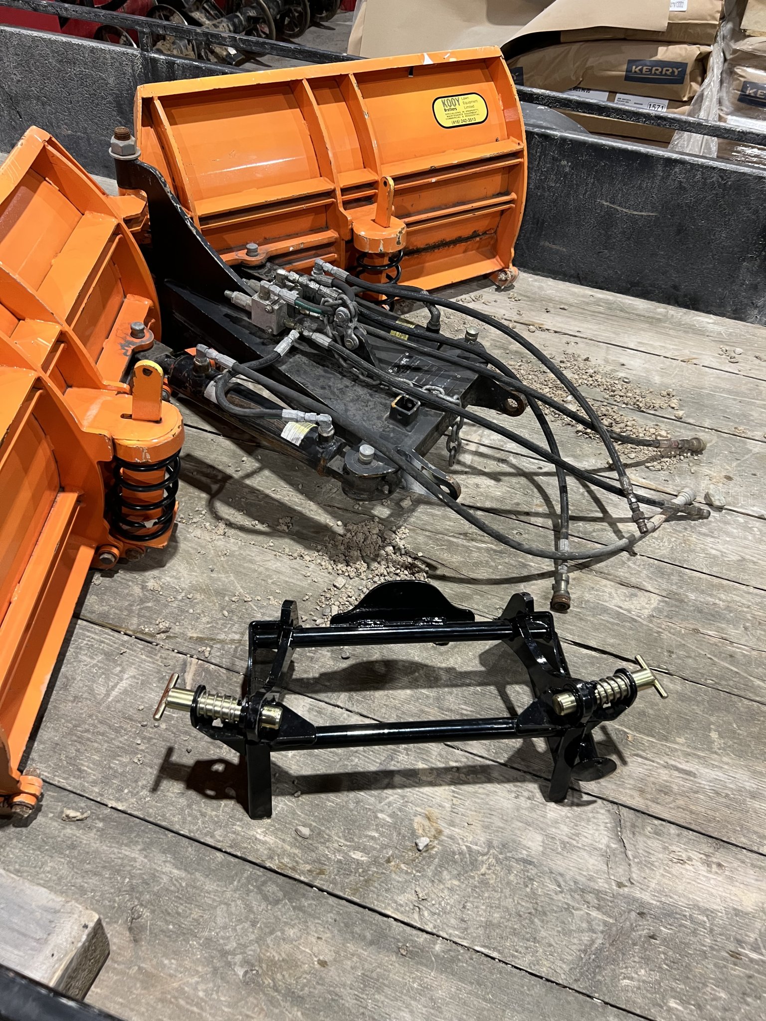

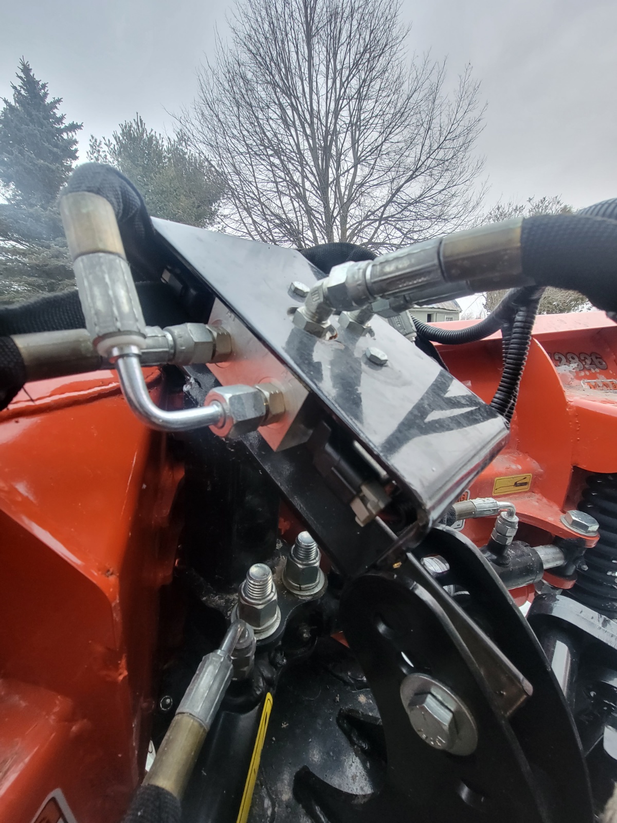

I have the front mount 48” commercial blower and wanted a blade to connect to k connect for when it only snows an inch or few. I originally seen the bx2826 plow and wanted to get one but when I seen the price I decided to build myself one with a skidsteer 72” v plow (60” V) I bought the k connect bracket and welded up my own mounts to connect the two and bought a third function valve and wires it to my loader function control button The project cost me $120 more than what it would have cost me to get the straight blade from kubota
