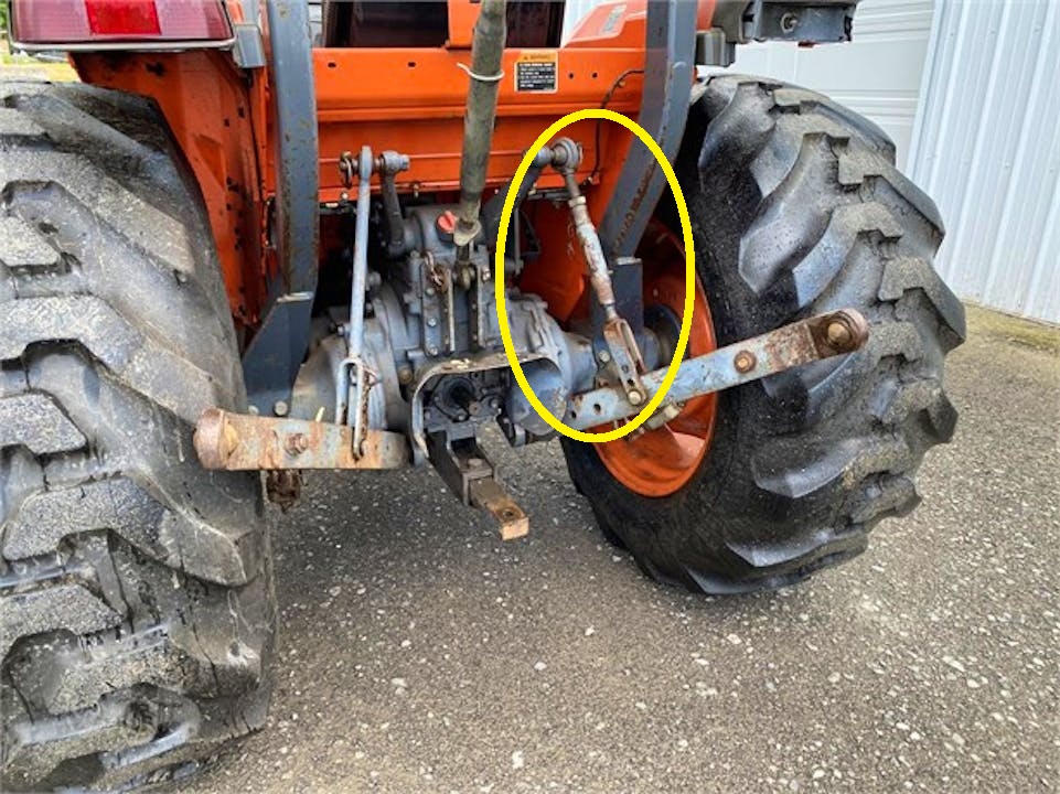

You would be much better off just tilting the blade., that's the way they are designed to work.
Just adjust the side link to do that.

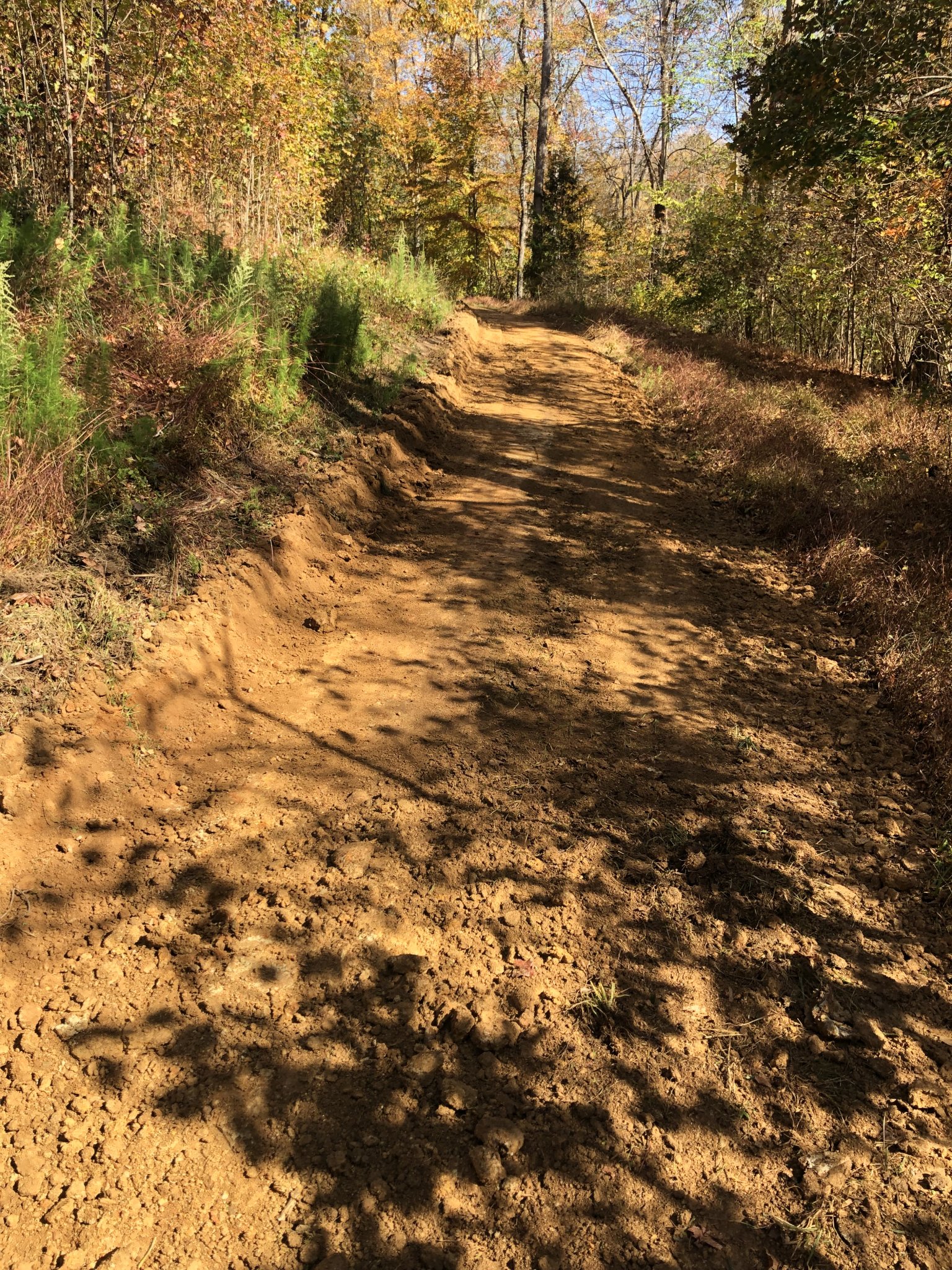

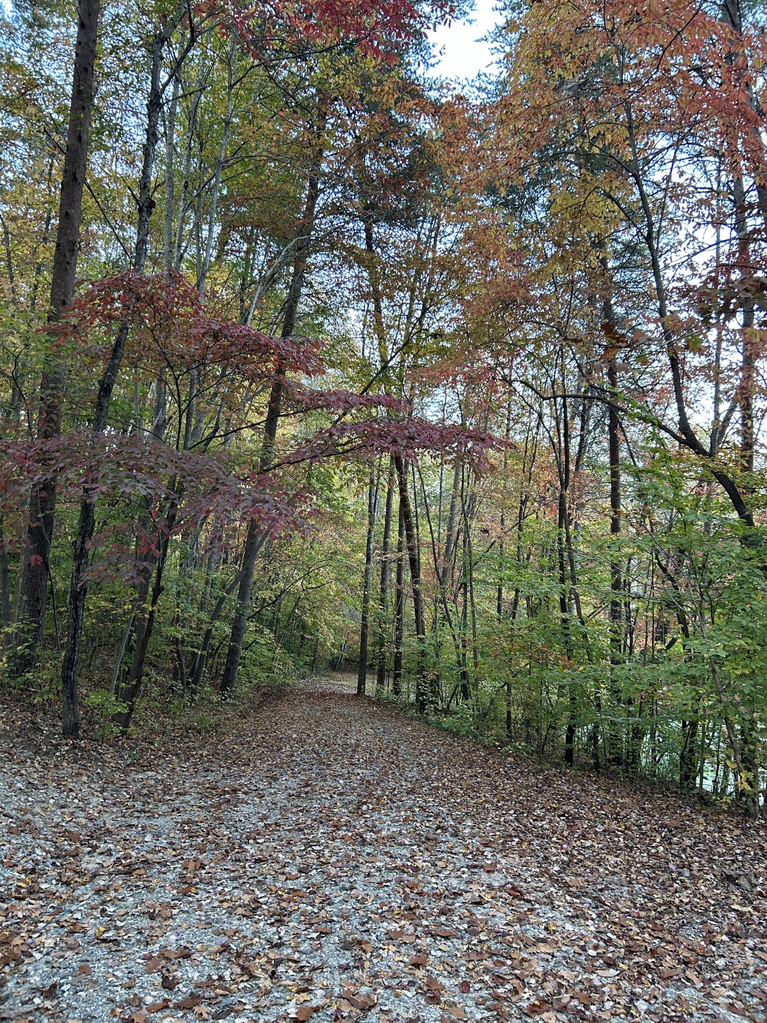

Maybe I’m not understanding exactly what OP is trying to do. I know if you’re trying to cut a road into the side of a hill such that the road is nearly flat with just enough slope to drain, you’re going to be pulling on one side of the blade until you’re about done setting the grade. To be clear, I’m referring to something like this (two different places, same scenario):
The end of the blade that’s engaging the ground is on the uphill side, so if the blade catches and tries to spin the tractor, it’s spinning the front end uphill. Once you have enough of a cut into the bank, there’s a wall that’s not letting the tractor spin anywhere so long as the front end stays on the ground. That’s said, while there are some operations running a boxblade or backblade where 5 to 6 mph is appropriate, IME this isn’t one of them. At least not the part where you’re cutting into the slope, establishing the grade of the road.
I don’t quite understand why it would be an advantage to drop the rippers on only one side. Set them all, tilt the blade appropriately using the adjustable side link, and whatever rippers you “need” will be in the ground. As the grade of the road changes with each pass, you’ll need to keep adjusting the side link to keep the blade level (or on whatever grade you’re aiming to end up with).
If you can’t tilt whatever blade you have using either the 3 point or some sort of tilt mechanism on the blade, you’re not going to be able to change the grade of a road.
As others have stated, regardless whether you disturb compacted material or add material or some combination of both, you’ll need to compact it when you’re done. Regardless how pretty it is when you’re done, if you don’t compact it, it will keep washing.
