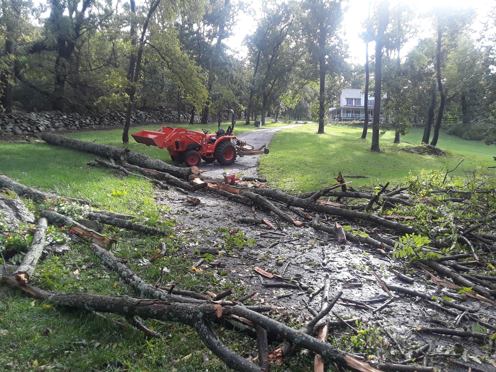

My situation is nearly identical to yours right down to the emerald ash borer invasion. Short answer - get the larger tractor.
Now the long answer. After decades with a B7200, a couple of old Ford 8/9N's, and two lawn tractors I purchased a L3901 and the improvement is monumental. I briefly considered an LX model but I am now glad I went with the L.
  • The only thing of significance the LX offers over the L is a cab and mid PTO which come at the cost of a lot less grunt. A good size ash log in the grapple on the L3901 is a mouth full. If anything I would want something even larger not smaller and I sometimes think I should have opted for the L4901. If money were not an object and doing it over I would skip the fancy but expensive Grand L's and a bare bones MX would be a serious consideration.
  • After 18 months of operating the L3901 with ROPS its clear the cab would be a real clearance problem for me when working in and around the surviving trees.
  • I mow about 3 acres of "lawn" and a MMM mower would be nice but my 3pt finish mower and the two G series lawn tractors are more than satisfactory. I use the lawn tractors with grass catcher on the acre or so of "golf course manicured" area and the 72" 3pt finish mower on the general turf areas.
  • Likewise for the snow blower. I have 3000+ feet of steep road to keep clear but snowfalls are seldom more than 24". That was daunting with the little B and old Fords but the L easily knocks that out with the loader and a rear blade. I am working on a front plow with power angle for this coming winter which should speed things up.
  • Lastly emissions. All of the naysayers here had me nervous but so far it has been a complete nothing burger. Read and understand the description in the Operator's Manual on the DPF and regens and how they operate. Then let the tractor do its thing without you getting in the way. I am approaching 200 hours and the regens simply happen on their own. Only once have I had a regen start when I was preparing to shutdown and I simply parked the tractor outside to the shop, set the throttle, and went away for ~10 minutes. When I came back it was done and I put it in the shop and shut it off.
