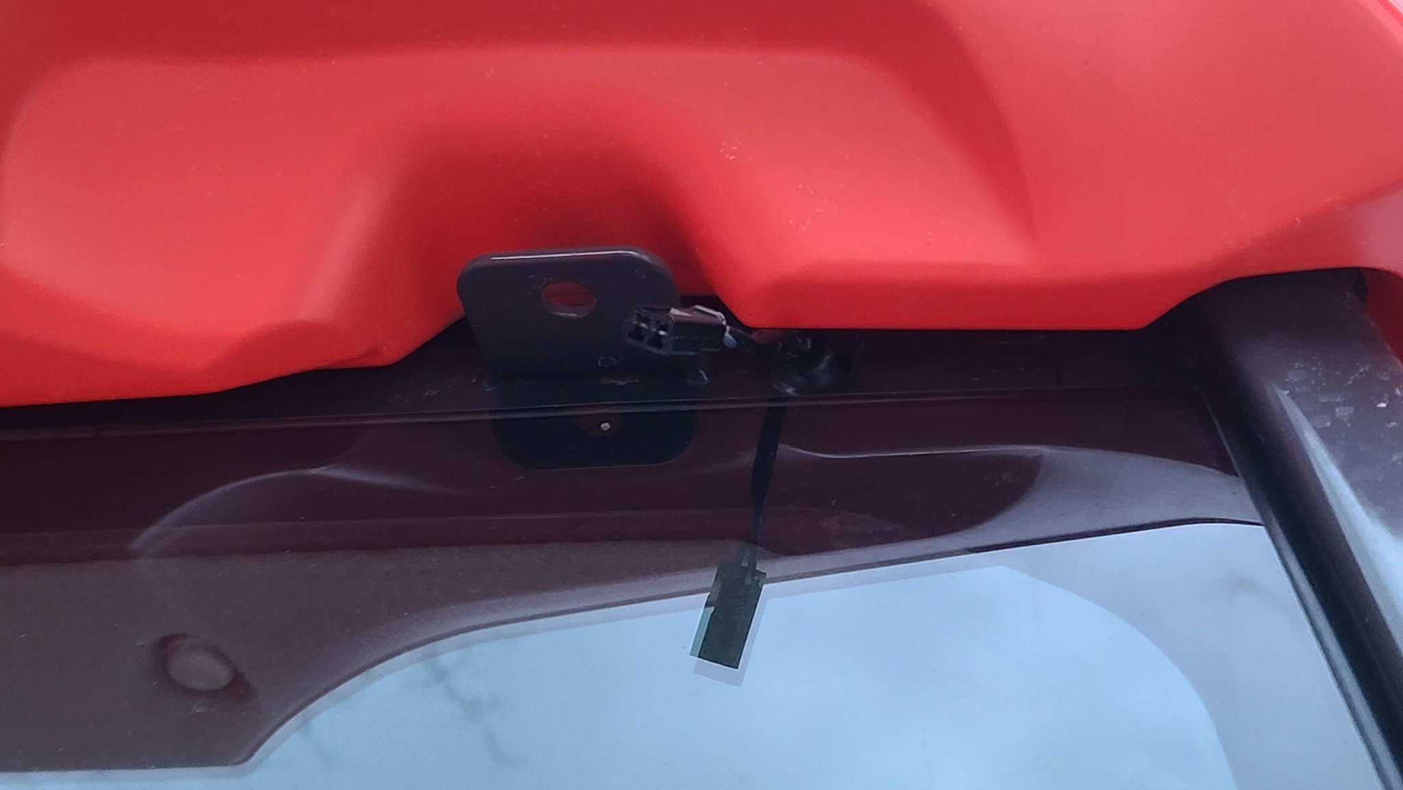

Next issue, I bought front work lights, Can't find the plugs from the factory. Do I have to take the fiberglass top off the outside to find them? Not sure how to do that.

Watch this video if you have to take off roof.
Thank you so MUCH !!!! the plugs i need were already through the grommet on that tractor in the video.
I was hoping I could just take out the interior screws and pop it up then get the plugs out. Just wanted to be sure. I attached the PDF I found online Hopefully its that easy.

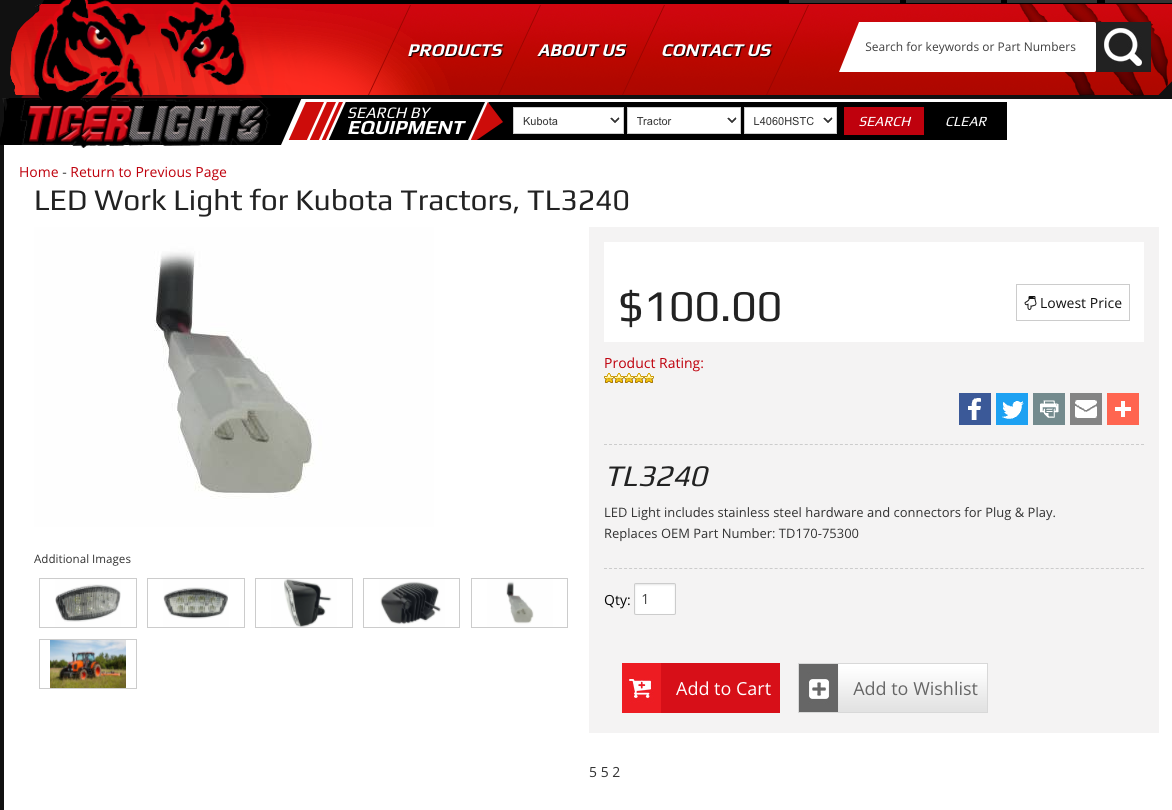

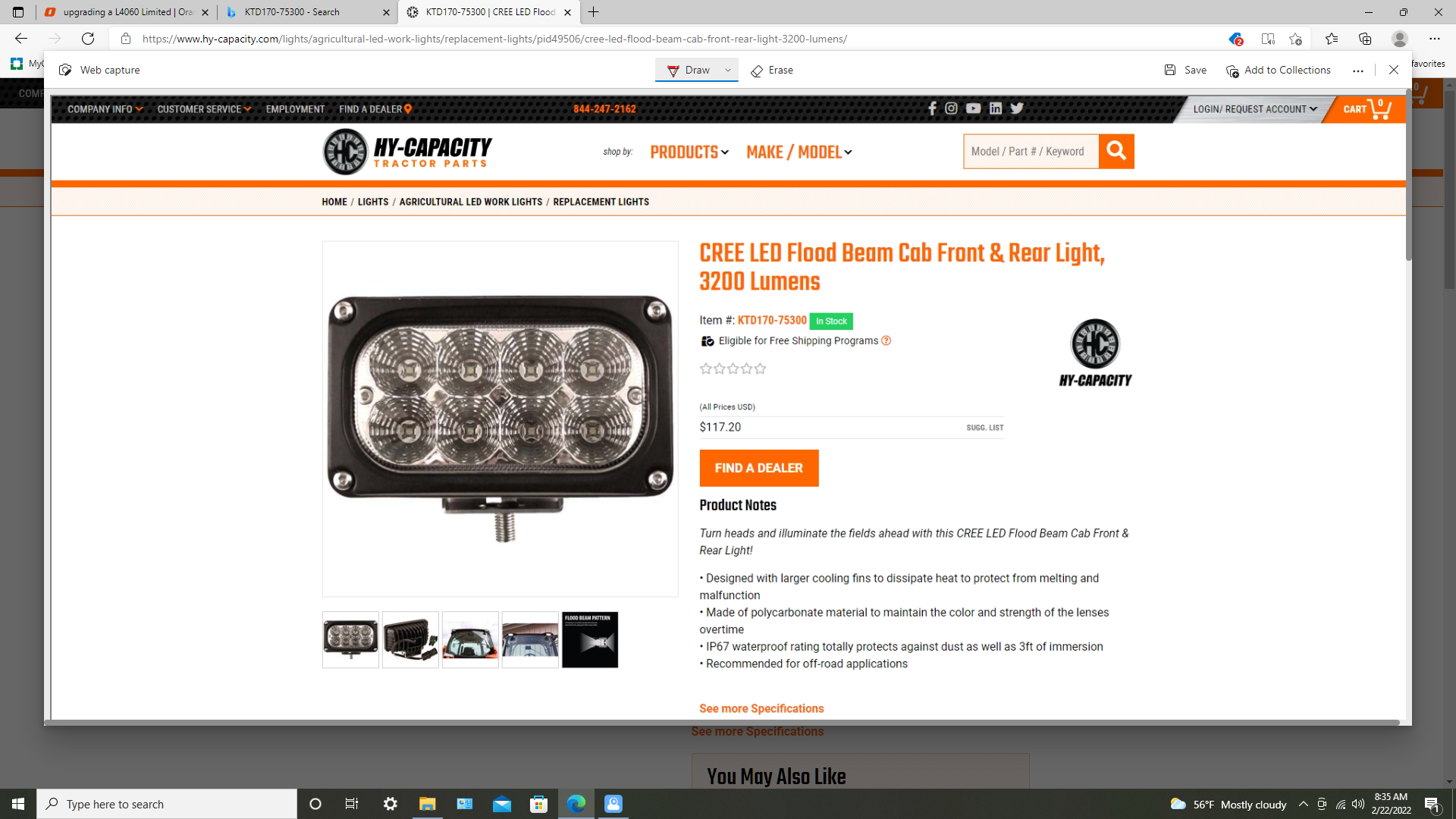

new issue, here is the plug i found. I just finished this removing the top. I bought Cree Led Lights, Plug & Play for L series online. Plugs not at all the same. Have to make a pigtail of some sort. I found the only wires with grommets under that roof. 2 others for the defog switches if added is all there were left. I did my stereo to. No issues there. Really disappointed about the Cree saying exact replacements as far as wiring. Just led upgrade.
Is this what your light plug looks like as well ? I looked as I said only saw these with the weatherproof grommets on them.

I think these LED work lights plug and play with the L4060HSTC I'm planning to replace my halogen with these soon.
Yeah, that looks like the correct plug. Cree had the same part number listed. I attached the pdf to my original post they even list our tractor model as compatible. KTD170-75300 I think I'm going to try to find or make a pigtail. Im sure I am not the first to be fooled. They included a plug you can wire but I am not cutting my Tractor harness. Searching Amazon and Ebay right now. I thought I was crazy though.
