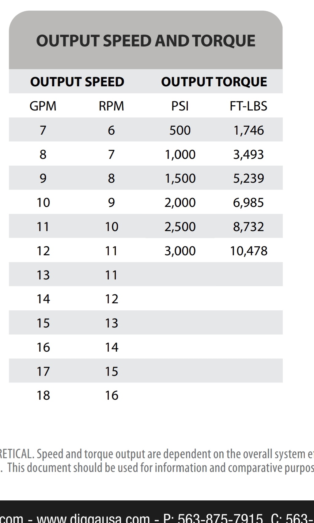

I am looking to run a drive motor on the FEL of my 2020 L2501 using a 3rd function valve kit from my power beyond port. The motor is specd for 7-18 GPM up to 3000 PSI. The hydraulic flow rate of my tractor as I understand it is 5.15 GPM. Is there any way to upgrade the pump to get a little extra flow here? If I use shims to bump up the pressure, would that also bump the flow a little? The other option would be a PTO pack but trying to avoid that if possible. Thanks in advance for the help!

It would be a drive motor for screwpiles. So a low rpm high torque auger type motor. I'm OK with the standard 2250psi that the machine is equipped at. It will generate the torque I need. Just looking to get a feel for what it would take to bump up the flow rate, if it can be. Thanks again. Here is the gpm to rpm of the motor chart. I have no issue with 6 RPM, this will be suitable for my use.

Unless you're driving those screw anchors into relatively rock-free, sandy soil, the substantial torque increase even going up 1-2GPM would be significant when dealing with clay and heavily compacted soils.

5.1GPM on a motor thats min is 7 GPM, you'll get about 100psi and 1 rpm out of it.
That is if it will turn at all.
Simply put, you will need a power pack to run it.

Thanks again to everyone that responded. After looking further the minimum flow is 2 GPM on this unit. I'll give it a try with the power beyond and 3rd function valve. Not looking to use this all day long.
Your tractor has a fixed displacement gear punp. Changing relief pressure has no effect on flow rate. Increasing pressure will increase motor torque.

I was referencing the screenshot OP posted showing motor input/output. My comment was meant to suggest that going up to a reasonable GPM from a power pack, larger machine, etc. would substantially help him drive the anchors in the ground.
