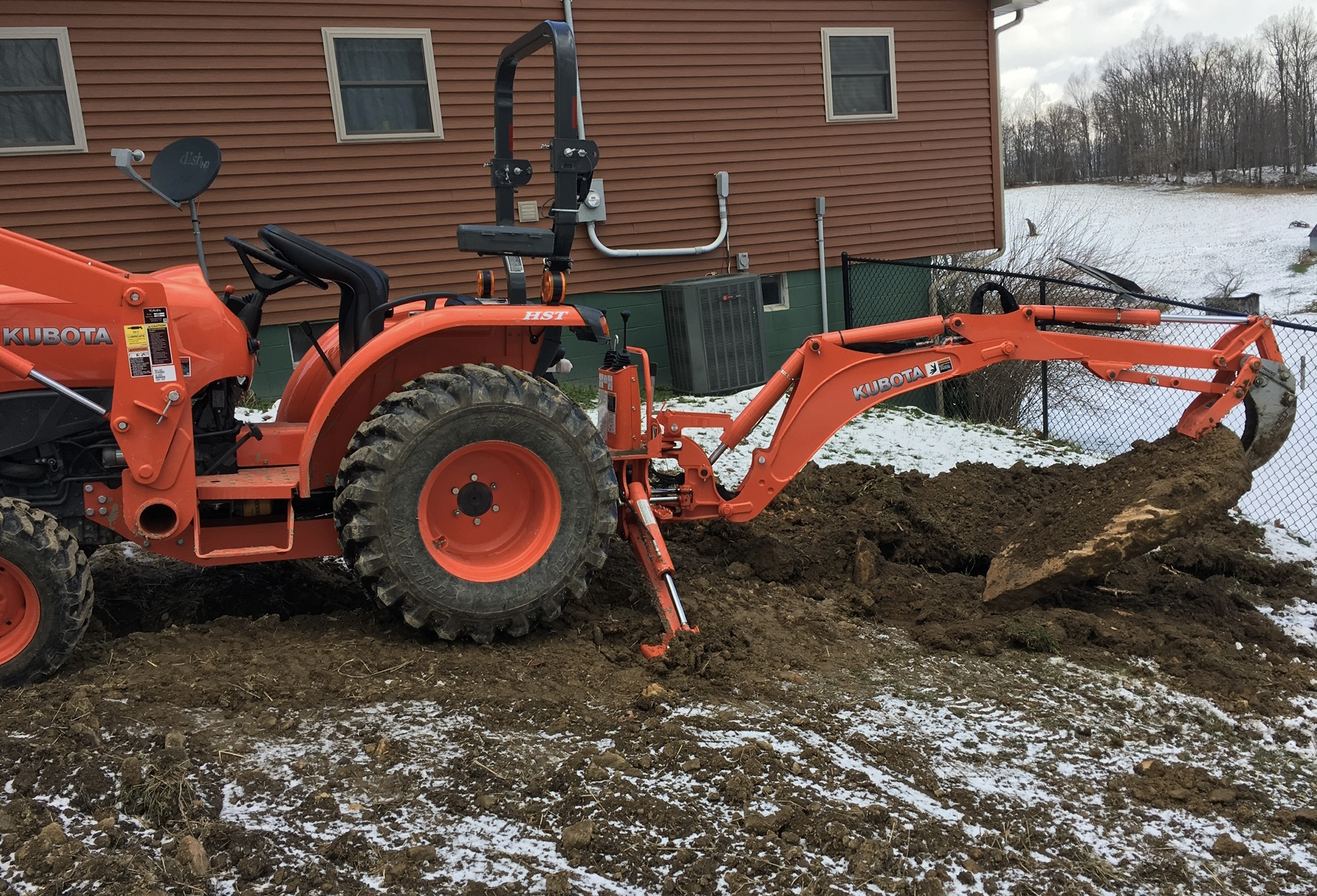

I have the same configuration but in a 3301 and it works flawlessly. There’s verbiage in the BH77 manual (p7 of the document/p17 of the pdf) that discusses how to prevent damage to the backhoe valve if these other options are also on the tractor.
I too have a 3301 with BH77 and the BH has been flawless and smooth. The power it has seems to match the size/weight of the tractor well. If I want I can pick rear tires off the ground with boom/dipper, and really jerk the machine around if I wanted to be rough with it.
Wouldn't want it any stronger or could risk a rookie doing some damage to the machine. I believe its sized properly in my case.
Any other implements attached?
In my use of the BH77, I typically have on my FEL bucket (instead of the grapple), so that negates use/need of the 3rd function valve.
And anytime the BH77 is going on, I’m taking off my 3-pt hardware and cylinders (which means I’m not using my 3-rear remotes—no hydraulic thumb), so nothing there either. And I will zip-tie down the 3-pt Lift Lever to the lowest position.
With my backhoe dolly, I can switch back and forth in under 30 minutes (and that includes warming up the line tractor) when going between using my 3-pt/rear remotes and the BH77.
