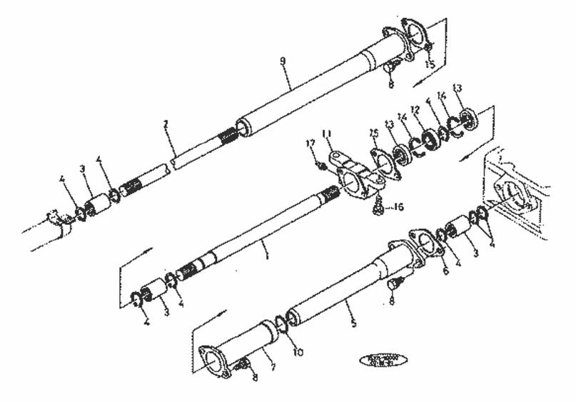

Regardless of model, a common cause of 4wd loss on these models is worn out coupling splines on the propeller shaft running forward below the engine. Its inside a telescoping tube which needs to be taken down for inspection.
In the diagram the couplings are Part 3. Part number is 37800-44520.
Lets hope that's all it is - beyond that it could be a failure in the front axle somewhere. Best luck, Dick B.

The picture is definitely a L355ss. The clue in the pic is the pto lever - the shuttle machines have a single-speed pto only L and N - without the 2nd speed H.
Regardless of model, a common cause of 4wd loss on these models is a worn out coupling splines on the propeller shaft running forward below the engine. Its inside a telescoping tube which needs to be taken down for inspection.

The front driveshaft coupler on my L35 stripped and was easy to replace--held by roller pin. But it made a rumble noise when engaged in 4 WD. Jack up front and make sure that's your problem before tearing into it. I found it easier to remove roller pin first and place in last as you will need the clearances to slide the coupler forward and aft for removal and reassembly. Good luck.

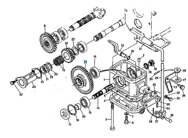

On these models there's a 48T gear ( 21 ) inside the bottom gear case that slides back and forth to engage the front drive. The propeller shaft couplings don't slide except for tiny clearance at the roll pins that position them. If water gets into the tube it can rust the little splines in the couplings. They then slowly wear away - especially on machines that stay in 4wd a lot. Oil seal seepage at the front differential or bottom gearbox can wet the prop shaft and help preserve the couplings.

On these models there's a 48T gear ( 21 ) inside the bottom gear case that slides back and forth to engage the front drive. The shaft couplings don't slide on the shaft except for tiny clearance at the roll pins that space them. Usually water gets into the tube and rusts the little splines. They then slowly wear away - especially on machines that stay in 4wd a lot. Oil seal seepage at either the differential or gearbox can preserve the coupling at that end.
Yep…as I said… I was confusing myself… rbargeron is correct…the front-axle drive-shaft couplings don’t slide in response to 4WD engagement or not.
The 4WD shaft/engagement is a entirely different shaft and coupling.
