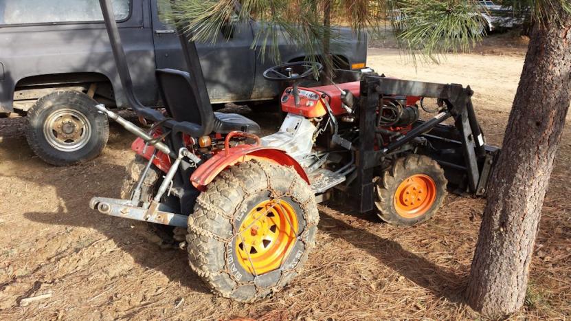

I use 33 x 12.50 15" studded (metal) truck tires on mine.
They give more traction then the cleated tractor tires that were on it.
They also are ballasted with 75lbs of calcium chloride.
Picture has it with chains on it also, it was waiting for the snow to fall.

Excuse the amateur questions but why the ballast is that to give extra weight to the rear?
What manufacturer did you get for the rear tyres?
What are you running on the front end?
Really appreciate your advise as it really helps.
33,389
8,702
They are just a set of off brand tires, Wildcats, any tire maker will do just keep the same size.
Yes the ballast/weight in the tires is for traction and most of all stability.
The front tires are the stock size tire, 6-12.
