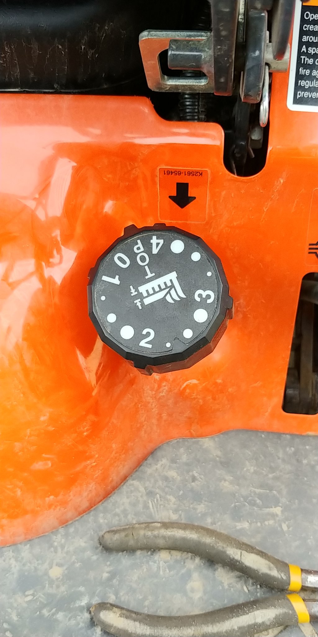

I am trying to attach my mmm 60 inch mower for the first time on my bx23s. A instruction video told me to set the deck adjustment to 0. I turned the dial in my picture and it stopped turning on 4. I have tried to free it up and it will not move so I am missing something. I do not have a mower manual but I looked in the tractor manual and came up blank.

Not a BX owner, but doesn’t the mmm lift work off the 3pt hitch? Is your 3 pt lowered enough to let the mower linkage down?
Start the engine and raise the lift arms. Then you can turn the depth adjuster to zero. It turns easier one way over the other. Stop the engine and lower the arms over your mower's attachment points.
