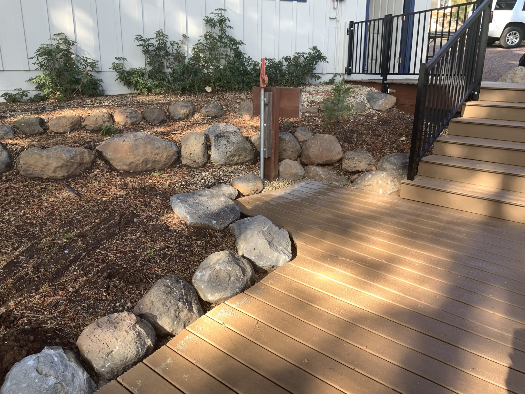

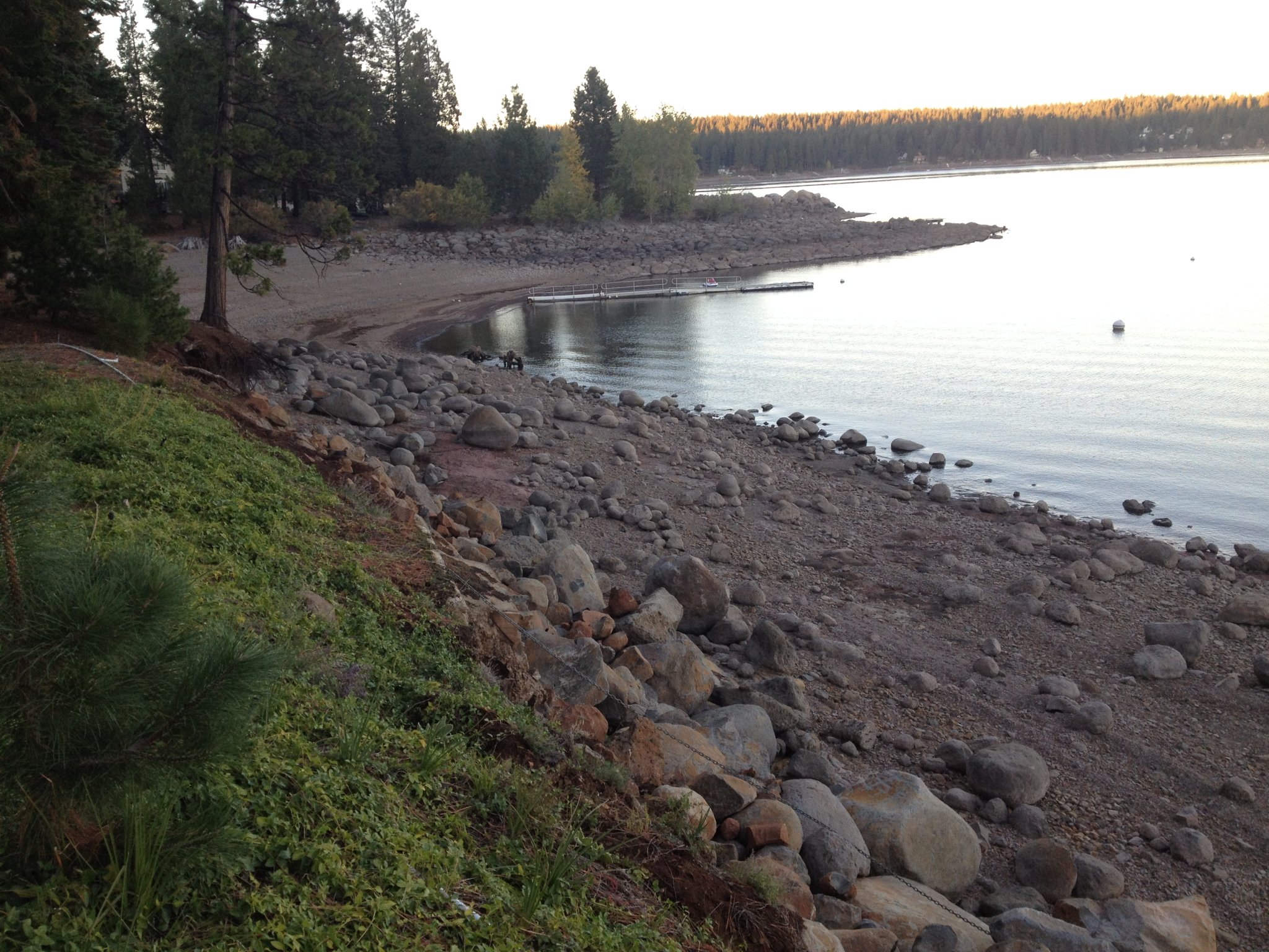

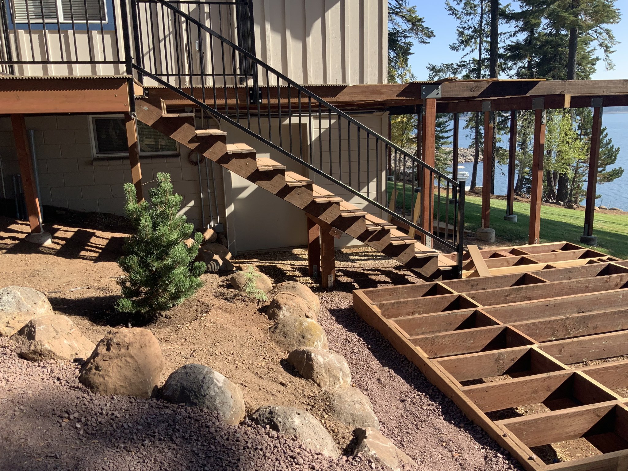

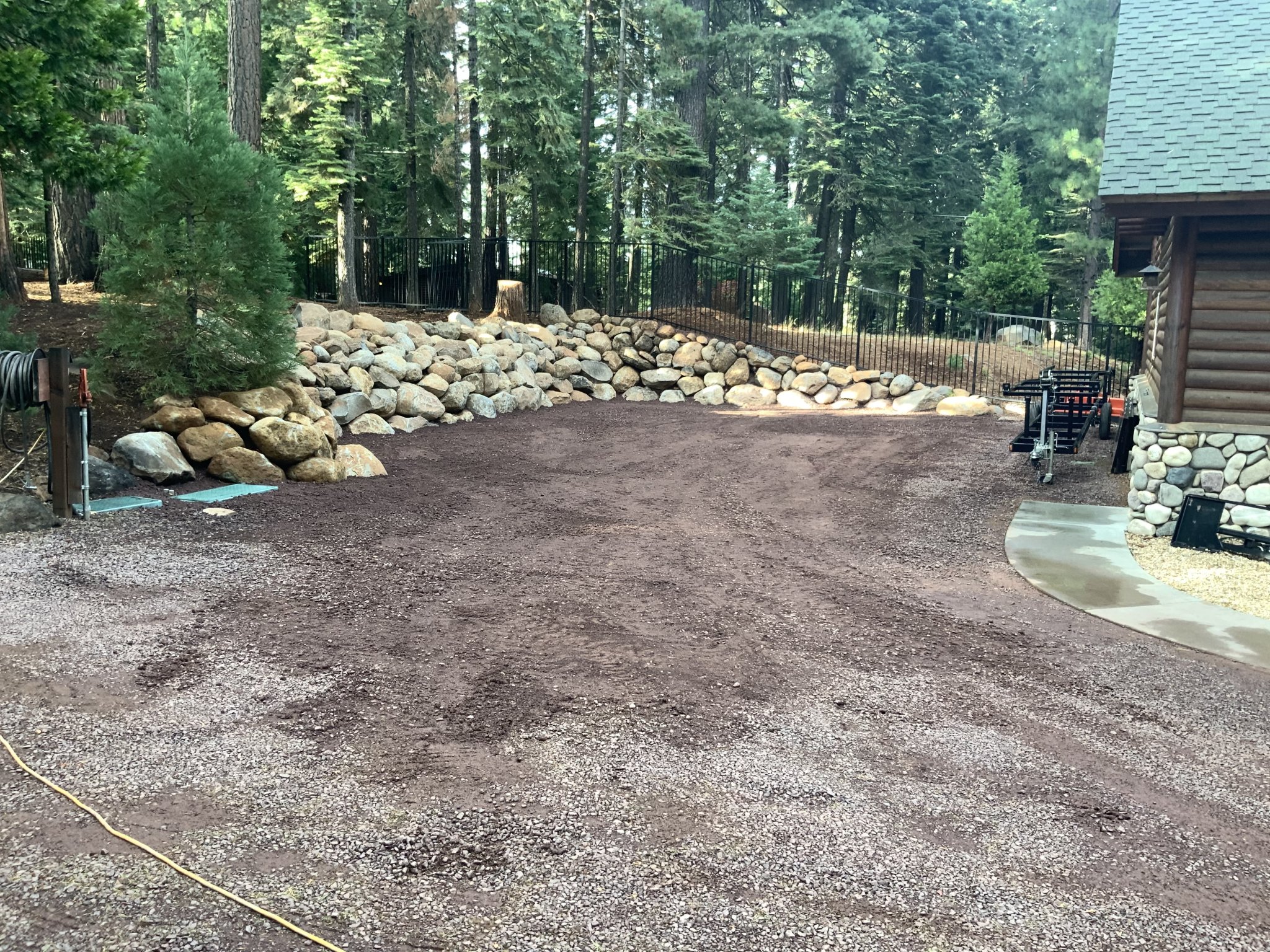

Welp, I have similar material and interlocked rocks from volcanic activity…with about the same set up as you OP. I put in about 3000’ of trench by just going slow and working my rig hard. The good news is that I have several large rock retaining walls! IMG_0515.jpeg IMG_1596.jpeg IMG_2892.jpeg IMG_3003.jpeg

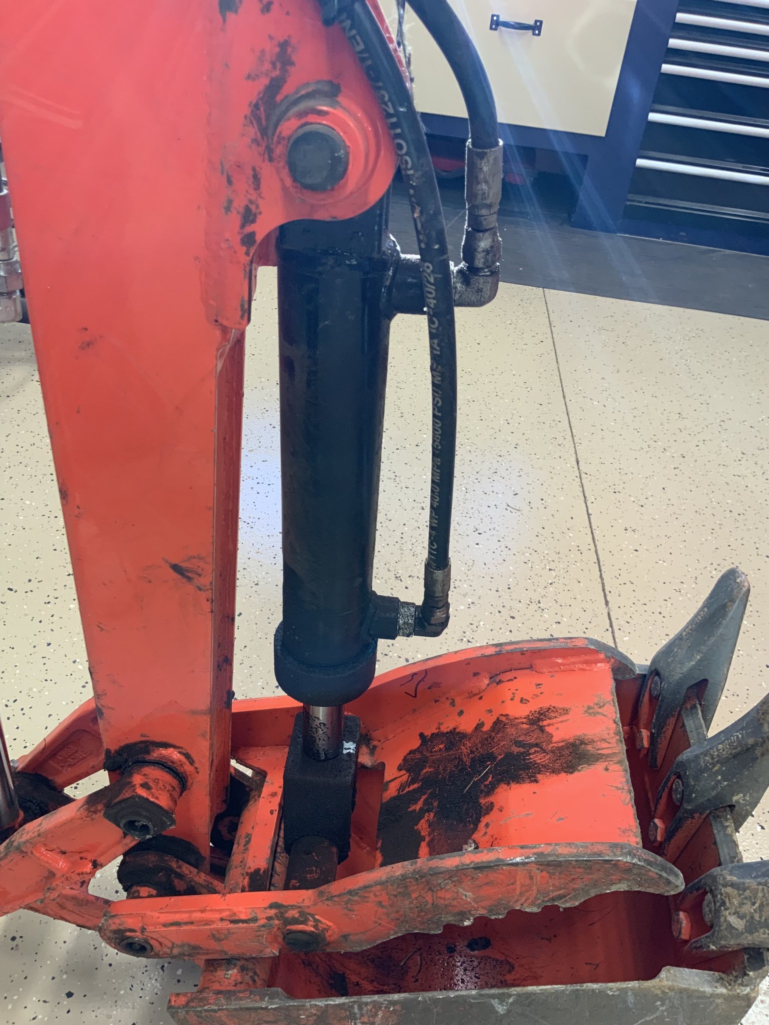

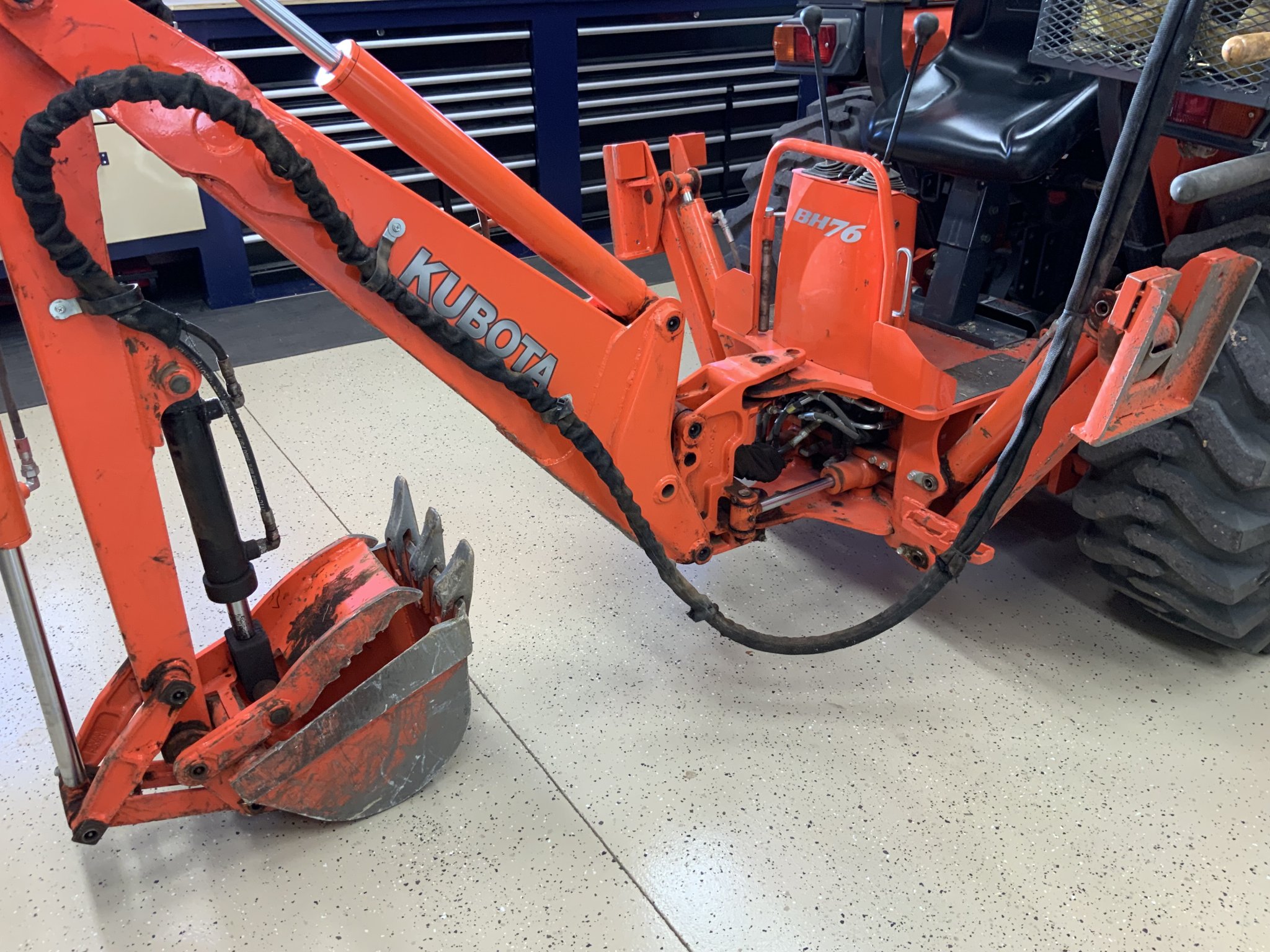

‘You wanna do something to your rig that will REALY help is add a hydraulic thumb. That thing is the most used and best implement for my situation…and likely yours too. Makes the trench work and stacking walls way easier. IMG_1417.jpeg IMG_2904.jpeg IMG_2908.jpeg
Thanks - I've had a mechanical thumb for years.
I've been doing some research on going hydraulic but not up to speed yet.

@Tarmy Love that hydraulic thumb!!!!(y)(y)
