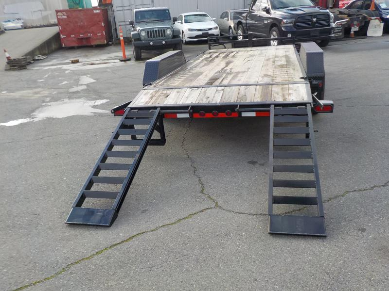

I have an L4701 that I have to trailer often and my trailer uses stow away ramps. The issue I’m running into with this new tractor Vs my old one is that when loading and unloading as soon as either the front or rear wheels first clear the ramps, the other end isn’t yet on the ramps and they kick off.
I’m putting jack stands under the trailer but this is only offering limited help if any.
Does anyone have any tips on how to prevent this?
thanks in advance.
9,895
4,053
a) drill holes in both trailer and ramps, place bolt to 'secure' the ramp to trailer
b) use straps to connect them to trailer ?
the ramps need to be secured to the trailer !
13,001
4,381
Redesign the ramps. As mentioned, have them connected to the back of the trailer and have "feet' welded on the bottom so when the ramps are put down the feet are on the ground. This is much safer. Keeps your truck rear end from coming up when the weight first gets on the trailer. It will help keep your truck under control and not roll off from under you.
Something similar to this. Design the feet so they are within 1" of the ground when on level surface, and build them heavier then pictured here.

I would just use a ratchet strap on each ramp to secure them while loading and unloading the tractor. The solutions offered above are better, but for the short term a strap would be fine. An L4701 is a significant tractor, so be aware of that. Posting a picture of your current trailer / ramp setup would help us offer better suggestions.

I like the feet idea, I have used straps in the past. I had a set of light aluminum ramps for my pickup that came with chains to secure them and they worked but were awkward and it isn't a solution I would suggest for trailer ramps unless you build in proper anchor points for the chains on the trailer.
Be extremely careful relying upon jack stands to balance/support a trailer while the load is being driven onto the trailer. A little unexpected shift is all it takes to send a jackstand flying which is bad news if you are depending on it.

Would like to see a pic of the trailer/ramps to be able to suggest the easiest way to fabricate a permanent solution.
I have the ramps as pictured here, on my 14K trailer.
I did not even consider slide in ramps, for precisely the reasons described above.
This design may be considered rudimentary/crude, but .....it IS the safest design!
I carry two short pieces of 2x10 to put under the feet/legs when on soft ground.

13,001
4,381
My trailer has similar feet on the ramps that hinge off the back of the trailer. They are made very heavy and load my 6K lb trencher without a problem. I have a 3" channel welded across the bottom of the short down legs. This keeps the feet from digging into any dirt and if there is a bit of clearance it doesn'tmake much difference if the trailer tail drops a bit. The butt of the truck is not going up!
