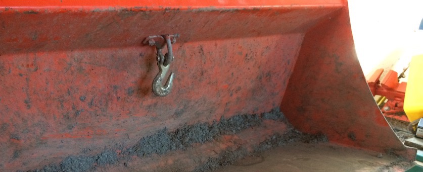

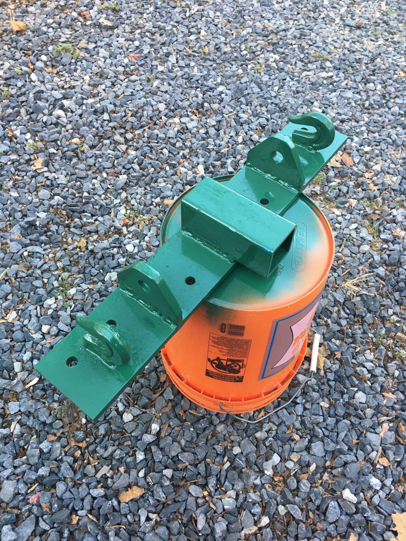

The support to the center hook keeps a heavier trailer from over-flexing the bucket bottom.
The ball is visible from the seat, which makes it much easier to use.
A conventional ball mount in the rise position could be used. I found the fabricated one I used at a yard sale.
It can be mounted or dismounted in 2-3 minutes.

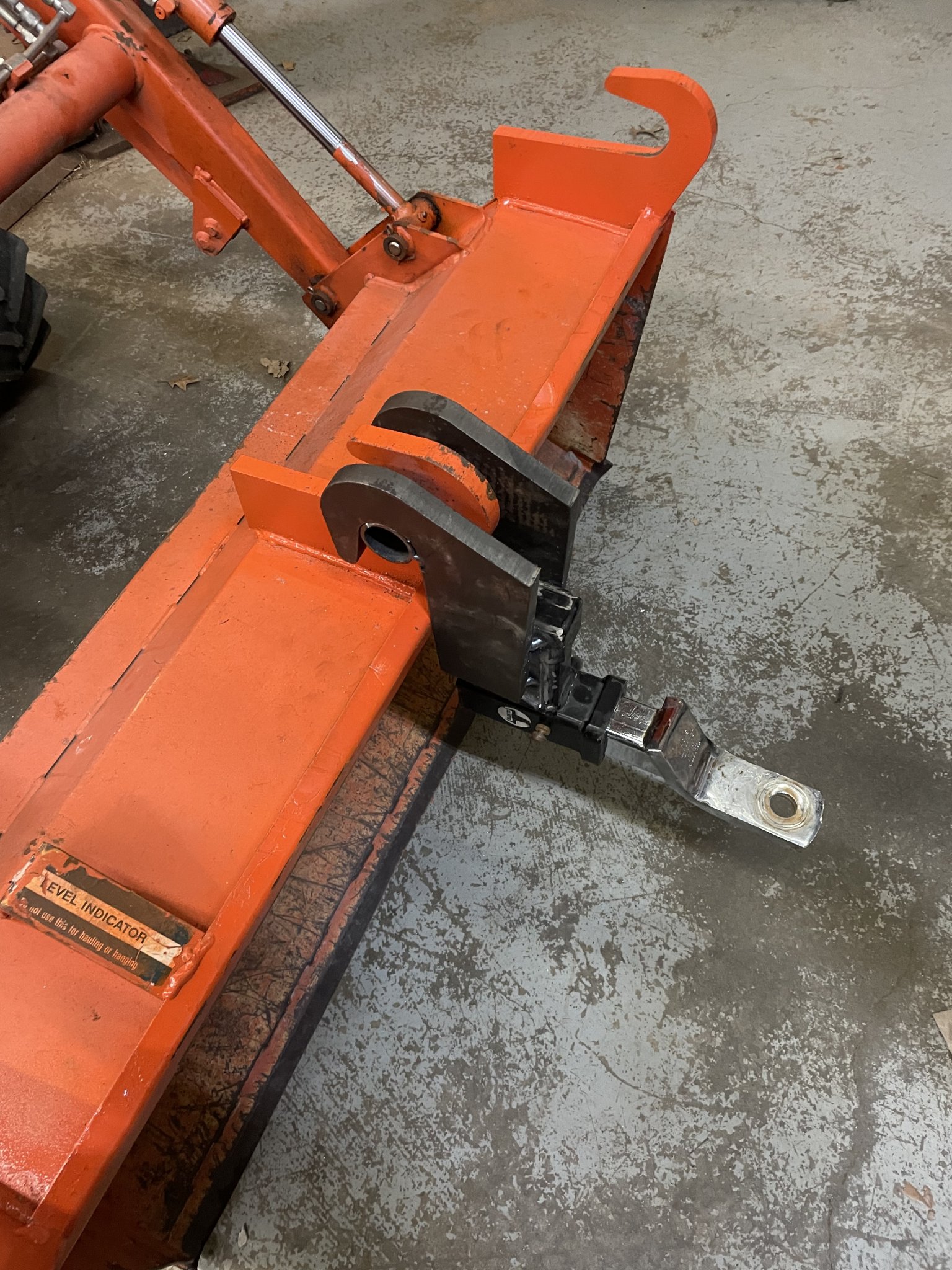

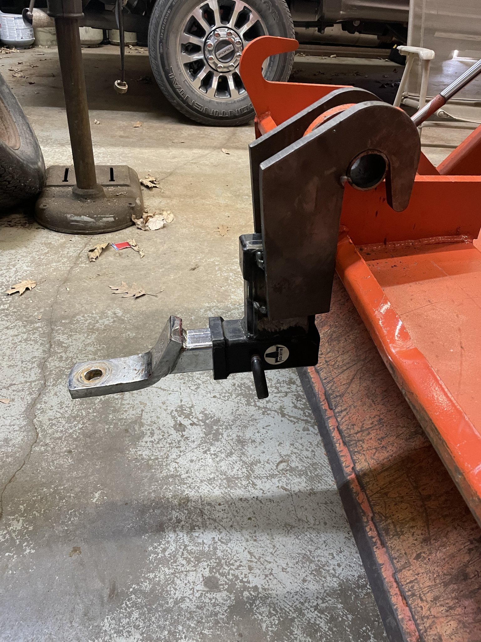

Has anyone out there ever mounted a trailer ball to your front end loader. Is there any idea’s going around. I would like to be able to move trailers around with my tractor.
I would like for it to be removable so it is not in the way. It would be nice to have different ball sizes.
Thank you any ideas.
This is what I came up with. I can remove it easily to use the bucket forks.
